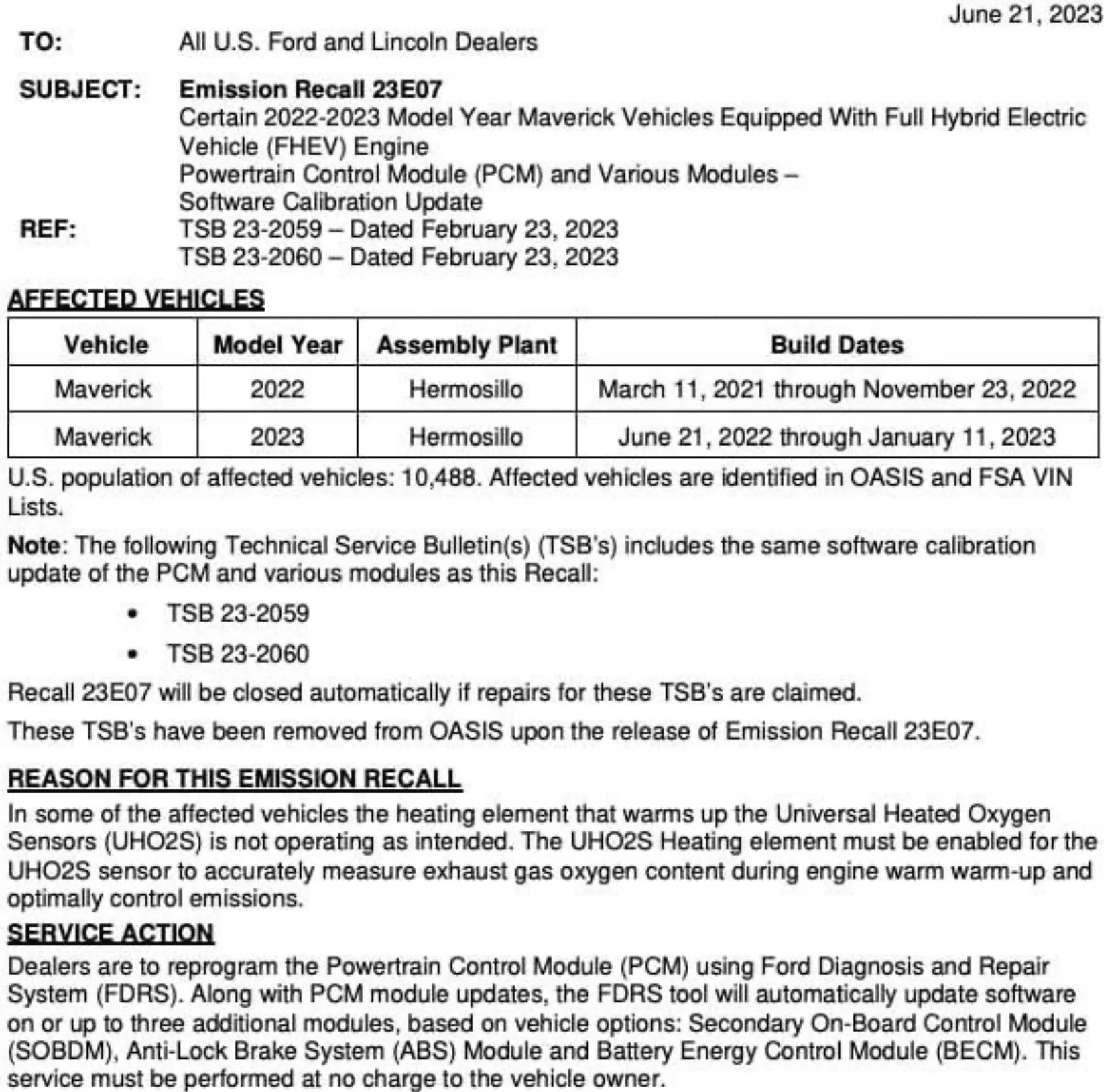

Apparently there is a recall now 23EO7 that replaces 232060.
23E07 does not replace any prior TSB. They are each unrelated issues. The reason why 23E07 is automatically closed out if either TSB has been claimed is that they all update the same software modules (ABS module, BECM, and SOBDM-C), but for 3 entirely different issues.
Emission recall 23E07 is just that - an emissions recall.
TSB 23-2059 addresses EGR issues (and has additional hardware troubleshooting as necessary)
TSB 23-2060 addresses the "grabby brakes" issues
See thread: https://www.mavericktruckclub.com/f...h02s-malfunction-fhev-engine-mavericks.33244/
If you didn't have those TSBs preformed than 23E07 will update both of those issues. According to my service department 23EO7 supersedes those others.

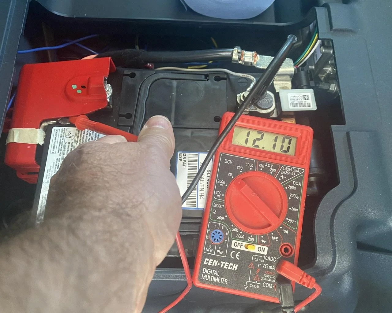

Ford Maverick Replacing 12v battery E0326AFF-C40C-4631-BE61-F73E978391C7
After driving it 1.5 to 2 hours a day on a less than 1 year old battery.
Cheap meter, but C'mon this can't be OK.

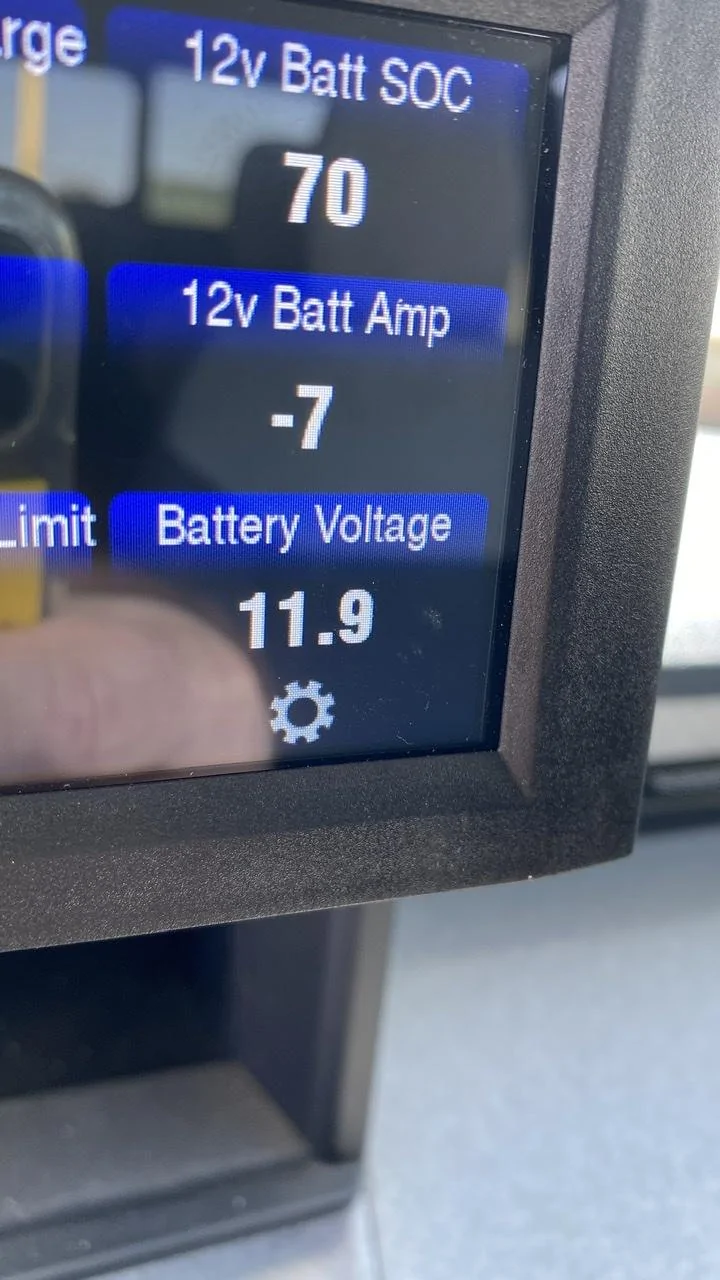

$250 "meter" shown below:
Ford Maverick Replacing 12v battery FA29353E-4D24-451D-9724-BC70A7047462
I also find voltage is lower after running through the dash and OBDII data cable.
I verified with the ScanGauge manufacturer, they are measuring the voltage directly at the device, not "reporting" digital data from the truck.
The 7 amp draw? Dome lights from door being open and whatever electronics were active at this time.

Loved it when Harbor Freight used to give the Cen-Tech multi-meters away for free ;-) Pretty sure I have had probably at least 20 of those over the years. Only had one that was truly "off" (by about .2V). All the rest were reasonably accurate and within about +/- .03V of each other. Only reason I ultimately dropped $100 on the Klein was I needed the additional features to track down some gremlins in my F350 (ended up being a fried ECM due to oil pressure sensor that shorted out).
For those that don't have the super fancy ODBII scanner that GPSMan has, I highly suggest the TopDon AB101 Battery tester. You can get them for about $30 on Amazon. Probably one of the most helpful auto tools I have and has paid for itself 10X over. I have saved neighbours and family hundreds of dollars by being able to check their batteries. In about 80% of the cases where someone said "I think I need a new battery" the State of Health was 75%+ and they just needed a charge (and figure out what was draining the battery). In other cases the battery was bad and checking it likely prevented a dead battery/tow situation.
Having the wiring harness CSP done soon, hopefully. Going to ask them to do 23EO7 as well.
Does this remove any changes I have made using Forscan, specifically adding Traffic Sign Recognition?
