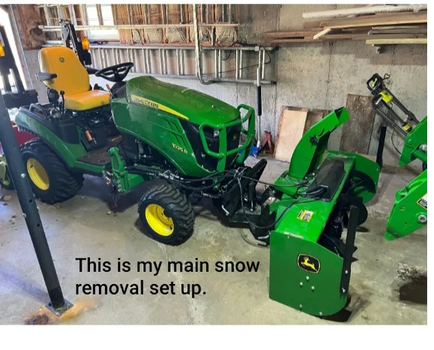

Because the Maverick is unibody it cannot accept a front mounted plow. I now use a front mounted John Deere snowblower. But living up north I have always had a back up plan in case problems arose with the tractor.
I still have a homeowners plow that I used on my last two pick ups so I decided to mount it to the receiver at the rear of the Maverick. It raises and lowers with a winch and an arm is used to swing the blade left or right. Most homeowner Plows are less than 300 pounds, well within the 400 pound tongue weight rating for my all-wheel-drive hybrid. I wouldn’t want to rely on it for all my snow clearing but as a backup, I think it will work just fine for me.
As a bonus, the plow height is low enough so that it doesn’t interfere with the rear camera or backup lights, which will be helpful for night snow clearing.I upgraded the winch with an $80 2500 pound winch from Harbor freight that included a wireless remote.
I have a small toolbox that I use for the various items that came with the winch. I also have a lawn and garden battery in the toolbox that I use to operate the winch.
I didn’t want to fool around with making connections to the Mavericks battery so I will keep the winch battery on slow charge for the season. All I need to do is remove two wires from the winch and I can take my toolbox into the house when I am not using the plow.

Reposted from DM's with permission from "Fonz"
Thank you🤝
Glen - this is what I use for snow removal. It is a 1025R John Deere with a 54 inch snowblower. I bought it last season to replace a 23 hp Kioti with a 48 inch snowblower. The Kioti was purchased new but was problematic which is why I had the homeowners blade on my four-wheel-drive Colorado. The John Deere is extremely reliable and I don’t ever expect to use a rear blade on my Maverick but it will be there for emergencies. I hope this clears things up for everybody.

Bob,
Good luck with your John Deere main snow removal setup that you spoke about in your first post. That's a nice looking setup. Thank you for posting a picture of it.
