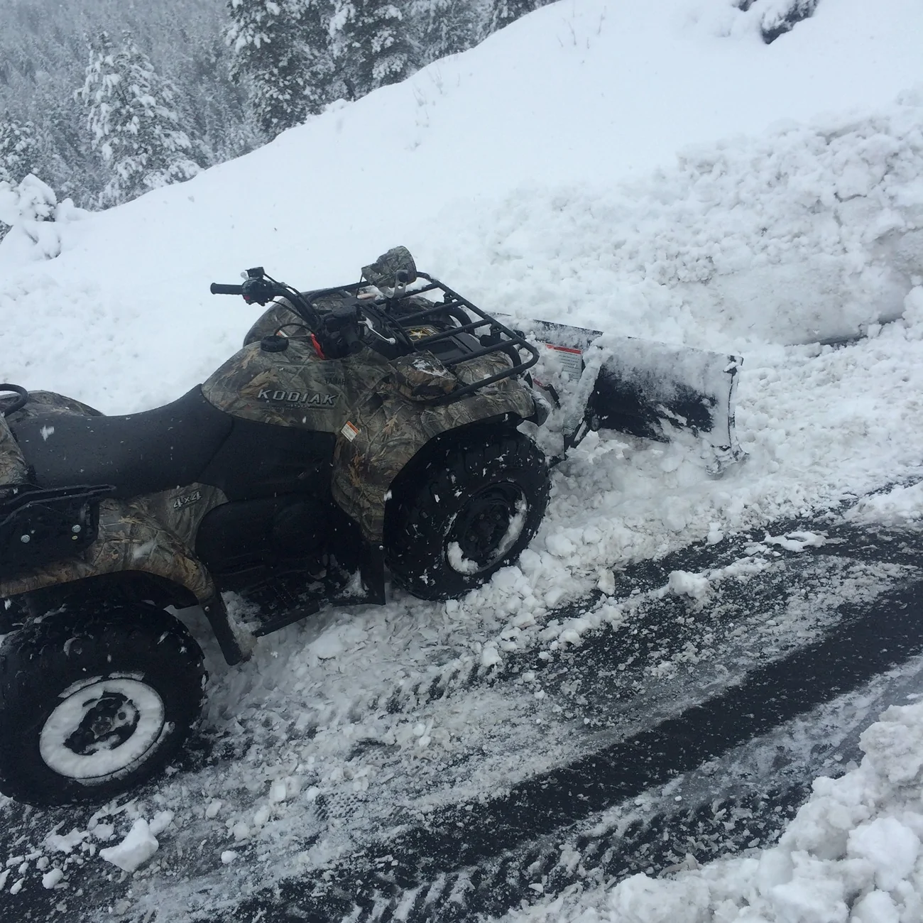

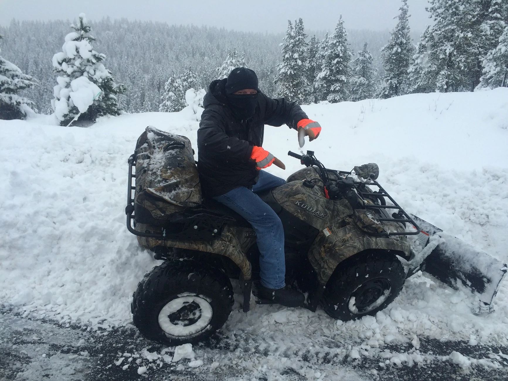

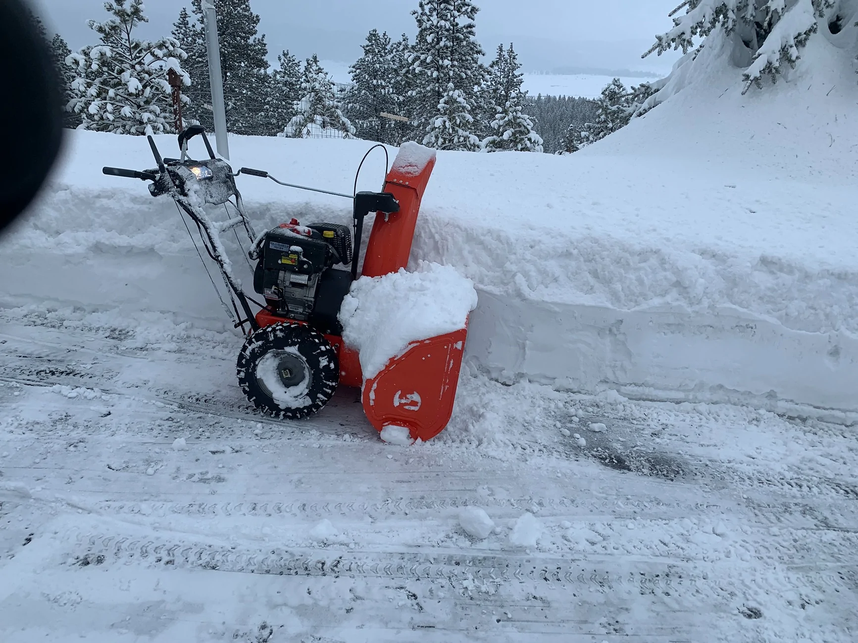

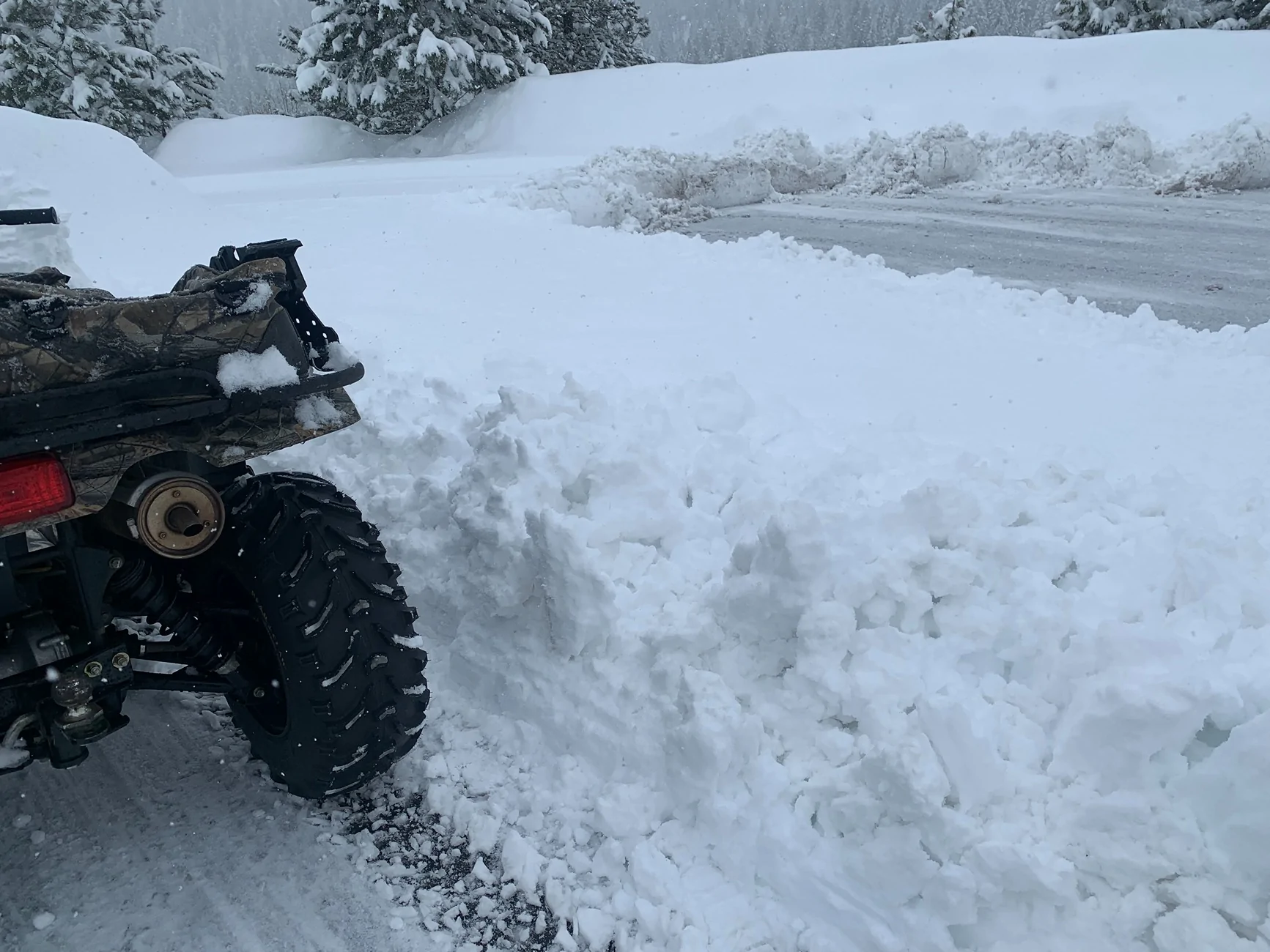

I agree with those saying just use as a backup and maybe pull the snow instead of pushing it. I also agree about using small ATV's for very big snow jobs. When I lived in western part of Idaho, we got snow all the time, sometimes feet at a time. Used a snowblower and my 450 CC Yamaha. Never bent or broke anything except a shear pin on the blade a couple times. Good luck out there!
