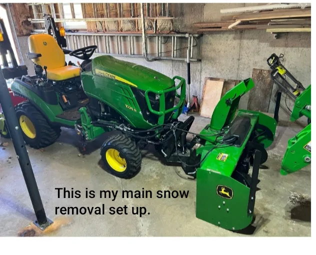

Because the Maverick is unibody it cannot accept a front mounted plow. I now use a front mounted John Deere snowblower.

I've read your post and highlighted what I consider to be the important parts. It seems a lot of commenters have missed the fact that you have a tractor with a John Deere snow thrower on it for full-time cleaning of your driveway and that this is just a backup. 🤷🏻‍♂️

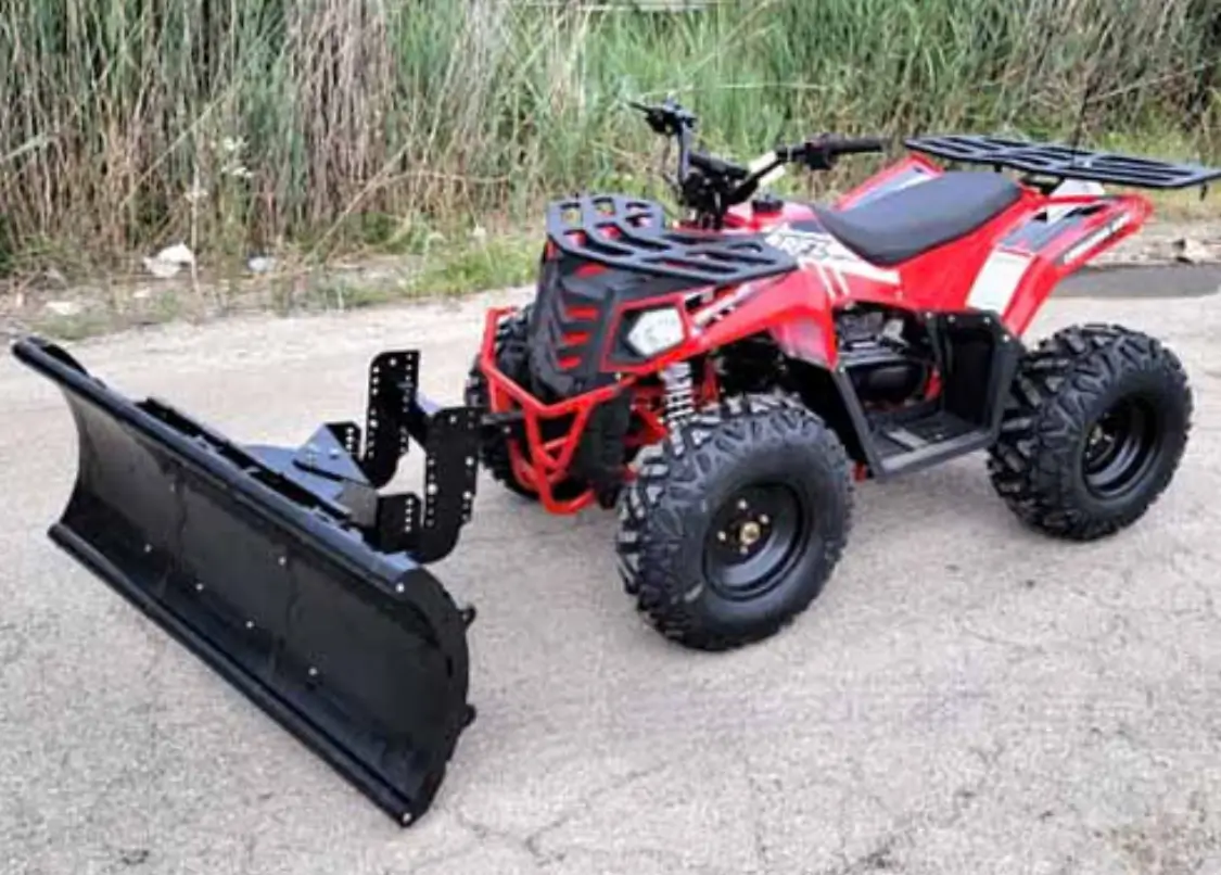

I would expect the weakest link to be the 2" hitch receiver. It will probably bend or break first, and the truck will stay usable after.
They put plows on light weight ATV's all the time.
200cc motor. ( That's 0.2 liter )
