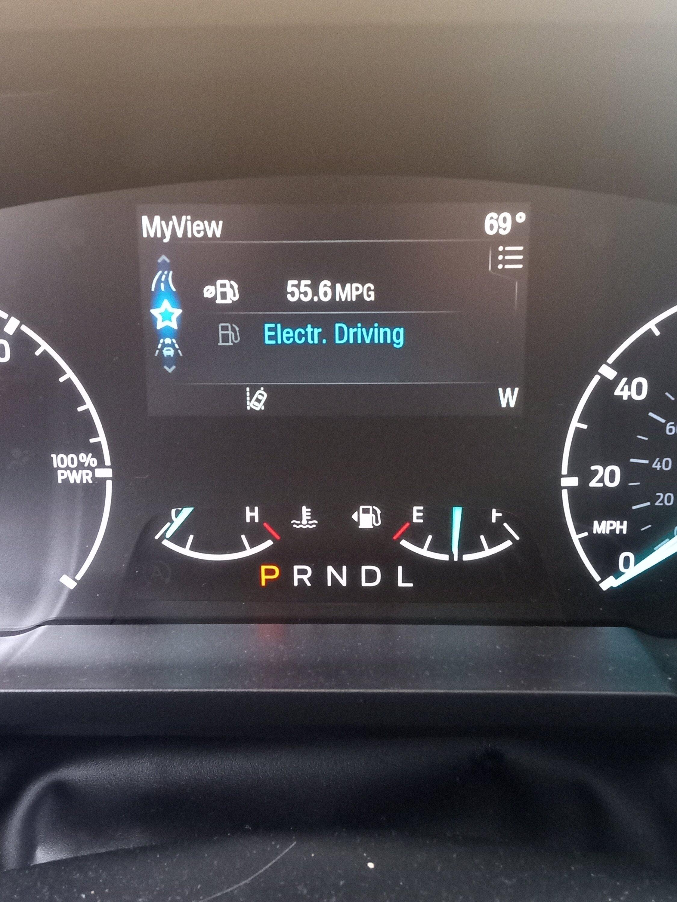

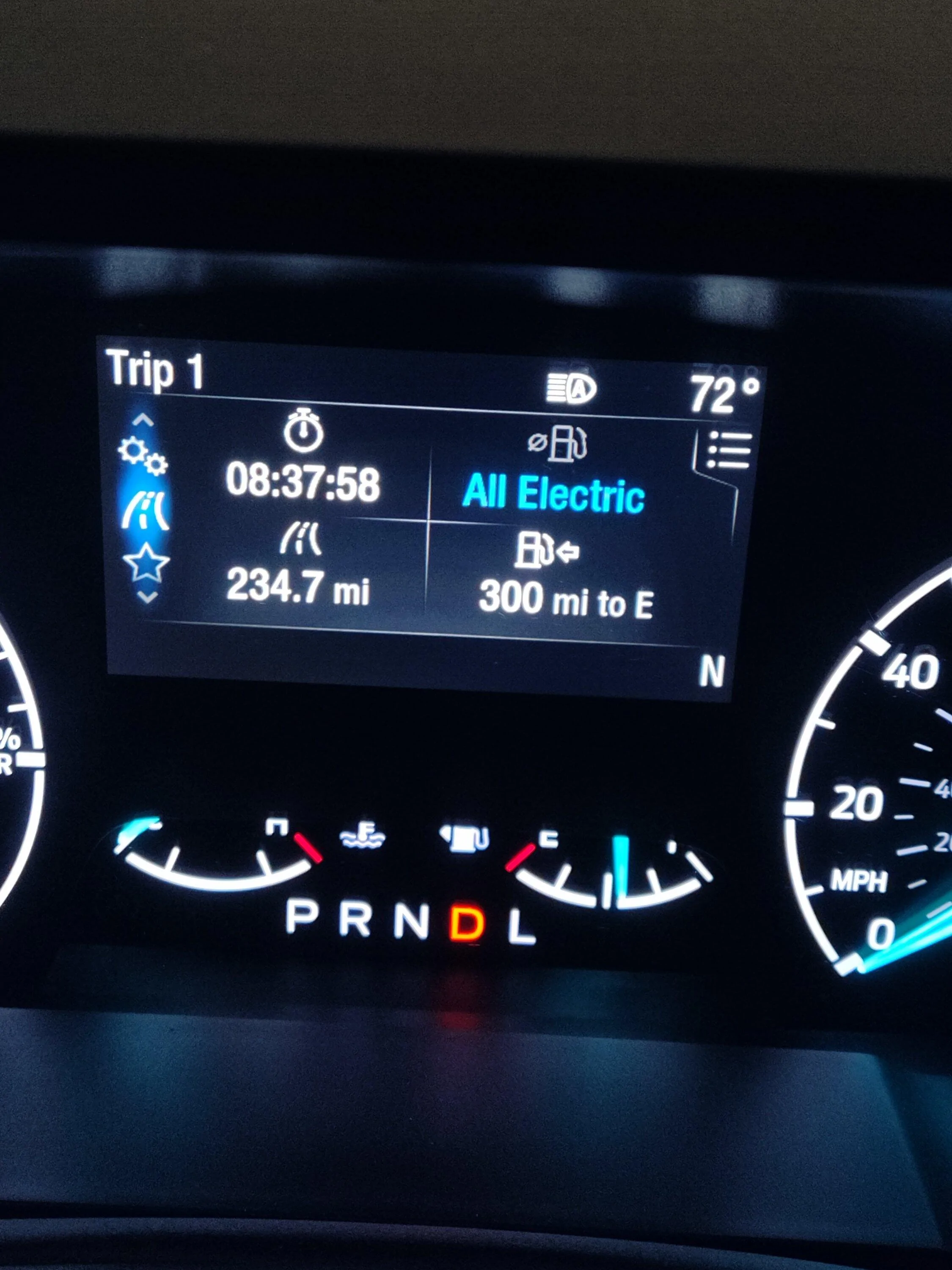

I took delivery of my hybrid XLT LUX three weeks ago and my Blue electric dash lights up when I start off and it goes off when ice starts and never relights until I turn off truck and start another trip. I assume a software tweak was done.
Uncle Ed
Nov 1, 2021
268
349
Georgia
1968 Camaro, 2017 Toyota Highlander, 2024 Maverick hybrid
Does the ice keep running when you stop for a traffic light or stop sign? Mine goes to electric at each stop and any down hill if I let up on accelerator , even level road if I keep the power meter below first mark.
The needle goes into the green and I will have about 28-30% electric miles but the only time I see the blue electric word on dash is when I first turn on to ready state and it stays there until ice comes on. It may be that ice is on at idle and battery is not warmed up enough. I probably am running in hybrid mode mostly as I quite often will show 3-12%(🤷?) with 20-23% acceleration Power usage and am getting around 42-45mpg per trip usually in slippery mode (which Regen brakes less and coasts further at speed). Down hill green vehicle is lighting up on the slightest downhill when foot is off go pedal. Oh! Forgot to mention only have 400 miles on truck so ???
Never see blue electric until reready of truck.

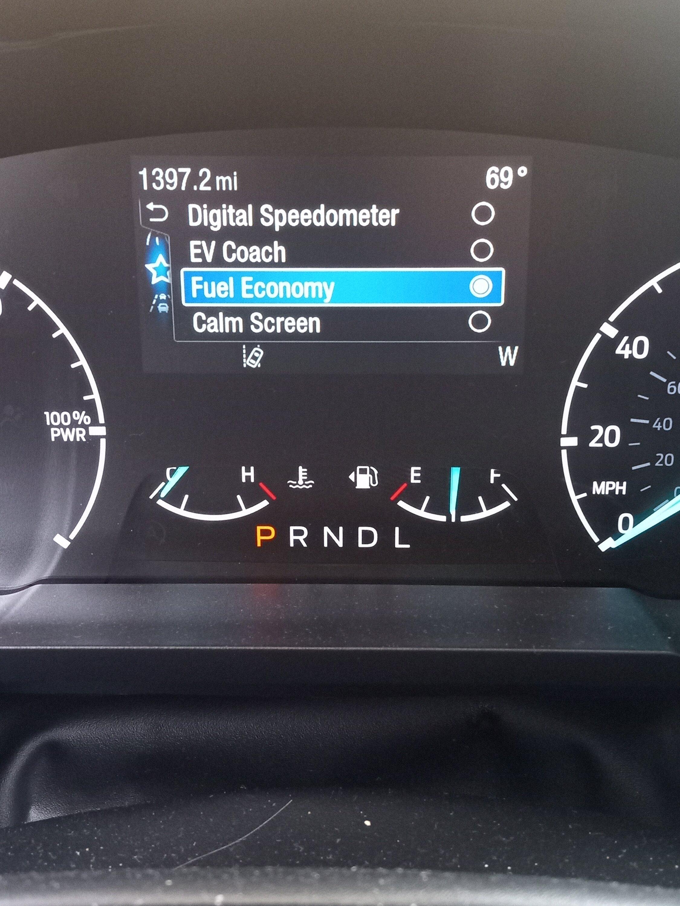

Scroll the screen using the steering up/down until you see ' my view' then hit the men
Scroll the information screen until you get to ' my view' push menu button and select
Scroll main screen until " My View " shows then press menu button and select " Fuel Economy" .then your my view screen will show Electric, And when ICE comes on it will have a bar graph showing instant Fuel Economy. (Mpg) . The little green truck is for down hill assist, part of CP 360.
Mine, may change, this I a lot different from wife's hybrid lariat first edition. This one is still on dealers gas. Also I haven't checked the voltage at the dash power point yet.
