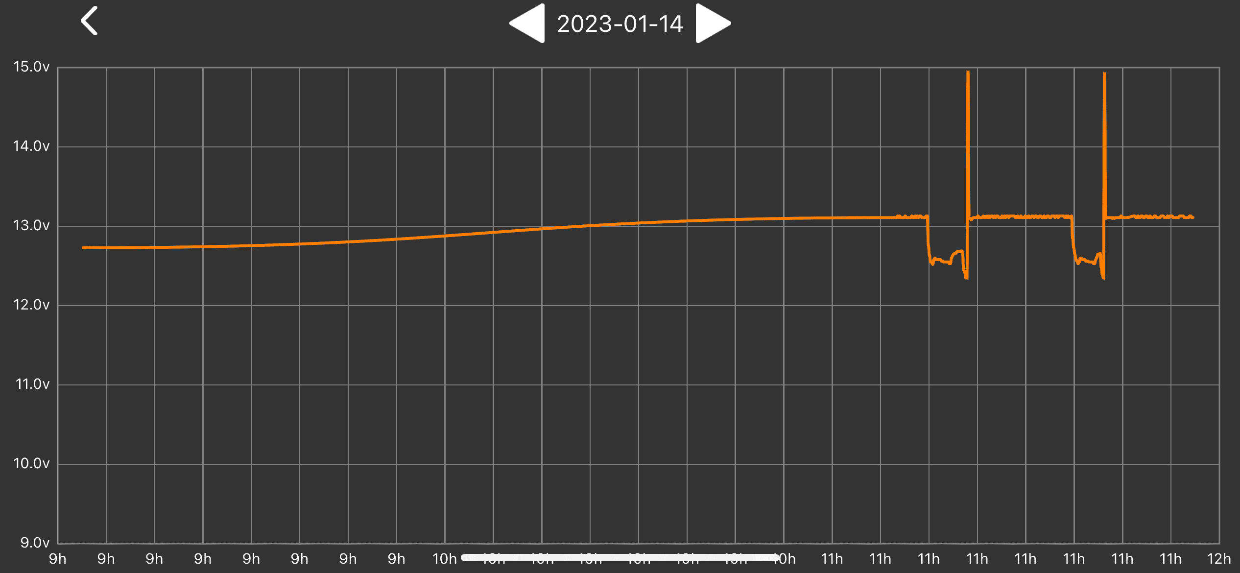

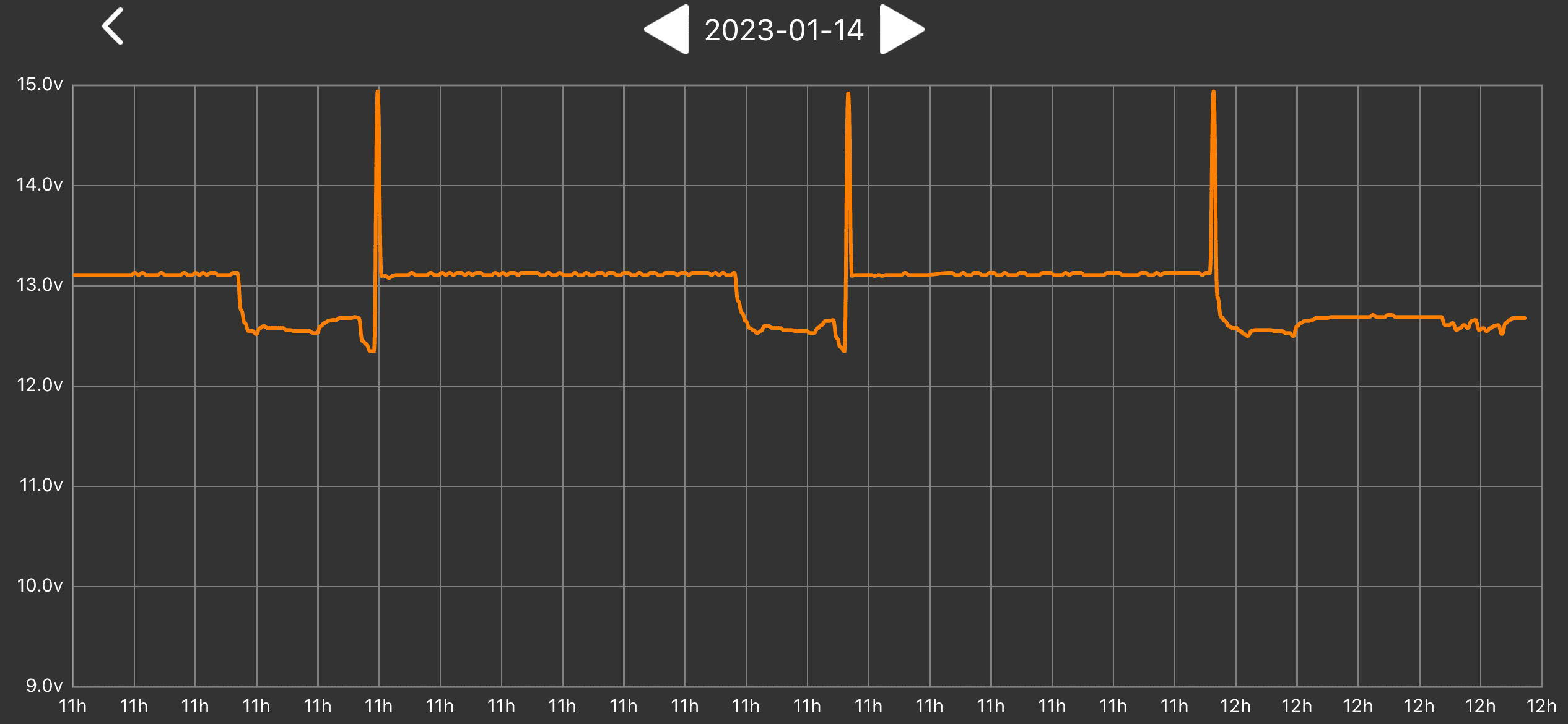

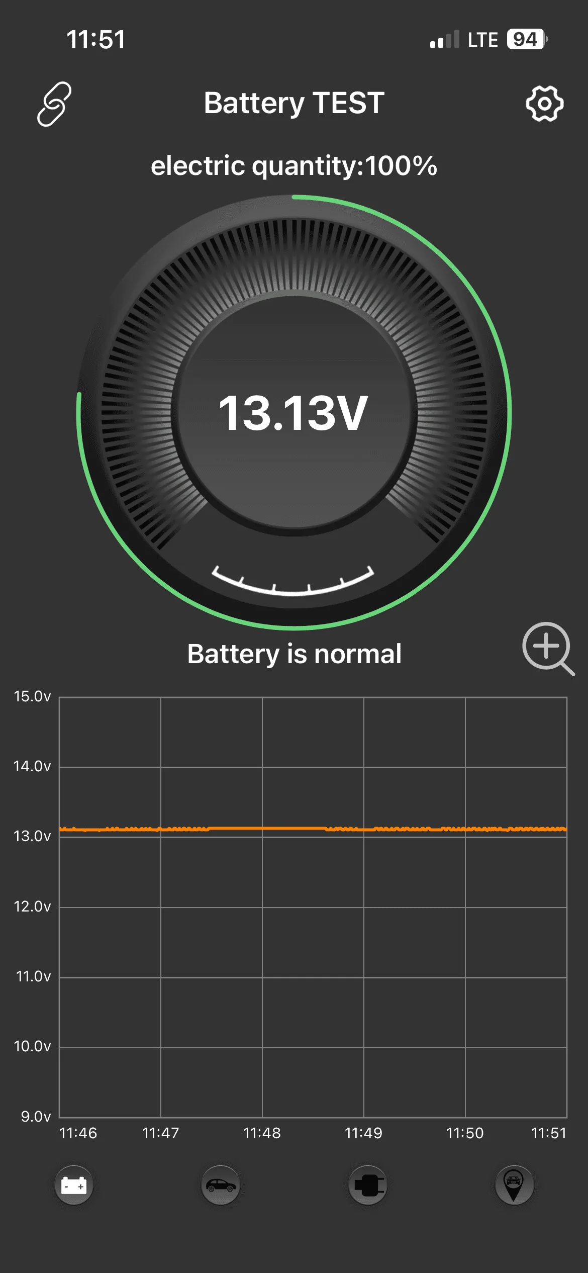

For my Escape Plug In Hybrid, after I'd installed a BAGMH6760 battery, I got one of the $26 bluetooth battery monitors(Battery Assistant) and hooked it up.
I'd charged the battery on Monday and it sat till I drove it around town today.
I'd see 15V at start and then saw 13.1V while driving. About 3 minutes after shutdown the relays would click and I could see the battery voltage start rising.
Ford Maverick Deep sleep mode alert Escape Battery Voltage - Sitting several days - IMG_0693.PNG
Ford Maverick Deep sleep mode alert 13.13V while Driving @1151 - IMG_0691

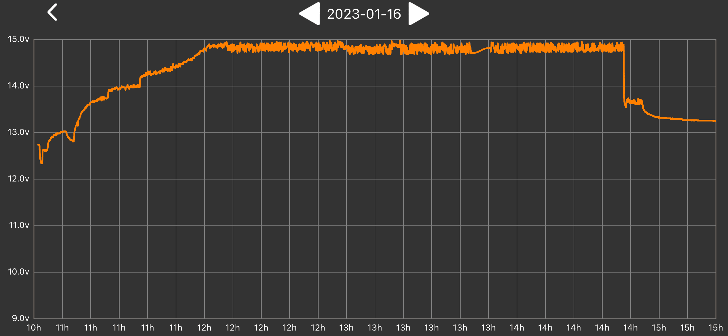

Charging Escape's battery with Deltran Battery Tender 12V, 15/8/2 Amp Selectable Chemistry Charger set to AGM, Auto.
Ford Maverick Deep sleep mode alert Escape Charging Graph 1100 to 1531 - 2023-01-16.PNG
