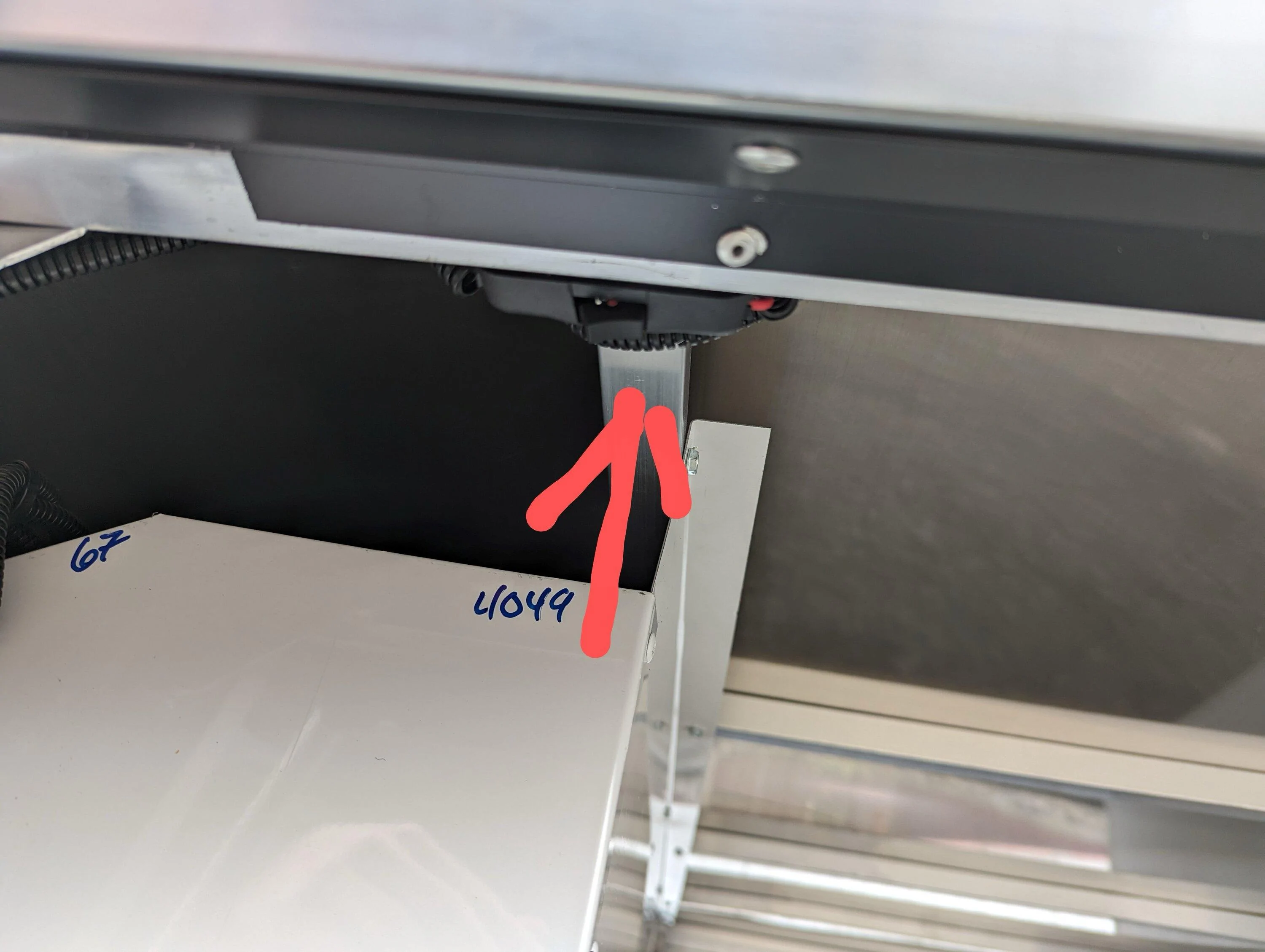

We have a 2023 Ford Maverick Hybrid (at around 2000 mile mark now) for our fleet vehicle and after having a bed cap outfitter install our bed cap (with LED lights under the wing doors)I was getting the Deep Sleep message every night on the Ford Pass app and then after it sat over a period of 3 day weekend we found the truck to be completely dead and we had to jump start it. That happened twice and Ford had to put a new battery in each time as they said it failed. The 2nd Ford dealership actually took time to meter out the electronics and found that the extra current draw was coming from our bed cap wiring harness that ran up into the engine area and connected to the positive jump post with an inline fuse in between. As soon as they removed the fuse to the cap lights wiring harness they seen the current draw go away. So then we spoke with the bed cap outfitter and we didn't know it, but there is a prop switch (at least on our "ARE "cap model ) that you can set to "ON" or "Auto", which allows you to leave the cabinet wings on the cap open and the LED lights will stay ON if need be. We found that somehow when possibly putting items in the shelves that maybe we bumped the switch and put it in "ON" mode, which obviously kept a current draw constantly. Sooo, if you have an ARE bed cap with LED lights under the door wings and back door, make sure a switch is not in the "ON" position. I think we got so accustomed to any kind of dome light going out automatically when the vehicle shuts off that we never suspicioned it was the bed cap lights.
Ford Maverick Deep sleep mode? ARE Bed Cap Light Prop Switch
