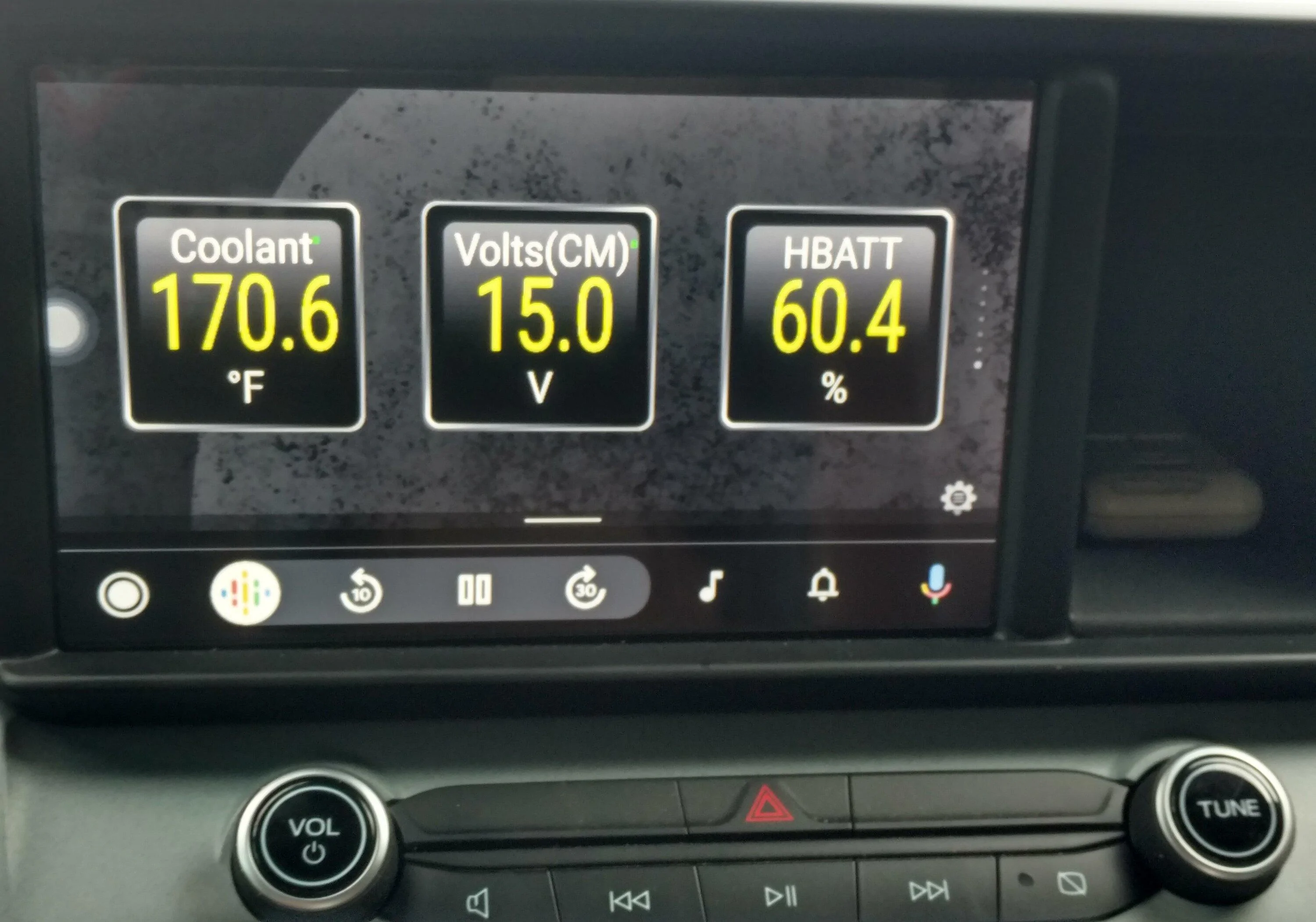

After putting on a charger overnight and resetting Battery Management System, I notice my 12v battery is staying at 15.0 volts while driving today. Before it would stay around 14.5.
Also no deep sleep message, yet.
How are you getting this info on your display?
Torque Pro app through Android Auto. Using Screen2Auto app to mirror apps not allowed by Android Auto.
Do you have to plug in your phone through USB or will it work through Bluetooth?
How did you figure out the way to get this all to work? It seems pretty difficult.
I assume you need to plug in an OBDII device into the OBD port to get it to talk to Torque Pro.
Which one do you have?
Using Android Auto, so it requires either USB cable or wireless adapter. I now use the Moto MA1 adapter.
I'm using this cheap bluetooth OBD2 adapter https://a.co/d/gl3dEED
Thread on Screen2Auto on Xda is pretty informative. I've used the app for over 2 years now, so I'm fairly knowledgeable on it. Note that certain phone brands don't work well, or at all, with it.
