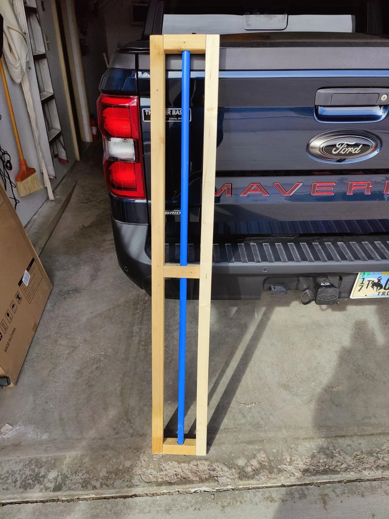

Well, the 2x6 is definitely more cost-effective...but with such a beautiful truck, I felt it deserved this extravagance.
I initially made a divider out of a 2x2 frame with a piece of plastic pipe in the middle to keep it light.

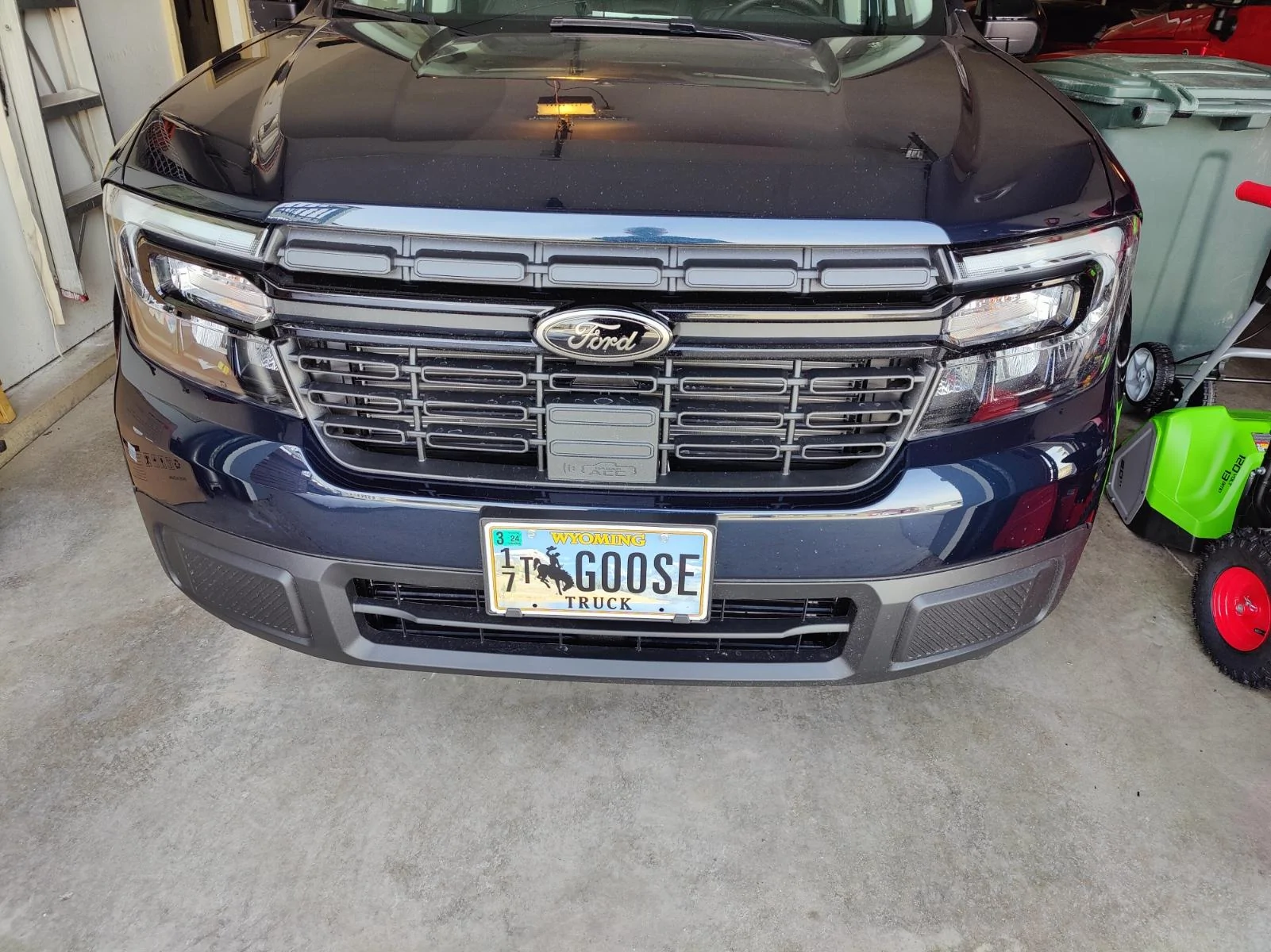

I just wish I could put homestate WY plates on mine. :) Thanks for spending time to share the photos and info!
I didn't discover Wyoming until I was 73. Love this place, especially with the county differences on the plates so I could also get "GOOSE" for a 1-time $30 charge. There were 6 other counties that already had GOOSE taken. Leaves more money for Bed Divider extravagance. :)
