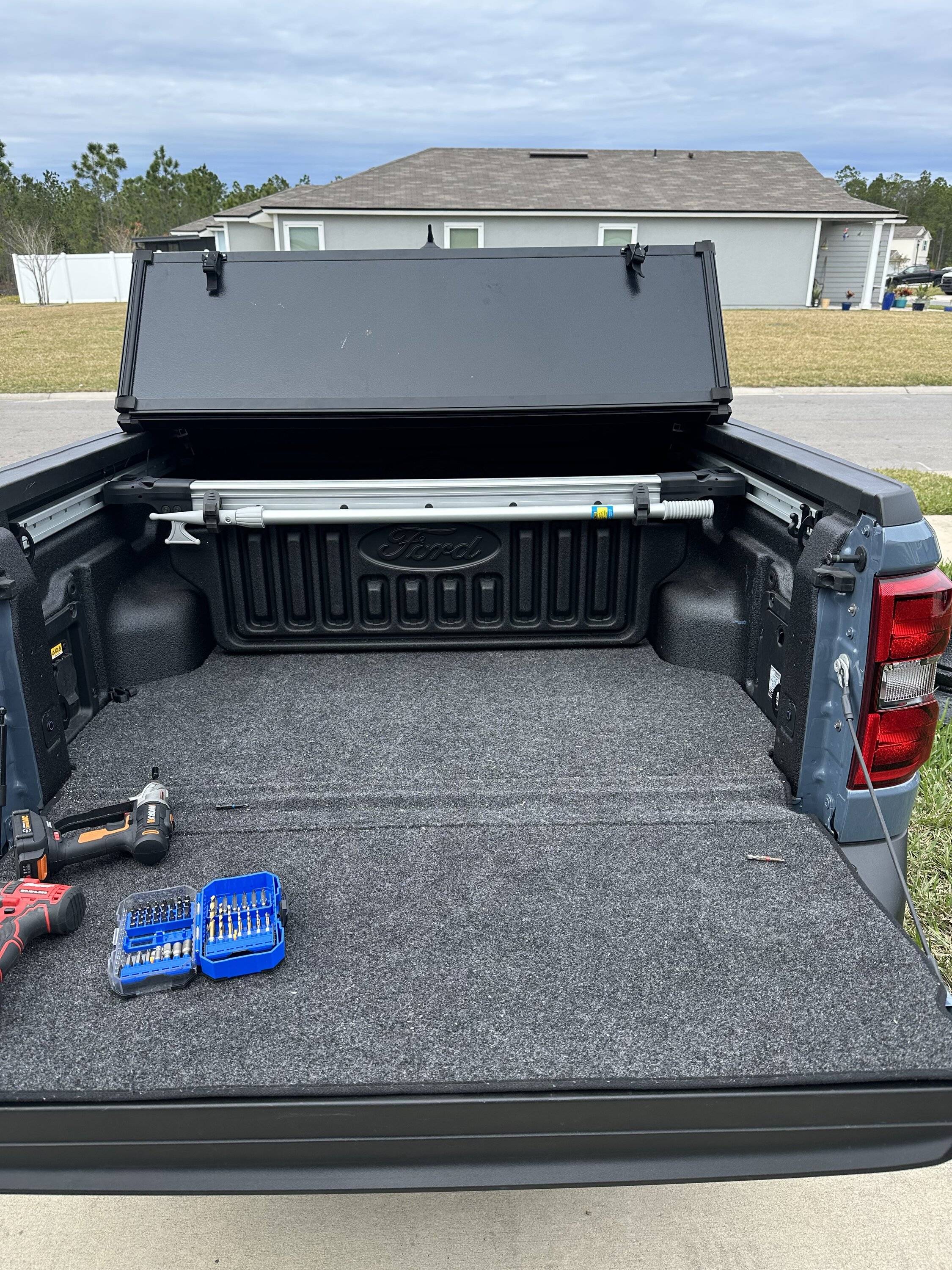

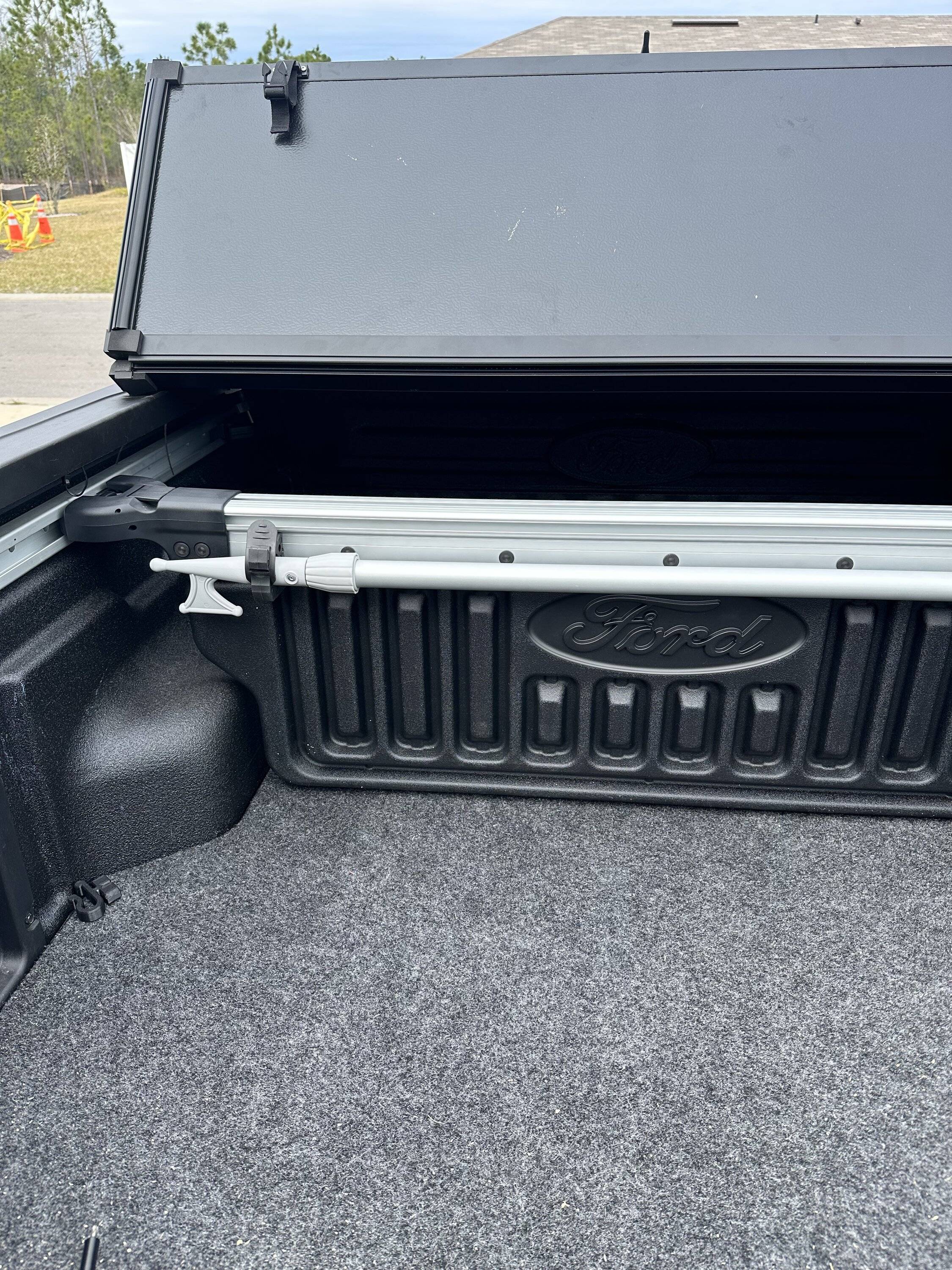

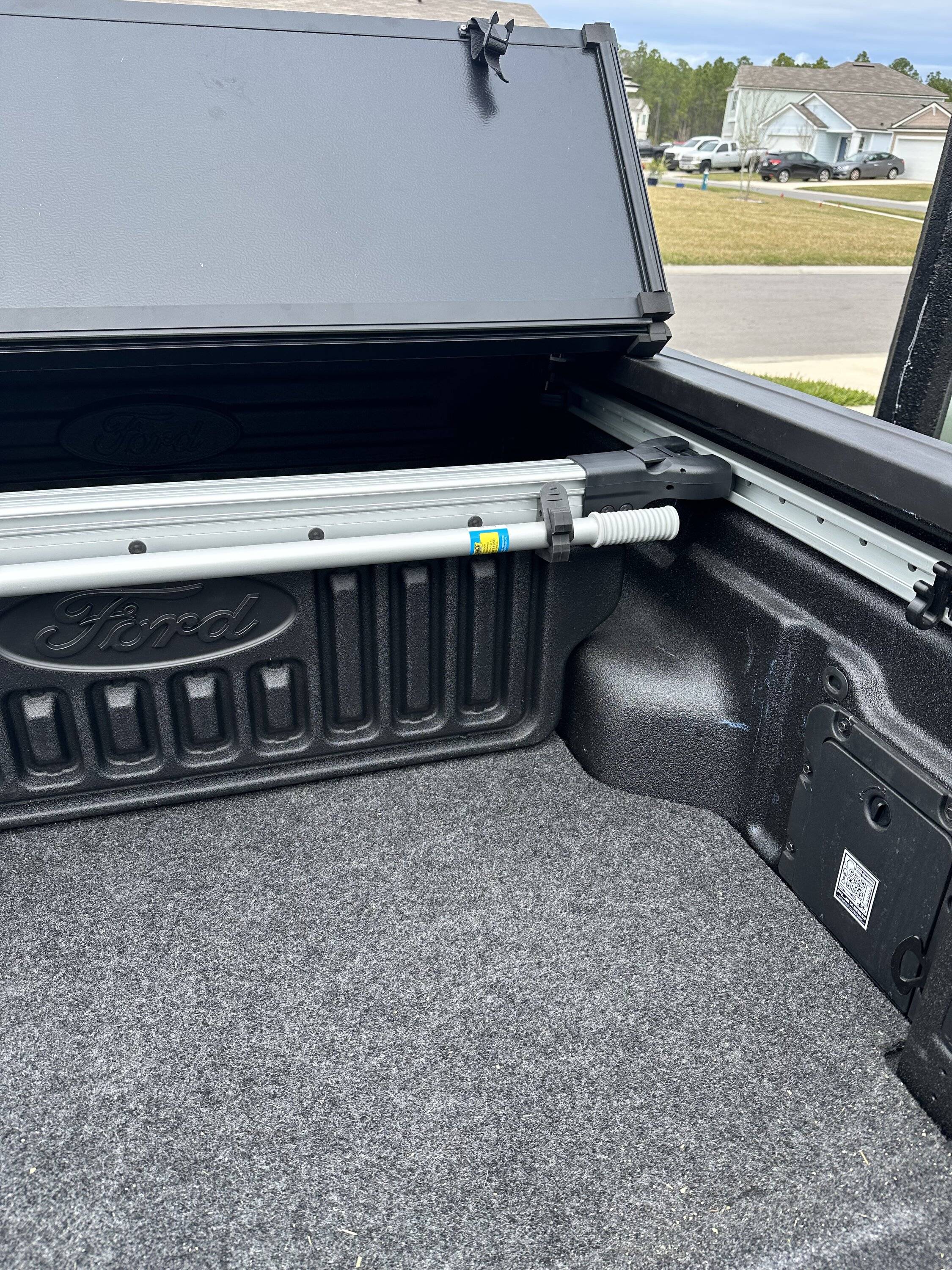

Hello,
I know several have mentioned how difficult it is to move the Ford Bed Divider as you have to go back and forth on both sides and move it a little at a time or get up in the truck and move it by pushing from the center. I found a boat/dock hook off amazon and some simple clip mounts and mounted it. Now with the hook and having the side rails in the unlocked position i can easily move it forwards and backwards while standing at the back of the truck using the hook. I have attached pictures and will provide links to what I bought on amazon. Hope this helps some others who are having this difficulty.

Ford Maverick Hook for Ford Bed Divider setup Bed Divider Hook 1
Ford Maverick Hook for Ford Bed Divider setup Bed Divider Hook 2
Ford Maverick Hook for Ford Bed Divider setup Bed Divider Hook 3
