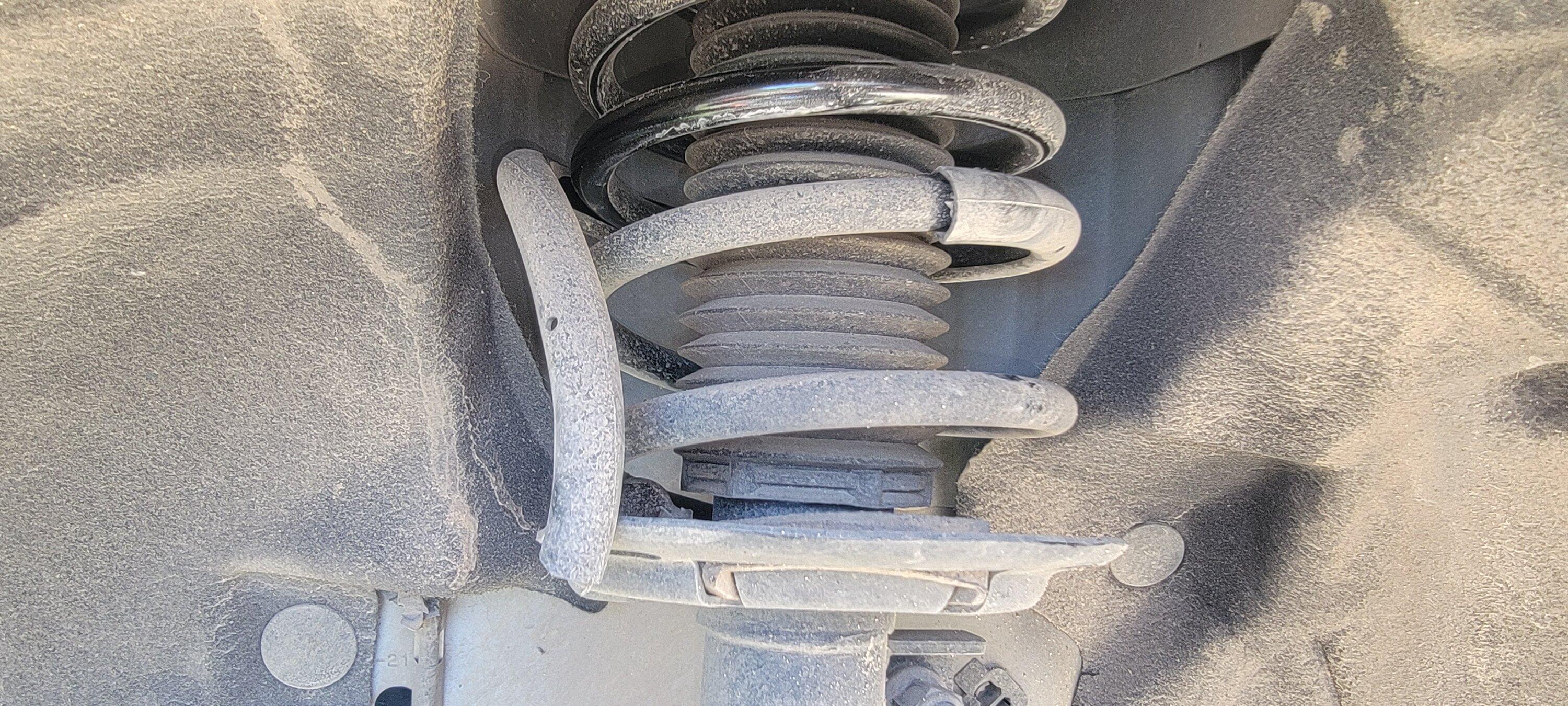

Struts are bottoming out so bad that it caused the isolator to break free.
Ford Maverick It's Lowered...But... issues with Eibach lowering springs 20230429_131528

Damn! What struts do you have? Regular or FX4? I have the idea that the stock strut isn't dampened enough to handle a lowering spring. As soon as someone comes out with a strut for these trucks I am going to buy them myself. While I don't have this issue I still don't think the strut is right coupled with a drop spring.
jewc75
Nov 24, 2021
950
1,114
Base xl awd struts. I agree. I think the spring rate needs increased and maybe that's why people have said the H&Rs ride alittle rougher. I'm not bothering with these springs anymore. When the others get here I will swap them and move on.
