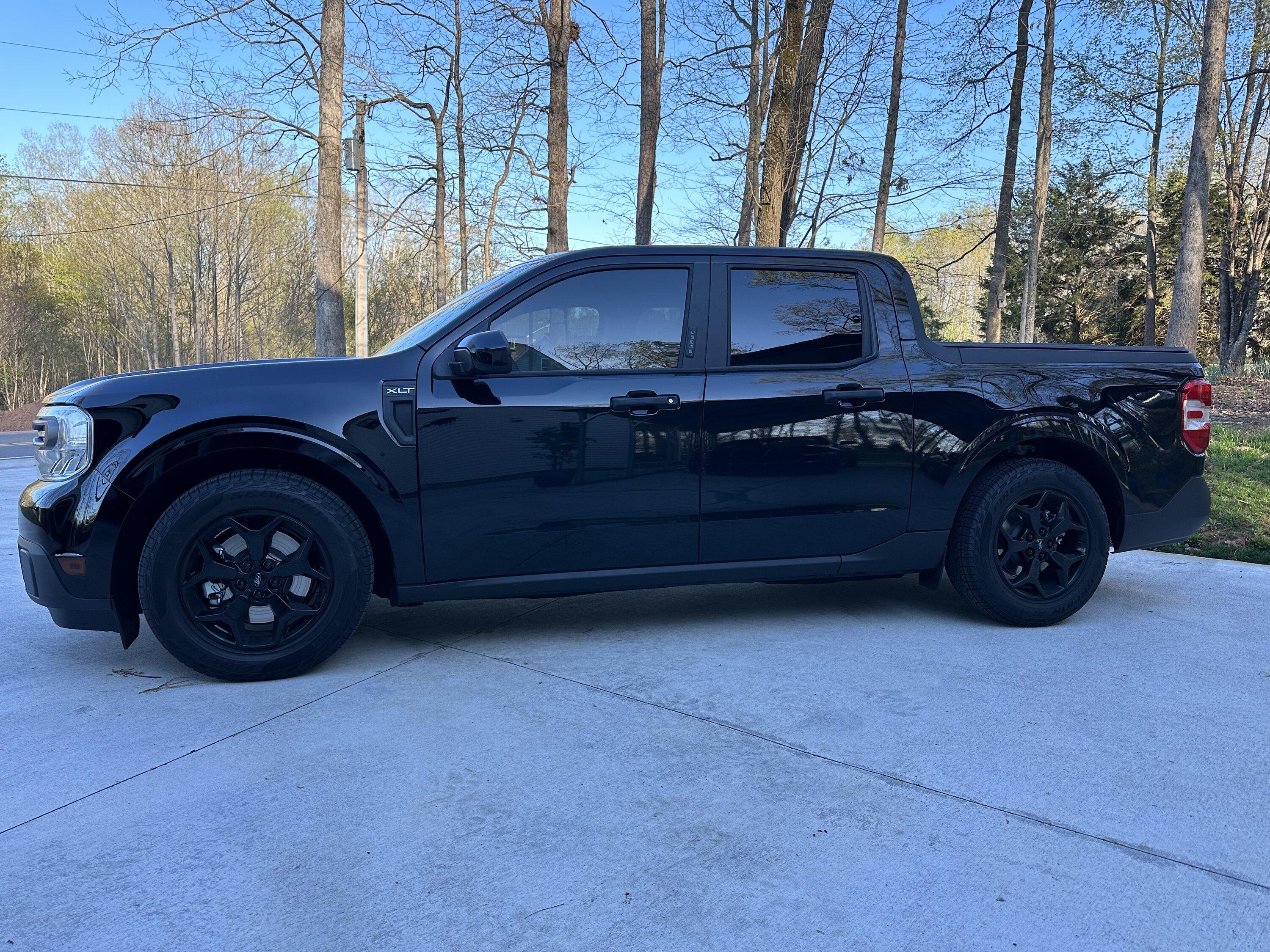

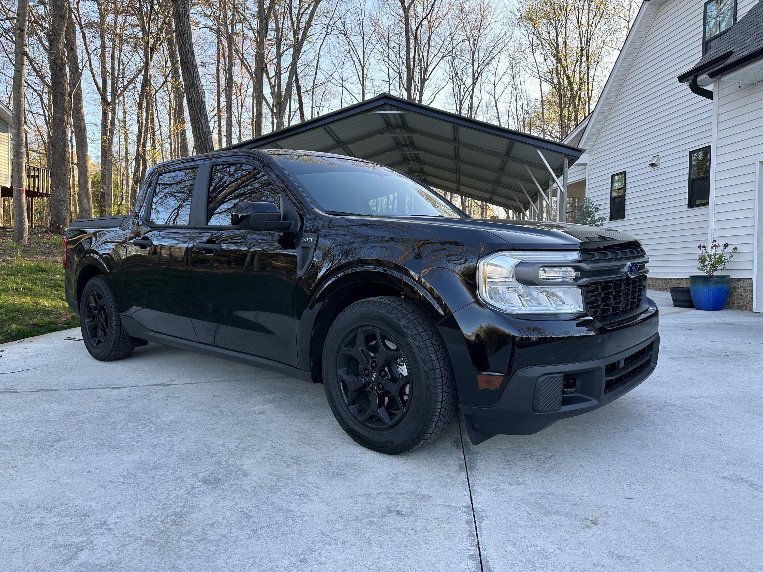

It looks amazing but I have the issues that others are reporting now with their eibach springs and we have taken this thing apart numerous times to check everything. It started with a slight thud when turning left only which led us to think it may be the sway bar end links in the front. Now after some miles and driving on various roads, it is doing the same thing driving straight on road transitions and turning right. I turned into an angled parking lot to go to dinner and it sounded like the whole front end is loose, even though I know it's not. It has to be something in the top hat. That is all we can figure at this point. I do not have aftermarket sway bars or struts, only eibach AWD springs. I dropped it back off with my installer this evening and he is going to call eibach in the morning for some assistance. Is anybody with the H&R springs having these same issues? It can't be just eibach right? I have their stuff in 2 of our Mustangs and used their products numerous times before with no issue. Anyway, here is the truck lowered, it looks amazing for a simple spring drop.

Thank you! Yes I cut the front bumpstops 20mm per the instructions. I am giving up on my Eibach's and ordering HR Springs tonight. Along with Scale adjustable end links. No matter what we try and we have tried everything, the eibach springs just have a popping noise that I can't live with. It don't make any sense that one manufacturer's spring creates a pop and another's don't. It has been documented numerous times on this forum alone. So I am switching.
Springs and end links ordered a few mins ago, should be here Friday. Not sure if he can get them on this weekend but as soon as he does I will definitely report back.
