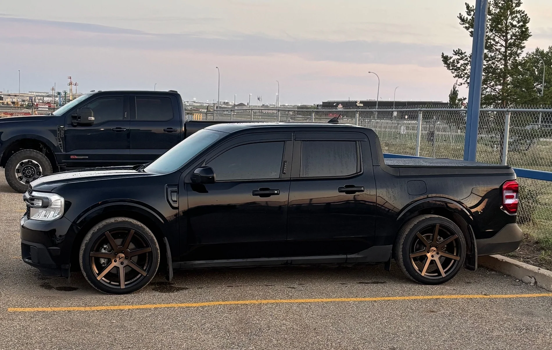

Well, I’ve installed the Eibach kit in my 2022 AWD and I am NOT impressed. The sway bar is smashing into the pinch weld. I’ve called Eibach and they said that they’ve never heard of this issue, I’ve also spoke with a few others on a FB page and they are NOT having the banging issue. One guy basically told me that it’s my fault and not Eibach’s….he must rep for them??
Does anyone have the official length of end link that needs to be ordered? I ordered some off EBay that someone provided a link to, but they are 6+” too long, and they didn’t know the length, just the link.
Eibach asked me to send them photos, which I will get this weekend when I’m back home.
But it does look good….just rides like shit with no suspension travel.

I guess looking good comes with a price! Nice rig

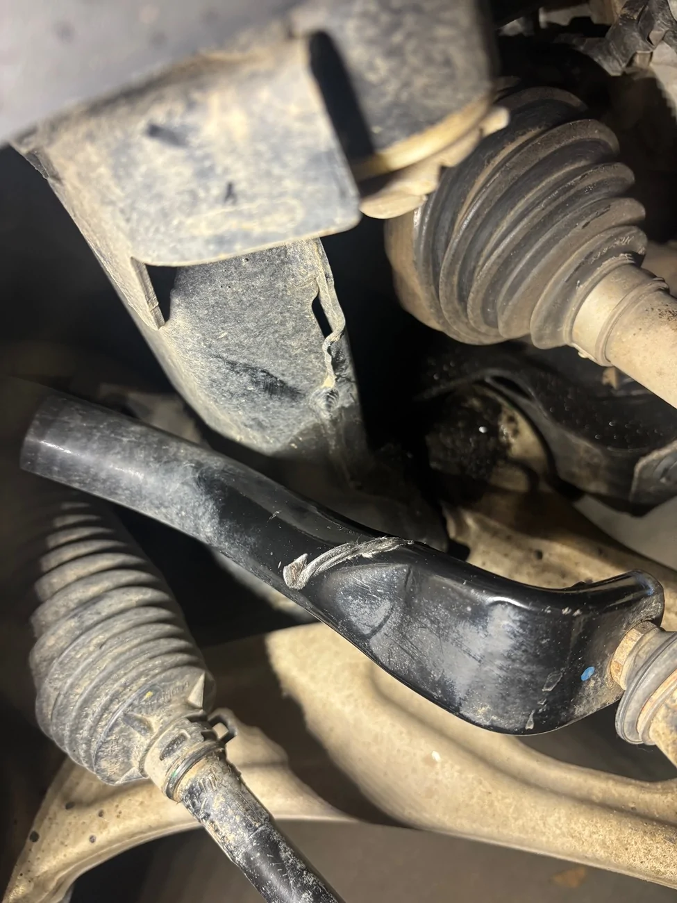

There’s pinch welds all over the body, they aren’t only in one spot. The location is right above the front sway bar almost right where the lower control arm connects to the subframe.
I’ve been a mechanic for 25+ years professionally, and I’m pretty sure I installed them properly, given the very basic instructions from Eibach. LOL!
And it’s not a matter of “believing” it is hitting somewhere, there’s actual damage to the front sway bar where it is hitting.

so post a pic? this still doesn't change the fact I've never heard of anyone with this issue and it is kinda looking like your real goal is bitching rather than trying to get advice and ideas for resolving your issue. I asked for more information than just pics and you gave nothing.
the noise that this thread was originally created for is/was not at all similar to what you're reporting.

Here:
