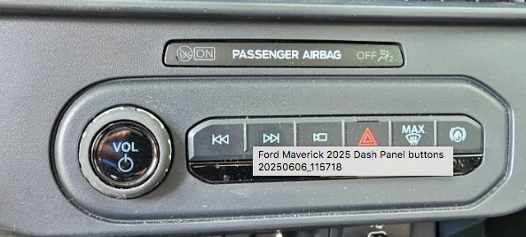

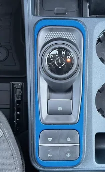

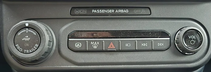

Perhaps to salvage something beneficial from annoying products and usage.
So all the pre-25MY have center console button for AS/S - which the smaller cable is designed to plug into the back of?
None throw it up to dashboard?
Ford Maverick Installing Auto start / stop elimination harness 1775843904166-q0
ETA: below is incorrect per next post. Ignore for this button - but enjoy the view!
But the 25/26MY it's on the dashboard row of buttons, and even the 3 connection cable may not work on the module below there?
Where is button on dash though?
Or is it still on the console area?
Ford Maverick Installing Auto start / stop elimination harness 1775844206221-1m
or
Ford Maverick Installing Auto start / stop elimination harness 1775844246317-cx
Perhaps I'm not helping stop the confusion.

The button is still on the console, if it was on the dash where it was easily visible it would be easier to use.
