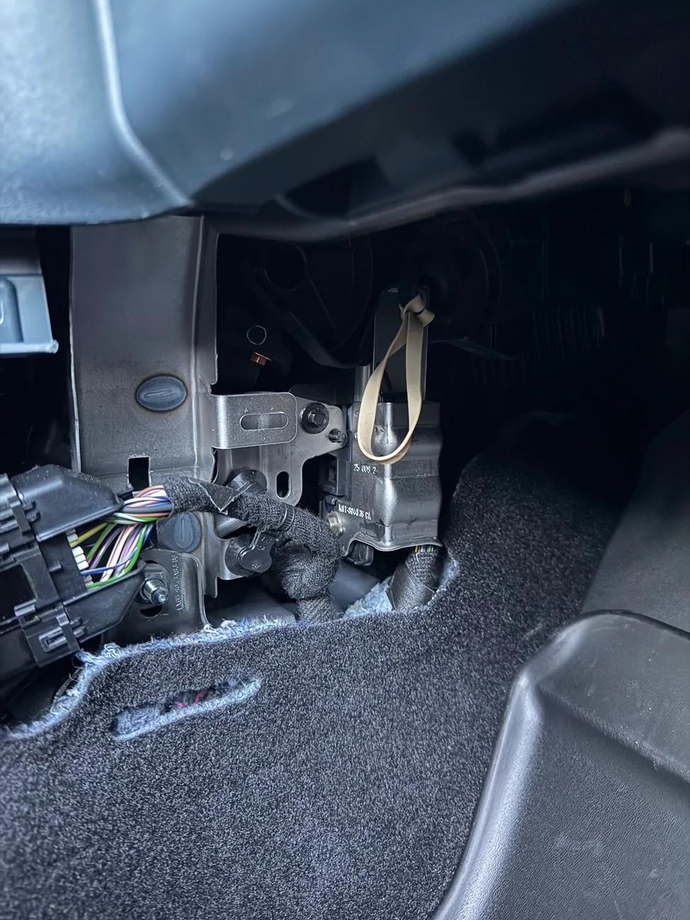

So i went out and popped off the side panel. My 2025 XLT looked exactly like that video. I easily placed a 7 mm socket on the screw and started to remove it. (Didn't take it off all the way since I don't have the part.) I see no issues installing the stop/ start in my truck.
Does anyone know what that rubber band does?
Interesting. Mine doesn’t have a bolt, or a rubber band.
