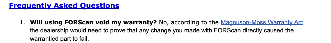

Thanks, but I'll still check with the guy that files warranty claims with Ford.
He knows what will and won't affect claims. If I hear anything different than what you've posted, I'll let you know. Thanks for the information
