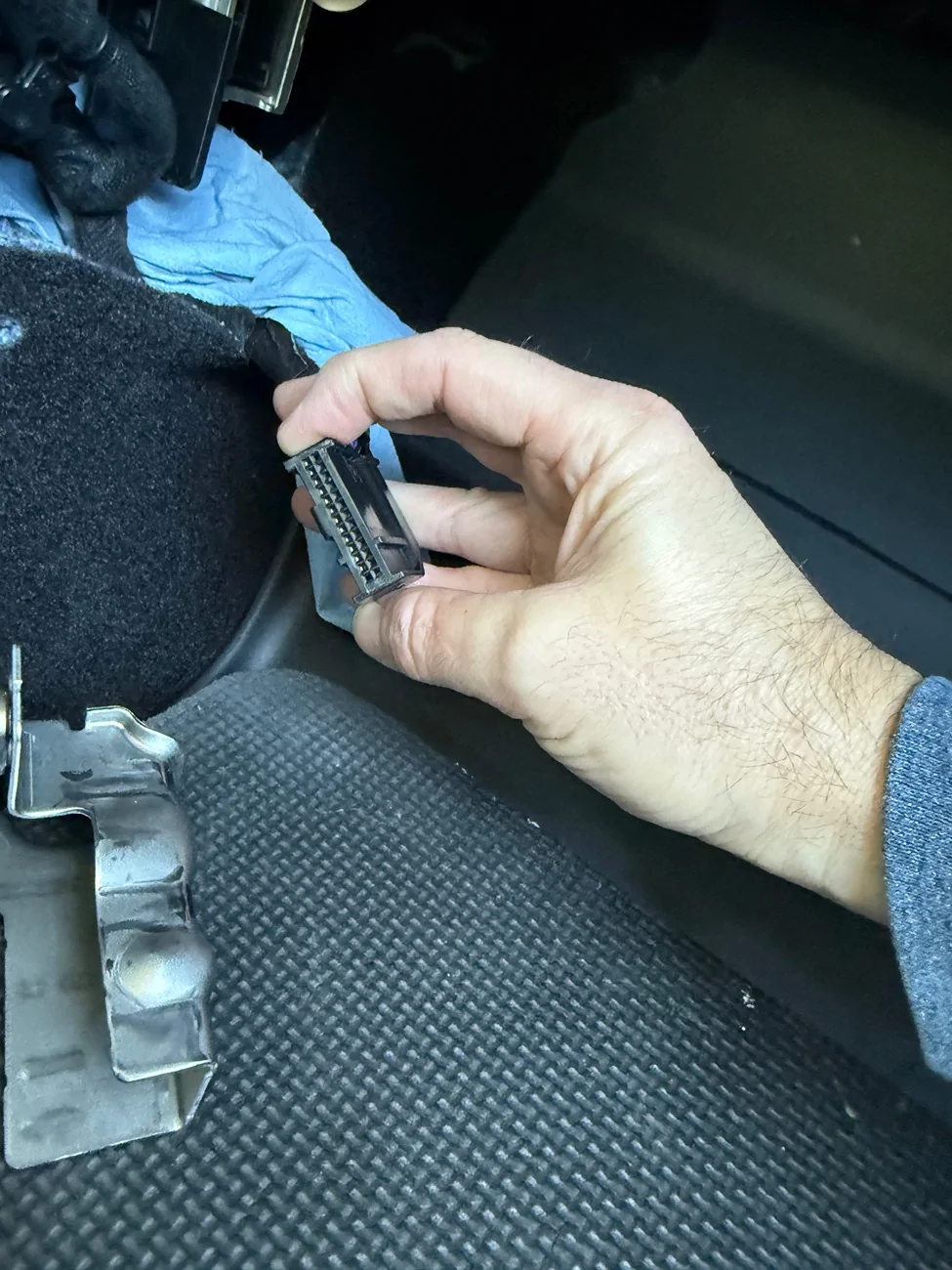

So i went out and popped off the side panel. My 2025 XLT looked exactly like that video. I easily placed a 7 mm socket on the screw and started to remove it. (Didn't take it off all the way since I don't have the part.) I see no issues installing the stop/ start in my truck.
Does anyone know what that rubber band does?
Ford hangs that there so you can wrap it around your finger to remind you to reinstall the shield and bolt 🤣 . Or as an emergency bottle cap gripping device for opening a bottle of water, actually works great on lids and caps.

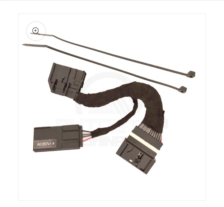

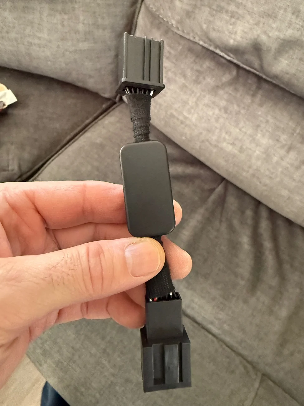

DO NOT ORDER THIS PART. The one in the link does not fit. see pics of what I was sent and what it is supposed to fit
https://www.ebay.com/itm/377016503480
This is the one I ordered. I said "about to install" but that was a bit of an exaggeration. It should get here next week. The videos I watched look pretty simple.

Oh no - the video even showed the wider version.
Hoping they just grabbed the wrong one to send you.
You had a rubberband also?
ETA - actually that video above seems like a different location than the description of the link you had before.
Cable connector at the button.
Is there another connector much closer to the buttons that has a different shape that matches?

Yep, mine looks exactly like the video. The one I received is the same as in the ebay photo. Definitely wrong.

It seems like there are two different styles out there, the cheaper one that connects to the switch itself, and the more expensive one that connects to the module.

That's why I asked if the received one shouldn't be used with that video.
I'm sure it came with instructions.
But even online - says connector by the button.
https://www.autostopeliminator.com/...ug5hj4eJXsKTflWqGvdQxecW_sMftb5vJAzawISzZayMw
You are absolutely correct. After looking at 15 videos, I found that there are two different parts that connect at two different areas of the truck. Almost all videos show an installation point through that side panel. The one I got came with absolutely no instructions so I assumed there was only one place for it to be installed. I already started a return on this one and ordered the more expensive one for the side area. An instruction sheet or a link to a video they recommended would have been great.

Absolutely no instructions which would have solved everything.
