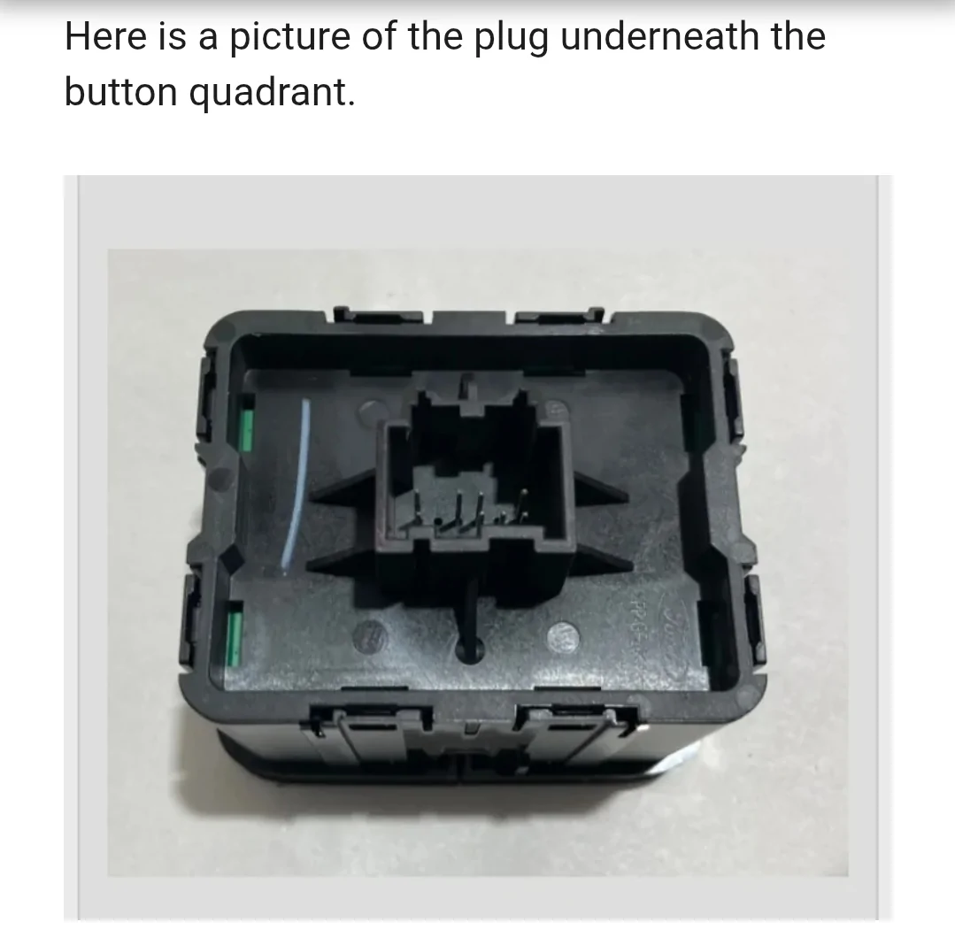

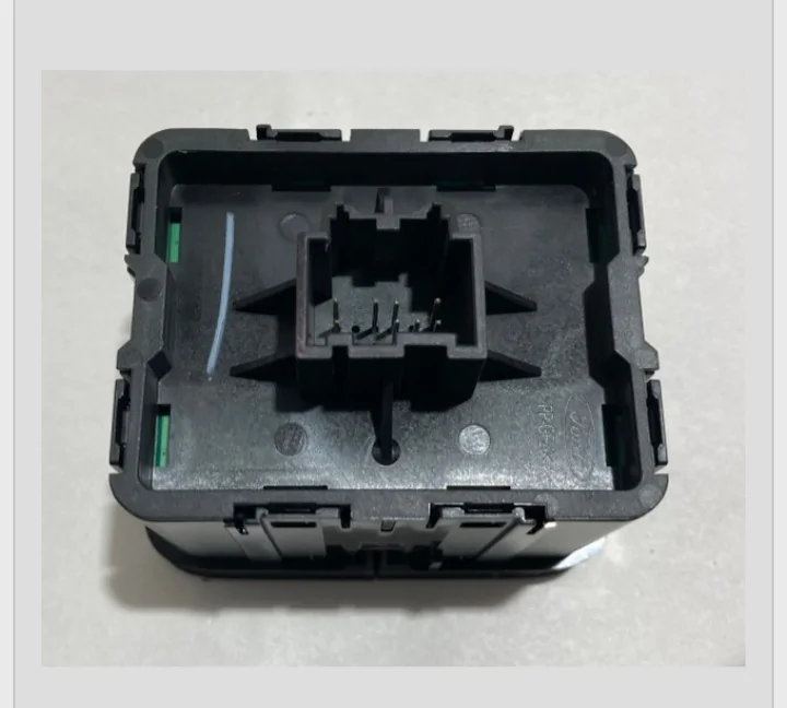

Did you try the plug right underneath the actual button?
Here is a picture of the plug underneath the button quadrant.

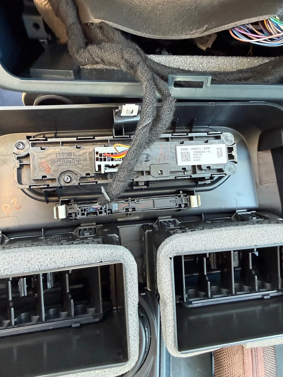

So here's what it looks like. The older models had two plugs; the 2025 only one. And it's half the size of the plug-in area on the device. (Compare the photo of mine to the video.)
I realized what you were saying. The original one I returned was for under the button (Never tried it because I had no idea there were multiple areas to install these things. And I already returned it.) This one was for the area shown in the photo. It doesn't fit there on 25s but does on earlier models apparently.
Holy crap. 😲 You've taken your whole dashboard apart.
I saw your post after I posted mine. We were seconds apart.
Sad thing is, the plug into the button install would probably have been easier.
