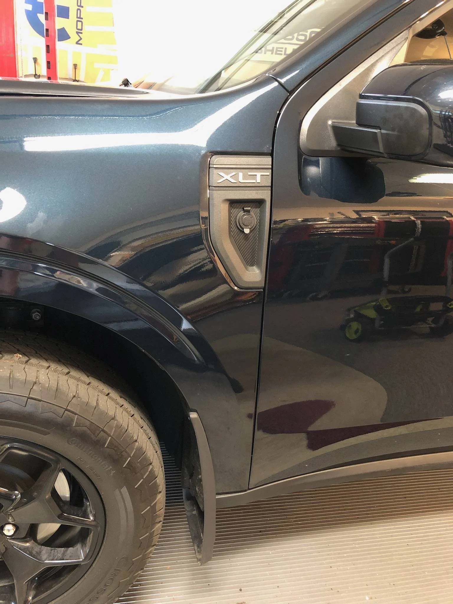

With so many power draining features on my new acquired 2023 Lariat lux...and reading a lot of posts on maintaining the 12v battery...I decided to install a permanent cable that I could plug into so that I can charge and maintain this new hybrid, since I don't put that many miles on the truck.
I've had it for a month now, and only just past the 200 mile tick...
So having CDO (it's like OCD, but all the letters are in alphabetical order, just as they should be!) I didn't want to always raise the back seat and remove the battery cover just to trickle charge. I went online and ordered a bunch of stuff for this project from TEMU.
If you like Amazon, you will like TEMU. Usually much better prices, but the free shipping is a little (maybe a lot) slower.
WARNING, it can be a little addictive!
Anyway, here is the build:
10 gauge SAE connector with inline 15a blade fuse for connecting to the battery. BJ12432 $6.47
10 gauge SAE connector with inline 15a blade fuse with a dust cap, for connecting to the above cable and to the battery charger. DE12653 $5.84
12-14 gauge SAE cable to splice into the battery charger. LE12539 $3.98
4 mode Smart charger - 12V 4Ah-100Ah Smart Battery Trickle Charger Automotive Battery Maintainer Desulfator With Temperature Compensation. VA00922 ~$16 now, I paid $12.50...
12-14 gauge Alligator clips with matching SAE connector. GP08199 $5.48
So after fighting with the trucks battery connectors...(trying to get the nuts completely off the peened/splayed shafts) I attached the cable to the battery, routed it under the trim towards the back of the truck, then into the storage compartment under the passenger side rear seat.
I then drilled a hole for the end connection in the small storage channel just inside the door. It all works great, and I'm happy with the setup.
The pictures I attached show all the components, and the routing.
I've added a lot more accessories to this truck that I will post in the proper threads later.
Really loving this Maverick!

Battery Tender mounted to garage wall, plugs in here. Marine-grade receptacle...
Ford Maverick Installing a dedicated trickle charging cable setup -- DIY writeup Mfvo3X
