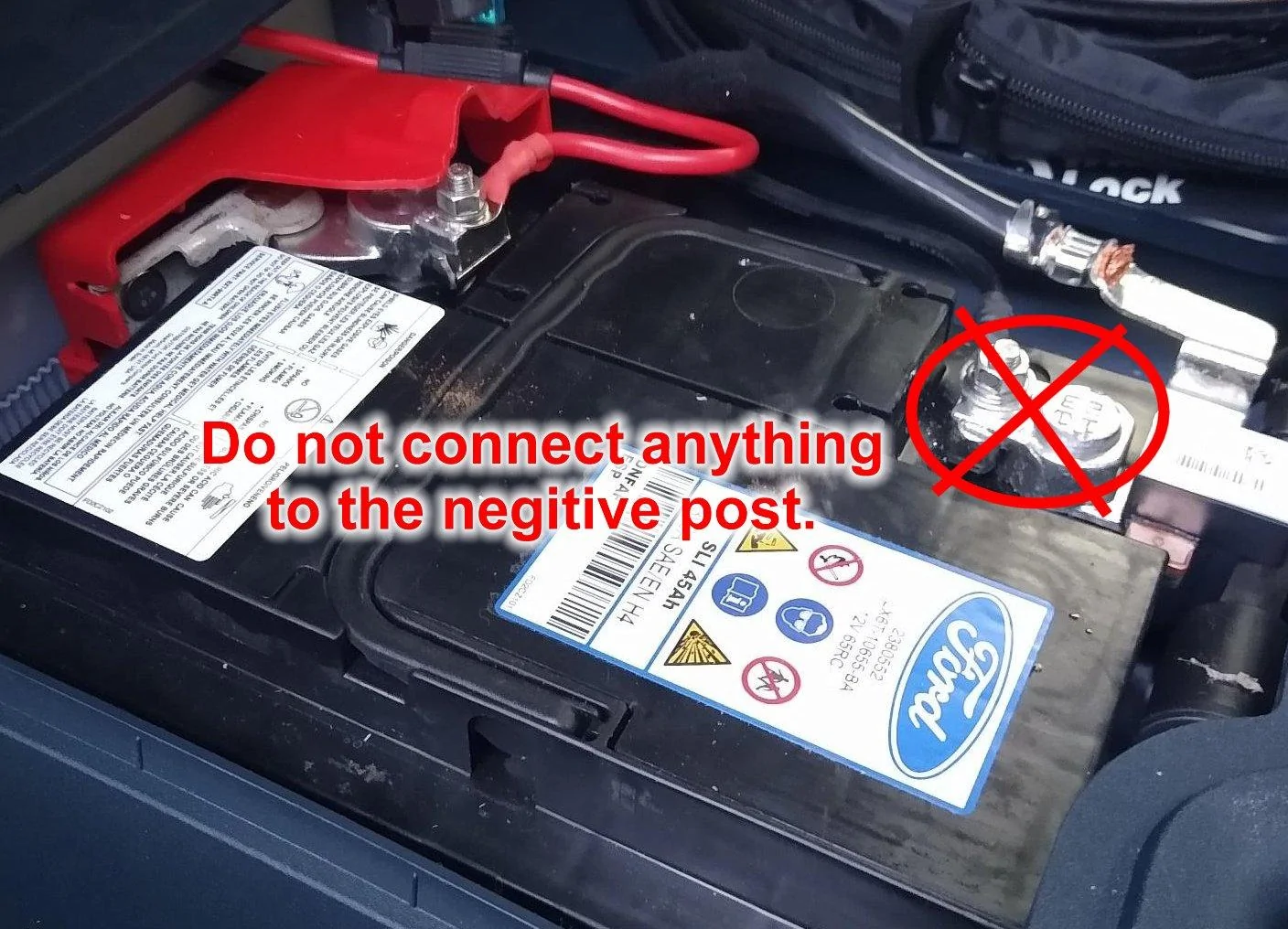

Tell me you didn't connect the negative wire to the batteries negative terminal post...
Never connect anything, accessories, battery charger clips, etc. to the batteries negative terminal. The Mav has a Battery Management System (BMS) that keeps an eye on the battery and the current going in and out of it so it knows it's charge status. There's a little box by the negative terminal (shunt) that sends the information to the BMS. If you clip anything on the negative terminal the BMS doesn't know anything is going on and it could screw up what the Mav thinks the battery state of charge status is.
Always find another negative ground point to connect to when charging or connecting anything else to the battery/12 volts. It's okay to attach to the positive battery post.
Ford Maverick Installing a dedicated trickle charging cable setup -- DIY writeup negitive battery post

And as we all know, the BMS is a perfect component. :) That said, my trickle charger is connected to the ground stud over by the fender. My BM2 battery monitor however is directly connected to both battery terminals. I have BM2 battery monitors on all my vehicles. They only draw 1-1.5 mA.
