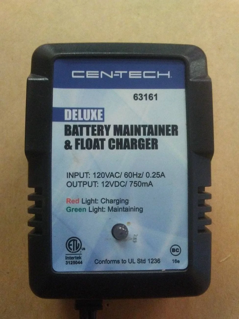

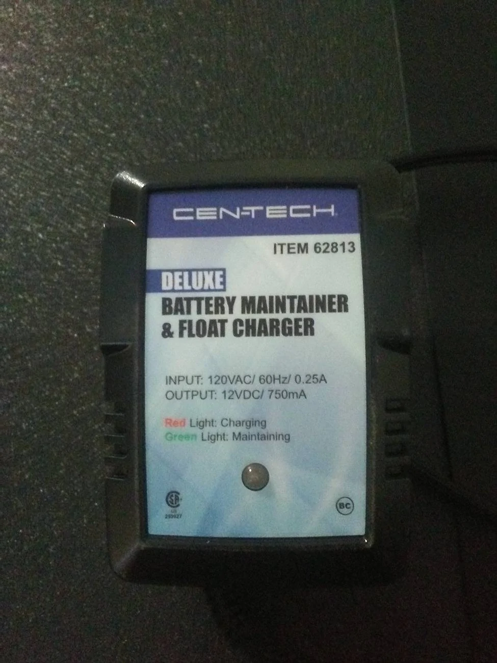

FYI - Harbor Freight has 2 versions of what appears to be the same charger. The part numbers are different (thank goodness), but the polarity of the keyed connector is reversed. You can not swap the accessory cables, which look identical. The good news is the chargers are diode protected so they won't smoke if the polarity is reversed.
What great mind thought of reversing the polarity?!(sarcasm)
