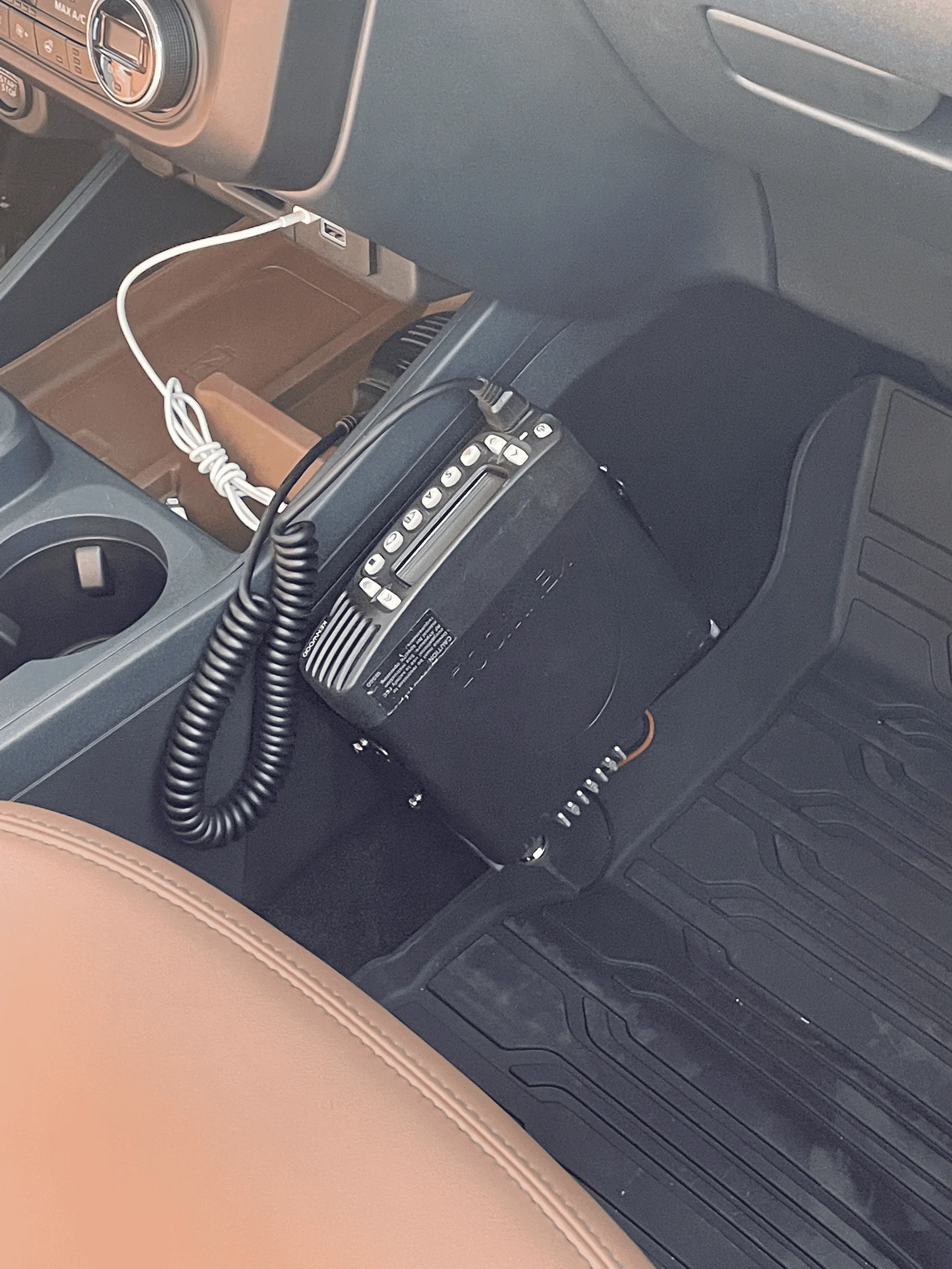

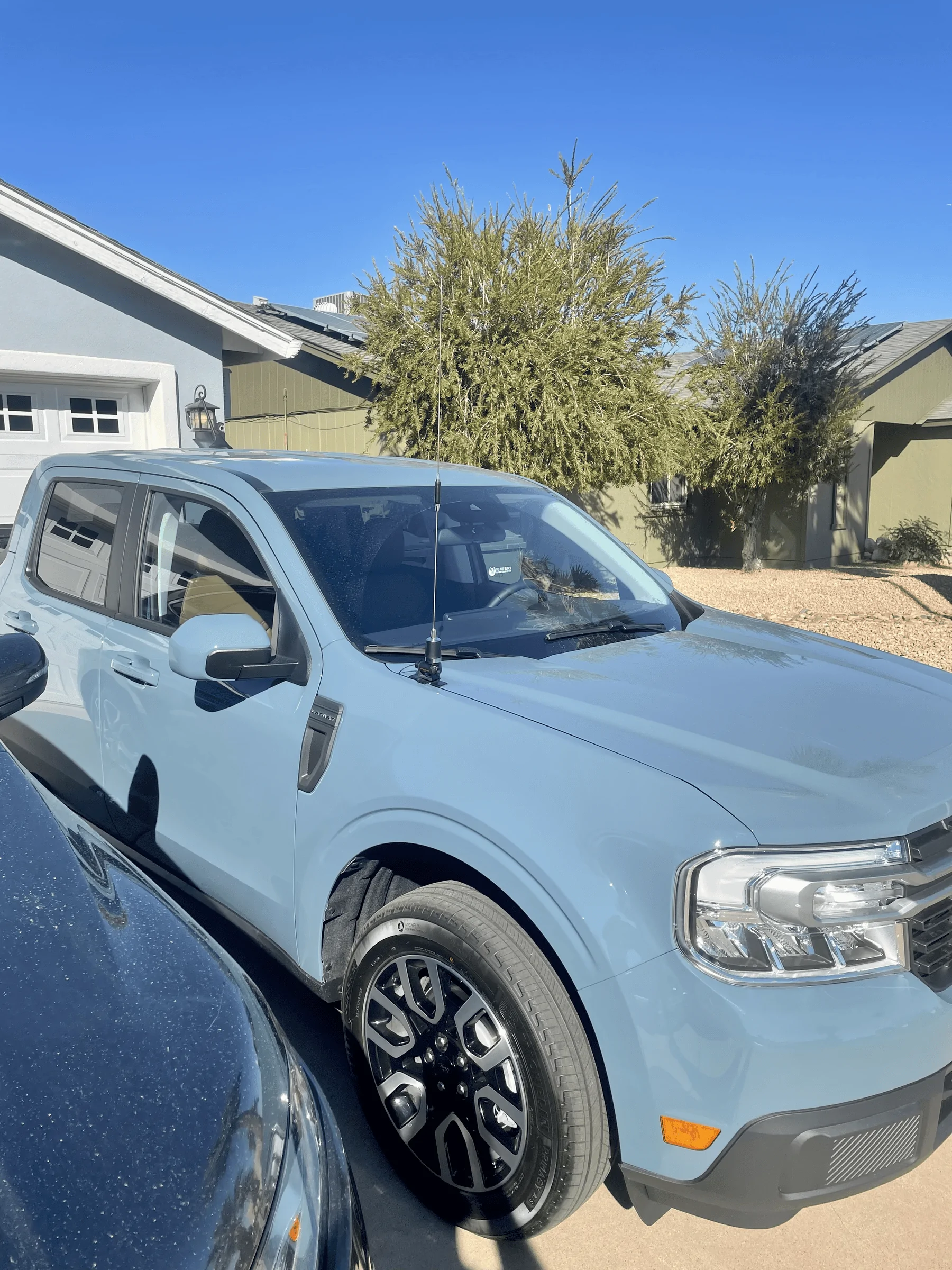

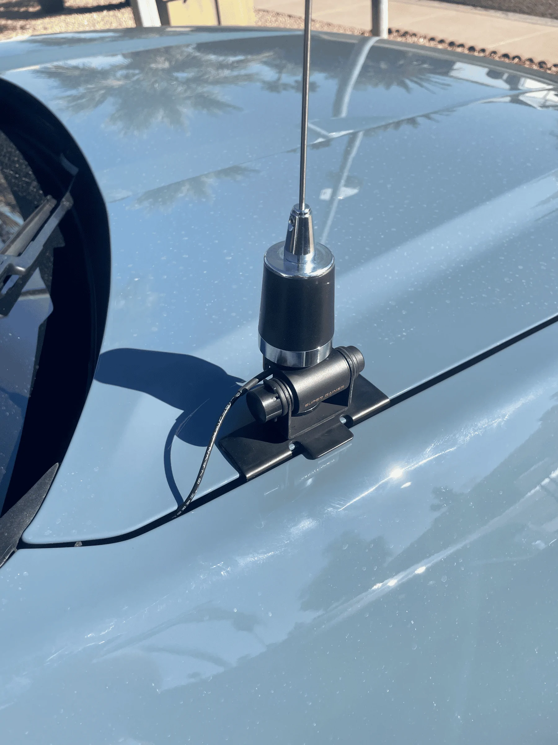

I did my GMRS radio install today, and Im amazed how clean and relatively easy it turned out to be!
Components: Browning BR 450 antenna - Diamond K400SNMO antenna mount and coax w/PL259 adapter - Kenwood 8180 radio / install kit included.
Diamond antenna mount attached to the passenger side of the hood, the RG-316 low loss coax is so thin and easy to conceal that I was able to attach it along the firewall with existing clips.
Coax passed through a perfectly located rubber grommet on the driver side firewall.
I then routed the coax around the steering to under the dashboard and fished it behind the center console to the passenger side. Went really easy and 13 ft of coax was perfect in length.
Mounted the radio to the side of the console, angled to me for a view from the drivers seat.
12V battery being under the rear seat (Hybrid) made it simple to run power under the passenger side lower trim plastic, to the radio.
Trimmed the antenna to get an acceptable SWR reading (1.18), received a radio check of strong and full quieting on the repeater, and the job was completed.
This diamond NMO mount was recommended by online forums I was reading, and I'm telling you, it is awesome. Ran about $70, and for no hole drilling in a brand new Maverick, it really did the job well.
