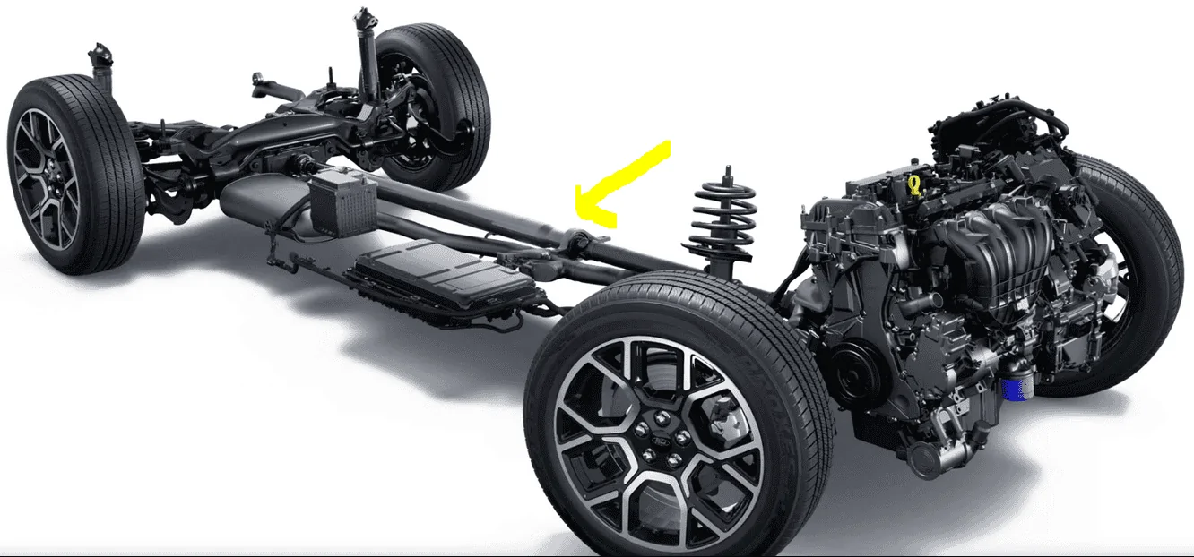

Did Ford upgrade the transmission in the new model.
Does it have a separate electric motor for rear wheels?
How is the power shifted to rear wheels?
Don't know where to find it..
Here you go: Rear differential unit:
The RDU is the rear differential unit. IT transfers the energy from the driveshaft to the rear tires based on throttle input and traction. It has a series of clutches that handle this.
--Alex Vecerkovic Bozard Ford Lincoln

Yes the eCVT has been upgraded. Not exactly sure how the AWD works though.
Are you getting this from a dealer sales guy?
Clutches inside the unit mean a lot more frequent changes...possibly more wear on the eCVT too since the fluid is more dirty on the average.
It would be amazing tech if Ford figured out how to do this without clutches.
No I got it from the tech
It's like n reference to the rear axle not the ECVT
While those axles exist for specific purposes of traction control, they do not control or balance front to rear power application. Very unlikely that Ford would put a limited slip type axle in the rear hybrid AWD. Doing so would have been well publicized at this point.
