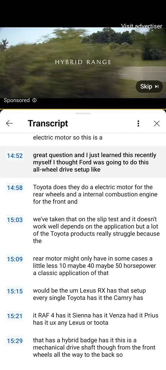

Found the video. They seem to be referring to the fact that the motors aren't super powerful but personally I think that's ridiculous - the rear wheels don't have as much weight on them so why would you want a lot of power on the rear wheels in a low traction situation...
Ford Maverick 2025 Maverick Hybrid AWD Rear Differential (photos) Screenshot_20250106-221916

You are forgetting the fact the Maverick has a healthy payload capability as well as a 4,000 lb towing capacity. When a vehicle accelerates its center of gravity shifts rearward which means traction is critical for the rear tires especially when towing. If the rear tires don't receive enough torque when accelerating then there is a good chance the front wheels will lose grip which of course is not ideal especially when pulling heavy loads.

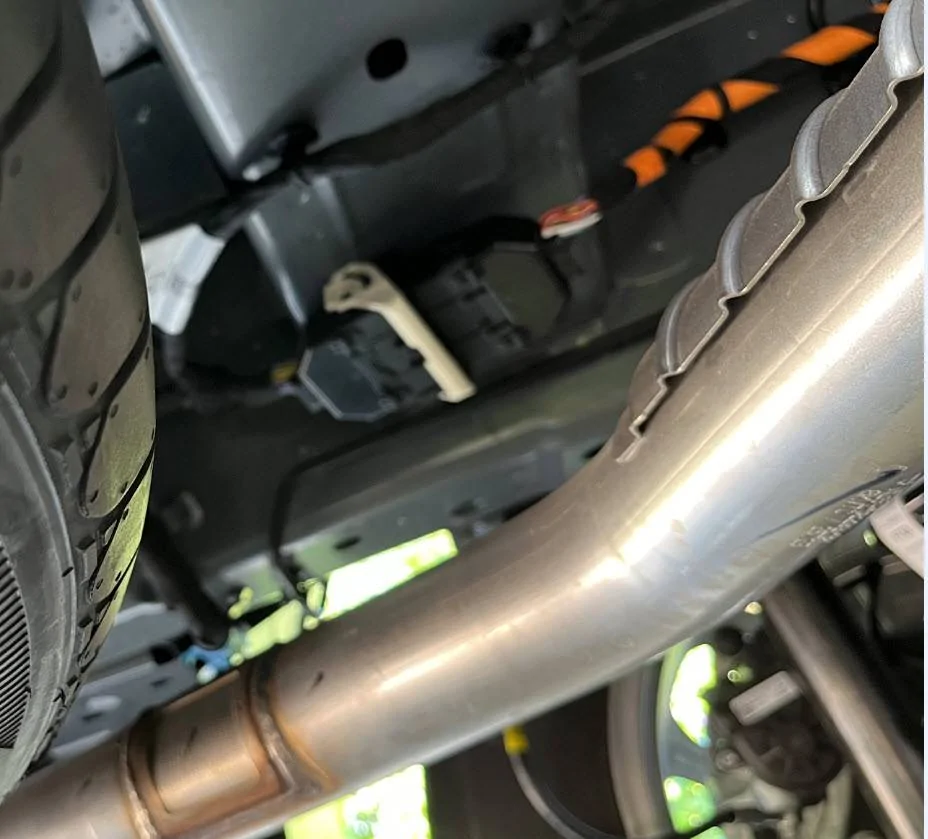

Is that the orange high-voltage wire cover coming to the back?
Or is that cover used on other things I've not noticed?

That harness with orange tape looks to come out off the LH rear cabin wall on my 23.
I wonder if it has 120VAC from the DC-AC Inverter on trucks with the 120V outlet in the bed.
The orange tape is on my 23 XLT. I have an inverter, but don't have a 120V bed outlet.
Ford Maverick 2025 Maverick Hybrid AWD Rear Differential (photos) C404 Inline LH side under bed
The connector might be C404 - https://www.mavericktruckclub.com/f...-aftermarket-under-rail-leds.7570/post-511872
