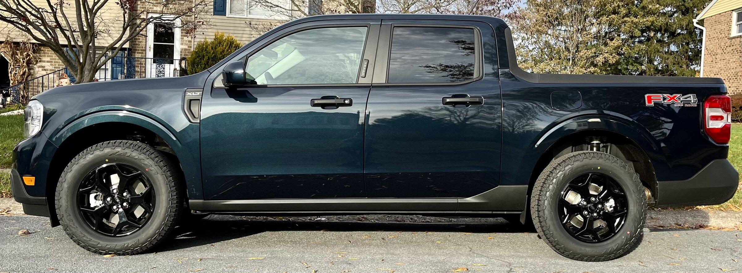

Please break out the hair dryer and remove that dealer emblem. It completely takes away from the nice look of your tailgate unless they are paying YOU to advertise for them.
