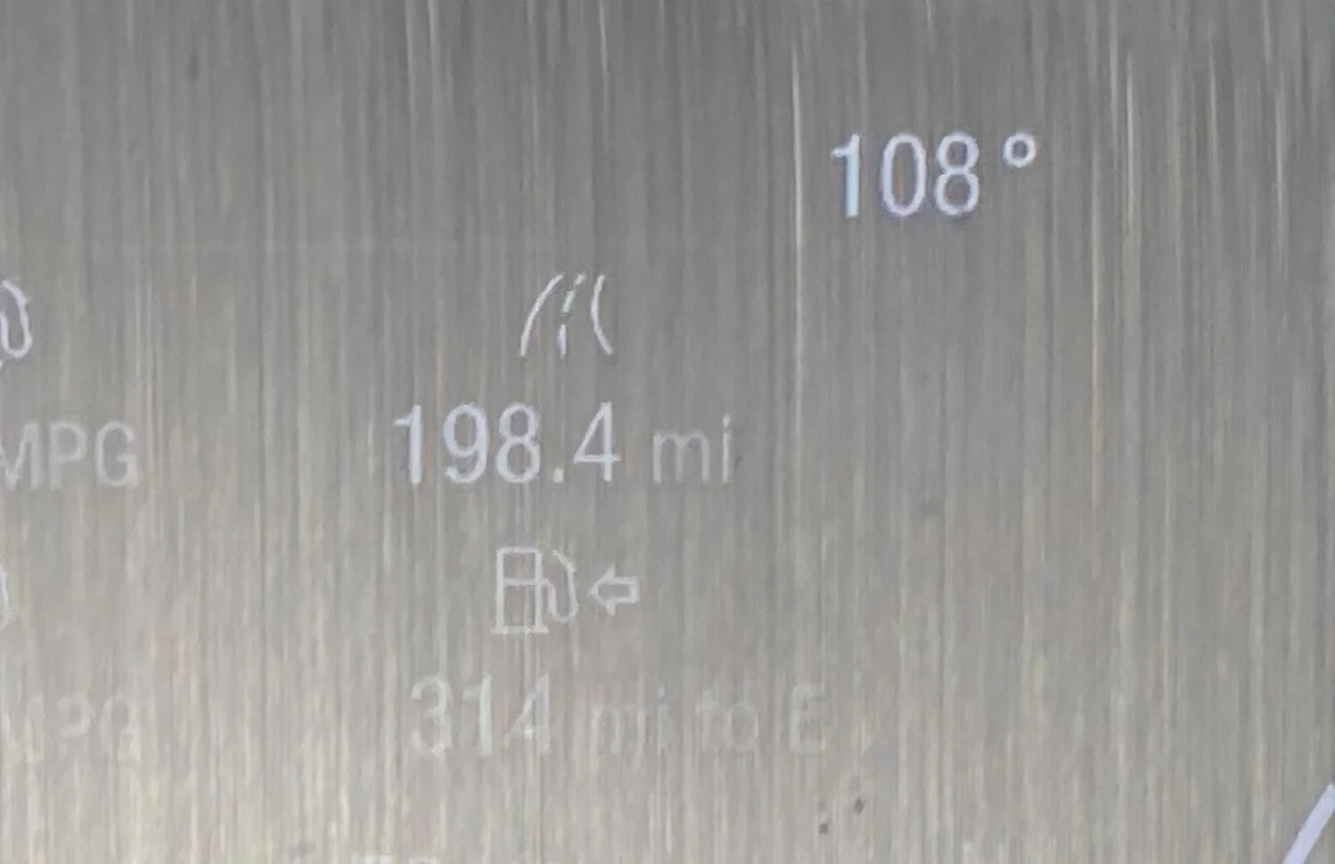

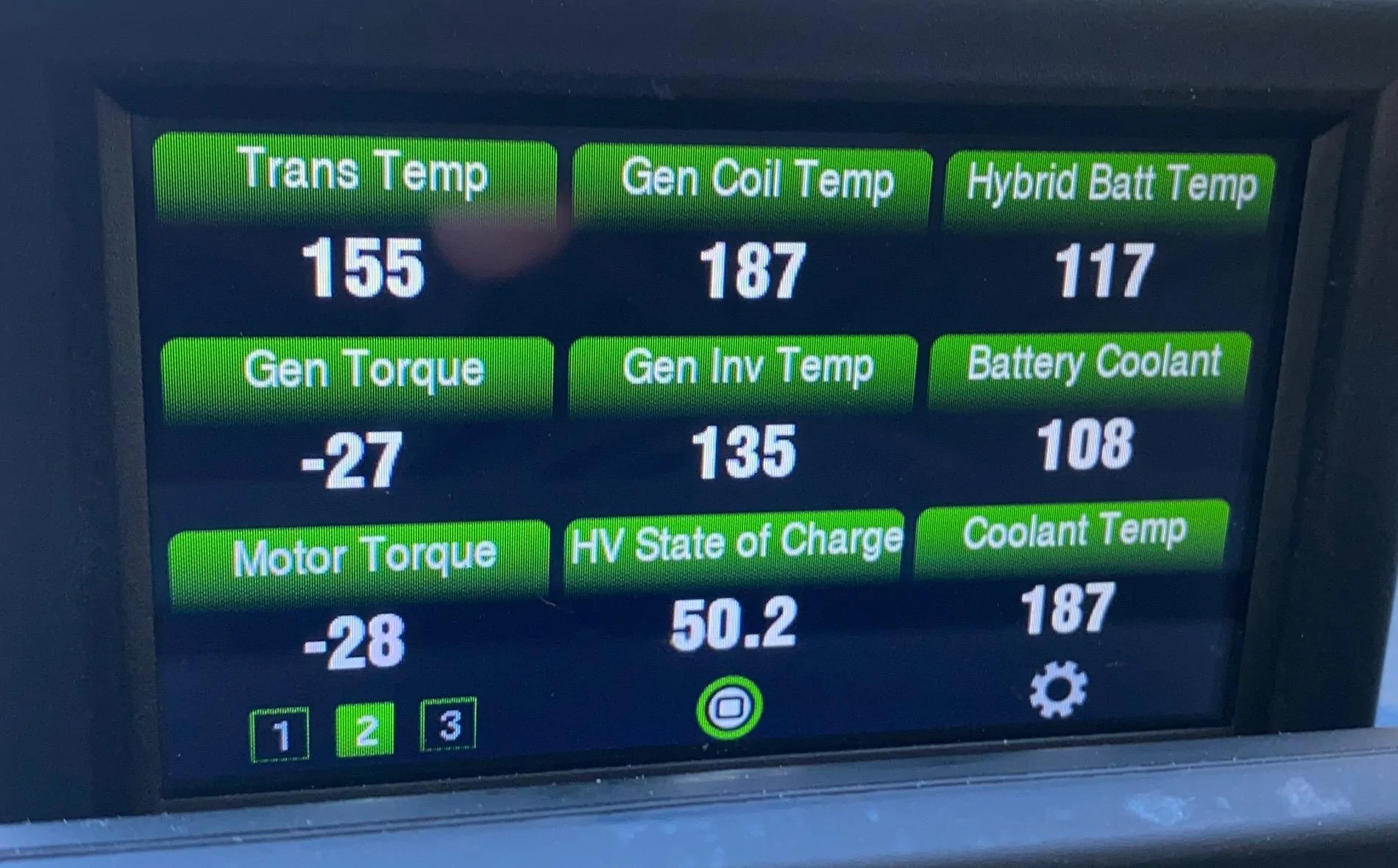

Towing ~ 1500 lbs, Interstate Speeds
108°F day
Undulating hills between 1000' ASL to about 5000' ASL
No problems; no warnings, no derating of the power. I've not yet found the upper temperature when the battery starts to decrease output. That was my only (pleasant) surprise. I had to move an OHV this day.
108°F day
I remember someone posting that about 113°F ambient temp his HVB usage was restricted.
108°F day
'Hybrid Batt Temp' a bit concerning - Li-ion battery tend to degrade at temps over 95Âş.

The hybrid transmission doesn't get hot. Not the gear sets. There's no slippage in the hybrid's eCVT.
The generator, which is a part of the "transmission" did get warm in mine towing not quite 4k up 6% on a hot day.
No alarms, bells, or warning messages because I backed off by 10 mph (60mph down to 50mph) and it cooled rapidly. These devices have their own liquid coolant loop. Slowing 10 mph for 2 minutes allowed the system to "catch up". Like a 50 degree F swing in 2 minutes.
Having a ScanGauge should be standard equipment along with the brake controller (that I added myself).
People don't "get" why I'm so confident.
It's because I monitor EVERYTHING in my truck's engine compartment.
What % power were you at when it was getting hot and when it was cooling?
