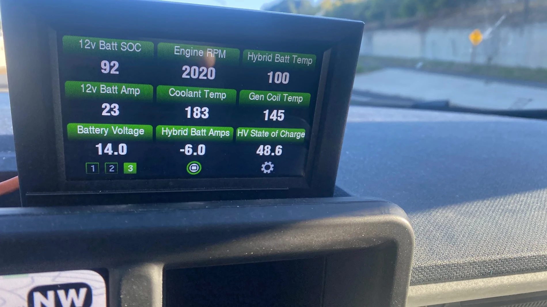

Pulled my trailer 4 hours yesterday.
Truck topped off the 12v battery and the trailer battery in about 1 hour.
Kept it at 14.0v and 100% charged for the remaining 3 hours.
This morning came out and SOC reading 96%. Normal (well, typical) 4% drop overnight. Bright sunny day. Left all lamps off.
Nice thing about ScanGaugeIII is you can set audible Hi/Low alarms for any parameter.
About 30 minutes into my normal commute (freeway speeds) ALARM! ALARM!
WTF???
12v battery had dropped to 11.5v and set off my audio alarm. Good thing I had it too. After so much towing and charging I was not paying much attention to the meter this morning.
Turned my parking lamps on.
Instantly 14.0v and 23 amps positive charging. With only 15 minutes left in my commute, charging tapered to 6 amps and voltage was 14.3v at the moment I turned the key off.
Theory:
I think the DC/DC converter is turning off completely in these cases.
Why else a fully charged (new 1 month old battery) would drop to 11.5v in 30 minutes? The (faulty?) SOC meter was still saying 92% so no attempt to charge was being made.
