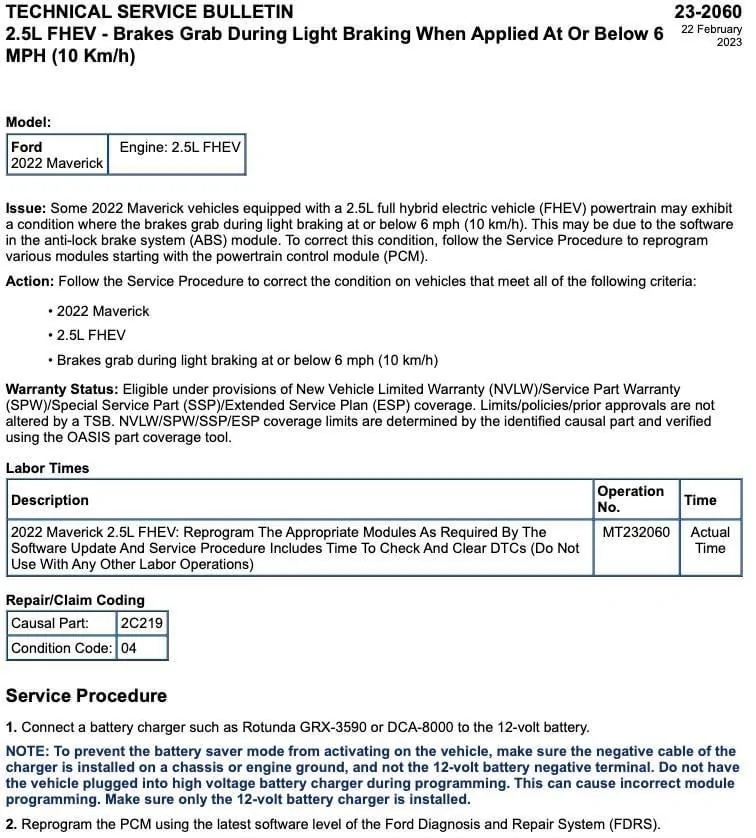

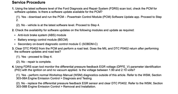

Since both it and the new TSB 23-2060 (in part 4. of the service procedure below) reference the EGR, it seems reasonable to believe that system is involved.
That thread has the images a bit jumbled up in some places. Those instructions are from 23-2059 for the EGR/DPFE Sensor.
TSB 23-2060 is such:
Ford Maverick Grabby Brakes 23 Hybrid 908df5e3-f181-4aa6-8748-82fa2a801355-jpeg

I haven't gone in for the TSB, it doesn't fix it? It's so annoying in drivethrus, feel like I'm going to hit the dude in front getting my morning coffee.
Same thing with my truck. The worst brakes in any car I have ever driven and I have driven hybrid cars for years.
Thanks for clearing that up! EGR did seem unrelated, but systems are so integrated now didn't seem implausible, especially with the original TSB circus.

I did take in my Maverick in for TSB and it did improve but not a 100%. What I did notice when I drove it in the rain/slushy snow it grab more than usual even with the fix applied.
Now my 2018 Honda Clarity PHEV was nothing like my Maverick. The Clarity braking was pretty smooth like my Taurus. I kind of wonder who did the quality check when the Maverick was in R&D before releasing it for production.

I hope my "23 hybrid will show up in 30-60 days. Should I have my dealership perform the TSB 23 -2060 before I accept delivery?

I do intend to get the TSB done when I go in for my oil change, airbag recall. I really hope they have a loaner for me.
