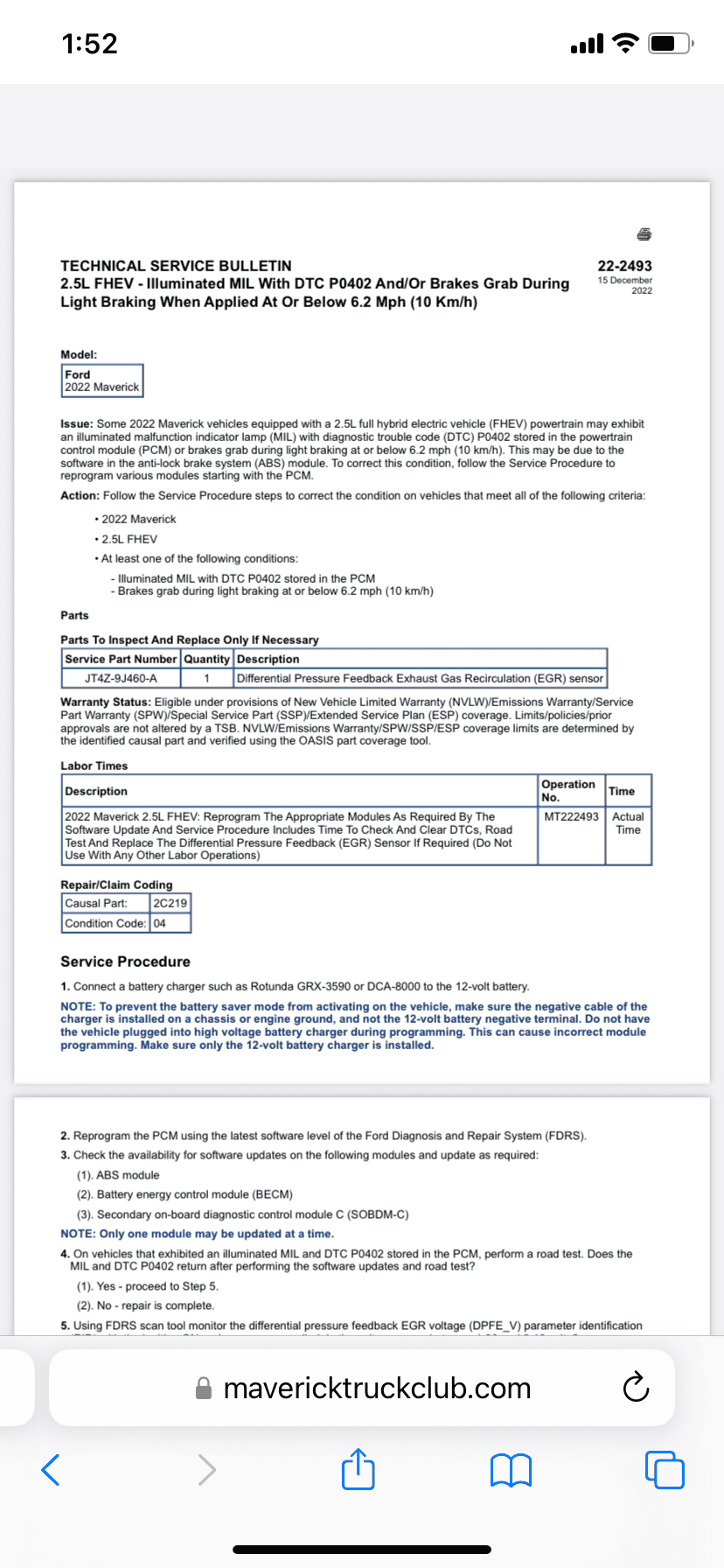

It's the latter half of December.
Software fixes should be rolling out soon.
I'm keeping expectations in check.
I'm expecting an improvement.
I'm not expecting the problem to go away entirely. Would be nice if it did but it's a pretty tough problem to eliminate. Lots of variables including wet, damp, dew, cold, rust, in addition to infinite road conditions and driver inputs.
Here's to hoping for the best in the next few weeks.
Looks like a fix is in…

Interesting they are lumping EGR sensor issues in with the ABS brakes reprogram on the same TSB. Twofer?

had the update done, definitely feels betters and doesnt grab as often but am still getting the issue from time to time but not as severe and able to quickly lighten pressure on the brake pedal if i feel like its about to grab.

I just made an appointment to have the update done. How long did it take? I'm hoping no more than an hour.

I had brought it in for a different warranty issue, and the SSM finally dropped the same day I was out to get the truck back, told them if they can update then please do so, if anything it was quick for sure.
