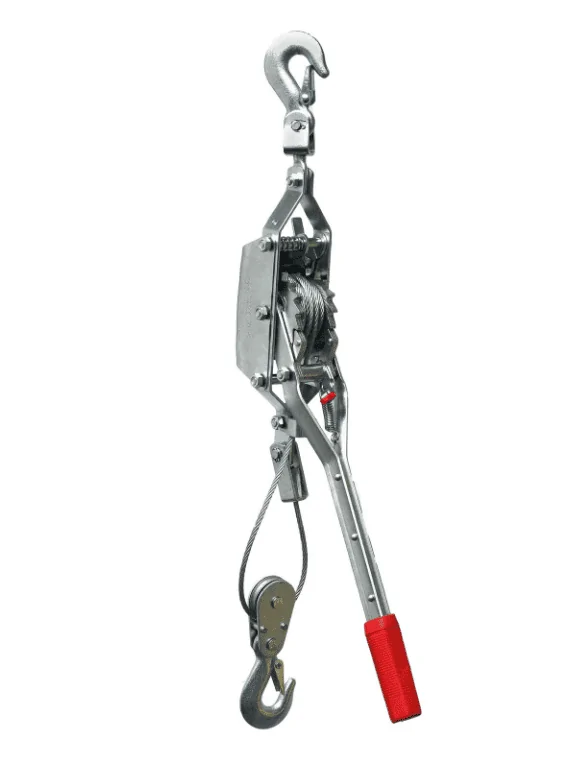

I've got a winch ready for my FX4 (when it arrives)!
Thats the good one too. Used em plenty of times. I've used hi lifts as winches as well. Probably not for the maverick though.

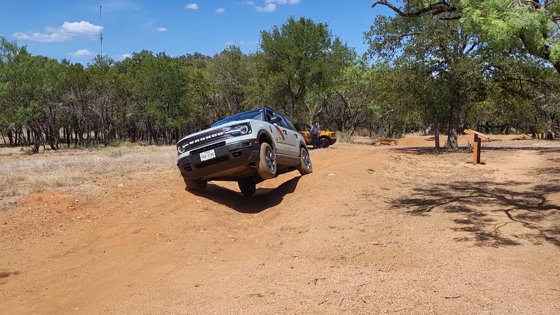

Just line by line.... dual clutch lockable rear - doesn't the Maverick already give power to all 4 wheels in most conditions under 20 or 30mph? You don't need to lock the AWD, it's already on!
The mav AWD uses brake vectoring, meaning that when it senses wheel slip on the open differential on a certain wheel it will apply the brakes to send power back to the other wheel. It is pretty smart and will handle anything on the road just fine. Off road its does pretty good too but there are limitations to what the computer can do and what brake vectoring can do.
The twin clutch setup acts just like a true locking rear differential in application. Each rear wheel has its own clutch that you can tell to lock fully that way both wheels are getting full power with near zero spin or slip and this makes all the difference at times. the clutches can over heat but that takes some serious abuse and generally cools down very quickly.
The twin clutch is a enormous upgrade to off road potential by itself. on the mavs long wheel base and giving up 4k? Pass. Not worth it imo and I would get a BS Badlands if you want the ultimate Ford Softroader.
Source: Me as I got to Take a BS Badlands with all the Off roads gadgets and put it through all its paces this summer.
