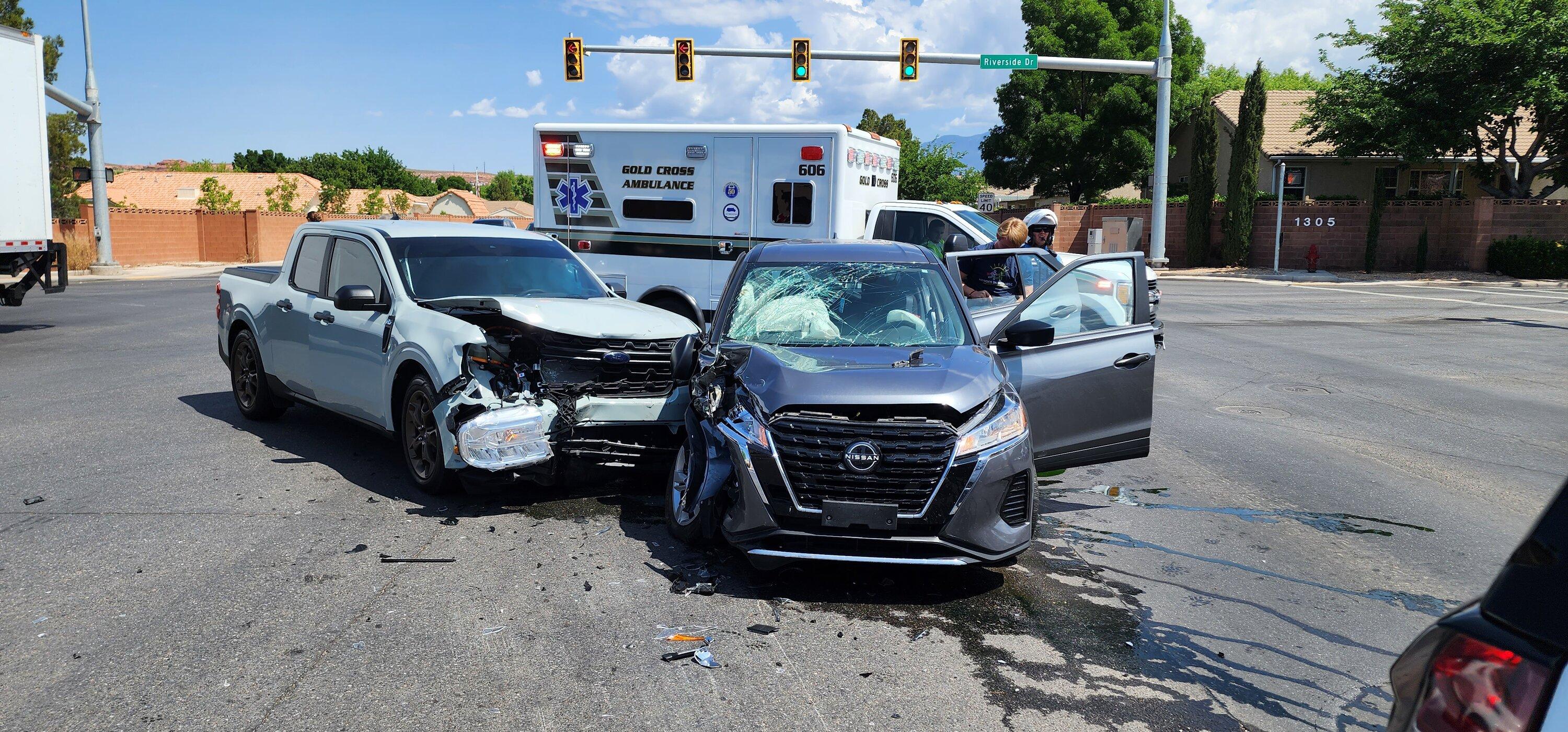

Sadly, it ended abruptly May 19th when a lady in an oncoming lane turned left in front of me. She was cited, my truck was totalled.
Insert countless swear words here.
I sustained injuries to my ribs and lower back. Still getting treatment, still sore.

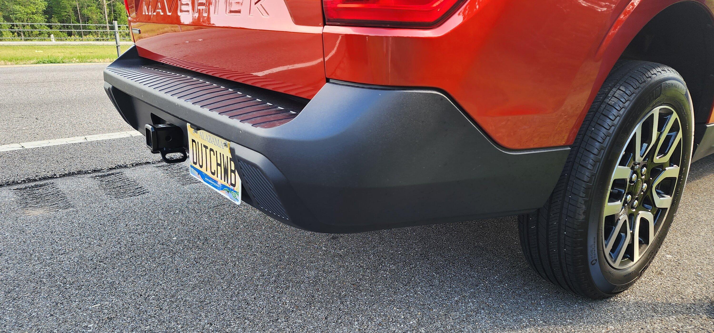

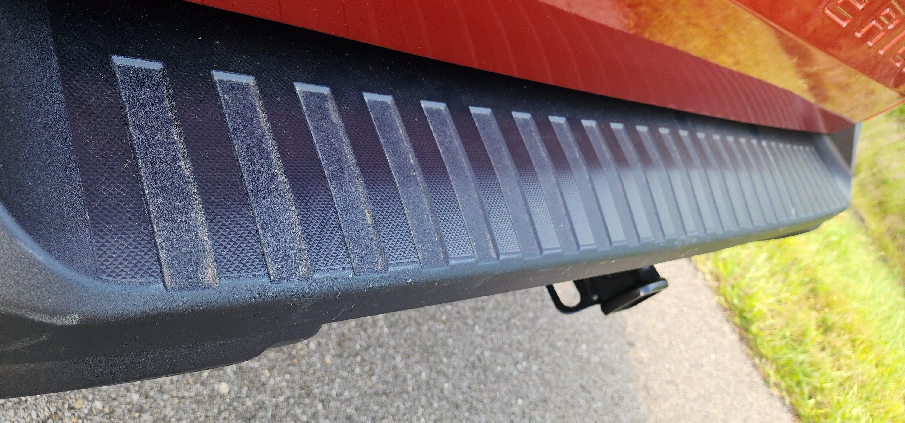

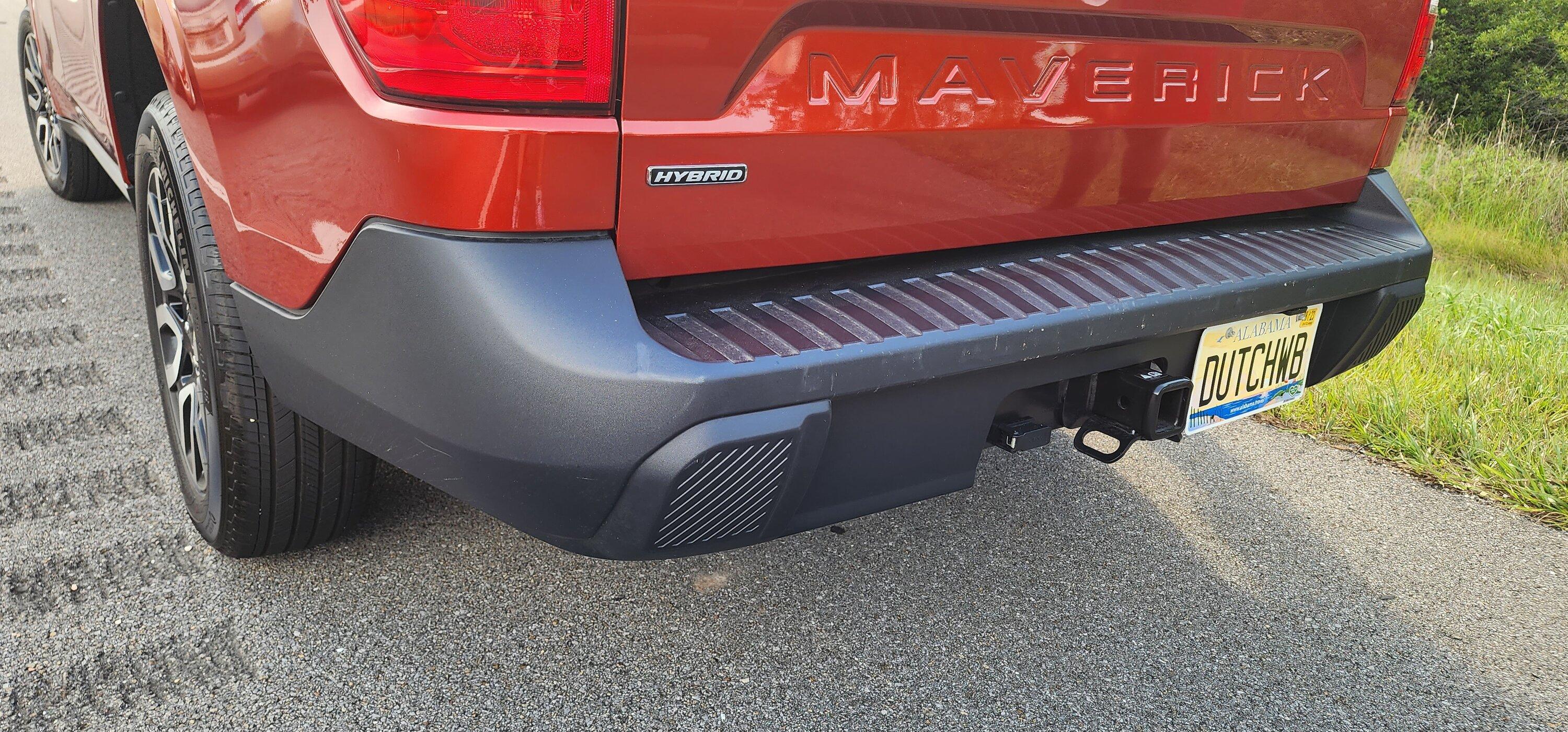

Less than an hour into the trip I was rear ended. Yeah, seriously. Nicest gentleman you could ever hope to meet, but my NEW Maverick with less than 1500 miles took a hit.
The bumper was creased and scuffed, and smacked the bottom of the tailgate leaving scratches in the paint.

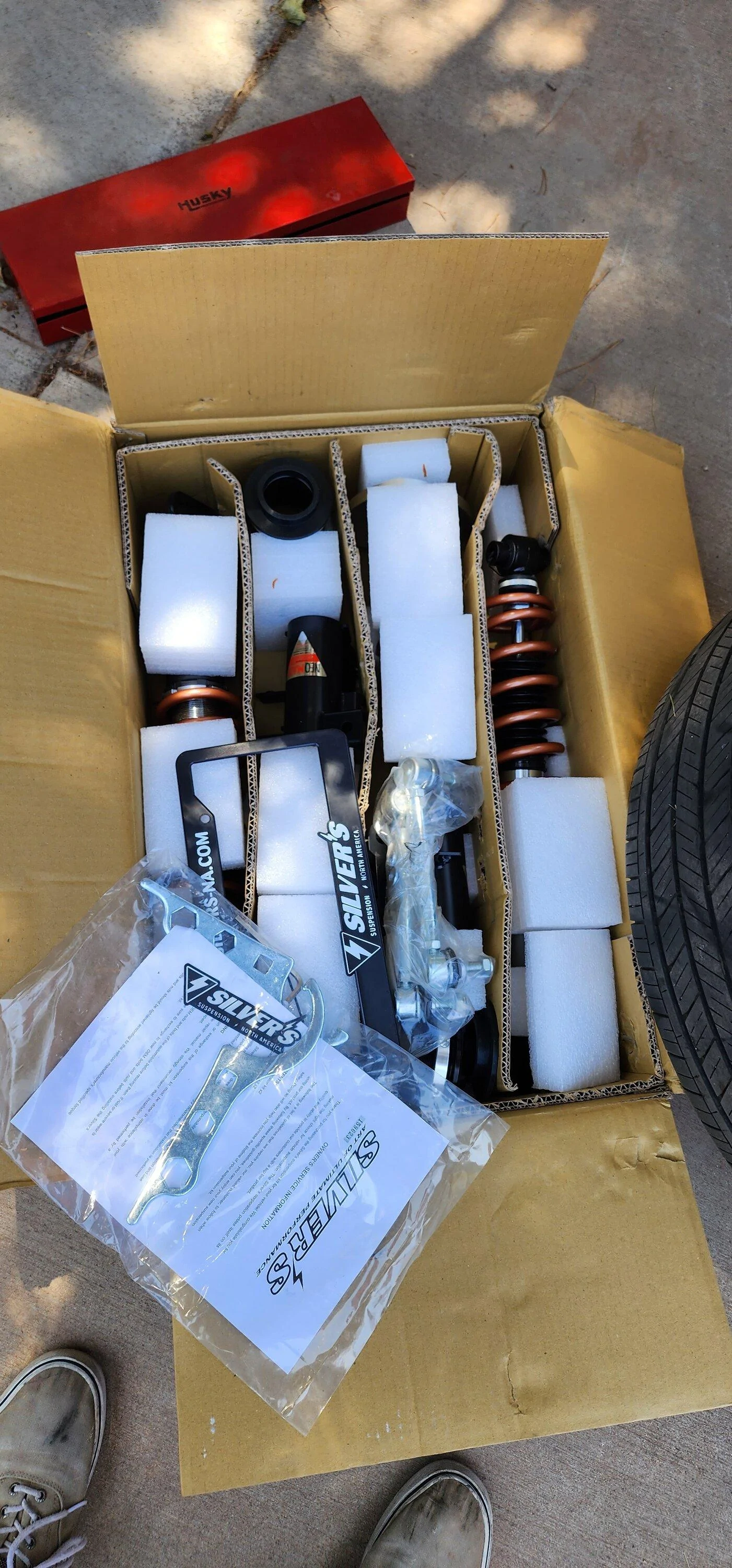

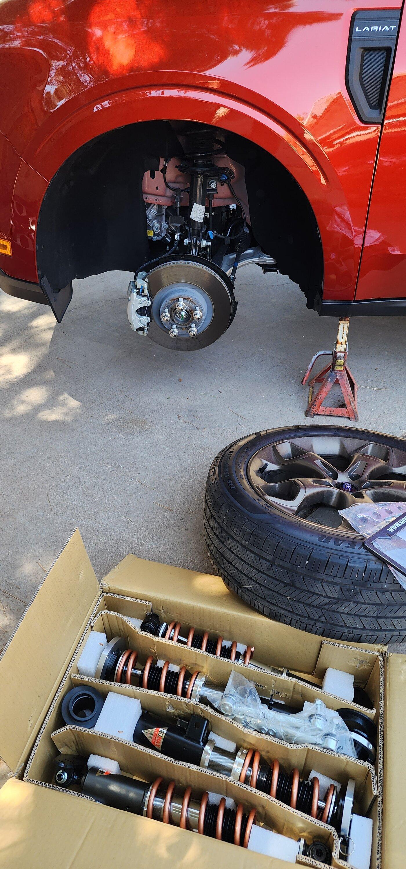

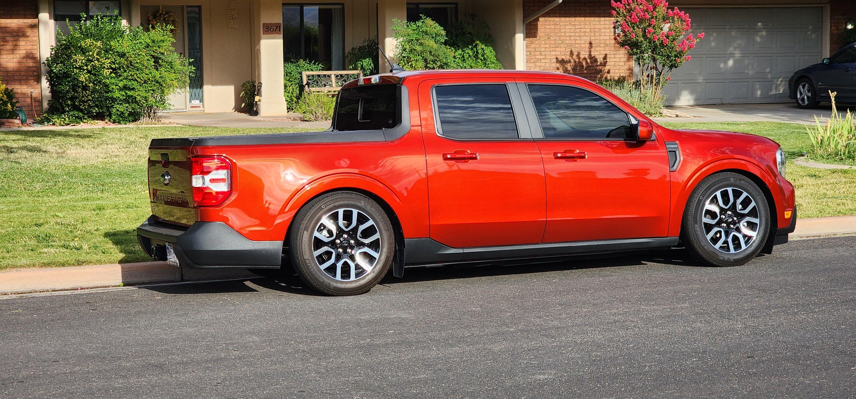

But the BIG thing I was waiting for was the Silvers coilovers. I ordered shortly after I got this truck home and excitedly awaited delivery.
Color coordination is important.
I tore right in and I can't begin to tell you what a QUALITY product Silvers makes! Wow! Excellent design and fabrication throughout!
If you've never done suspension work before I can imagine this could be a bit of a daunting task. There are no instructions but it's pretty self explanatory. Even with all of the suspension work I've done I got stuck on a silly thing and Silvers support was more than happy to help.

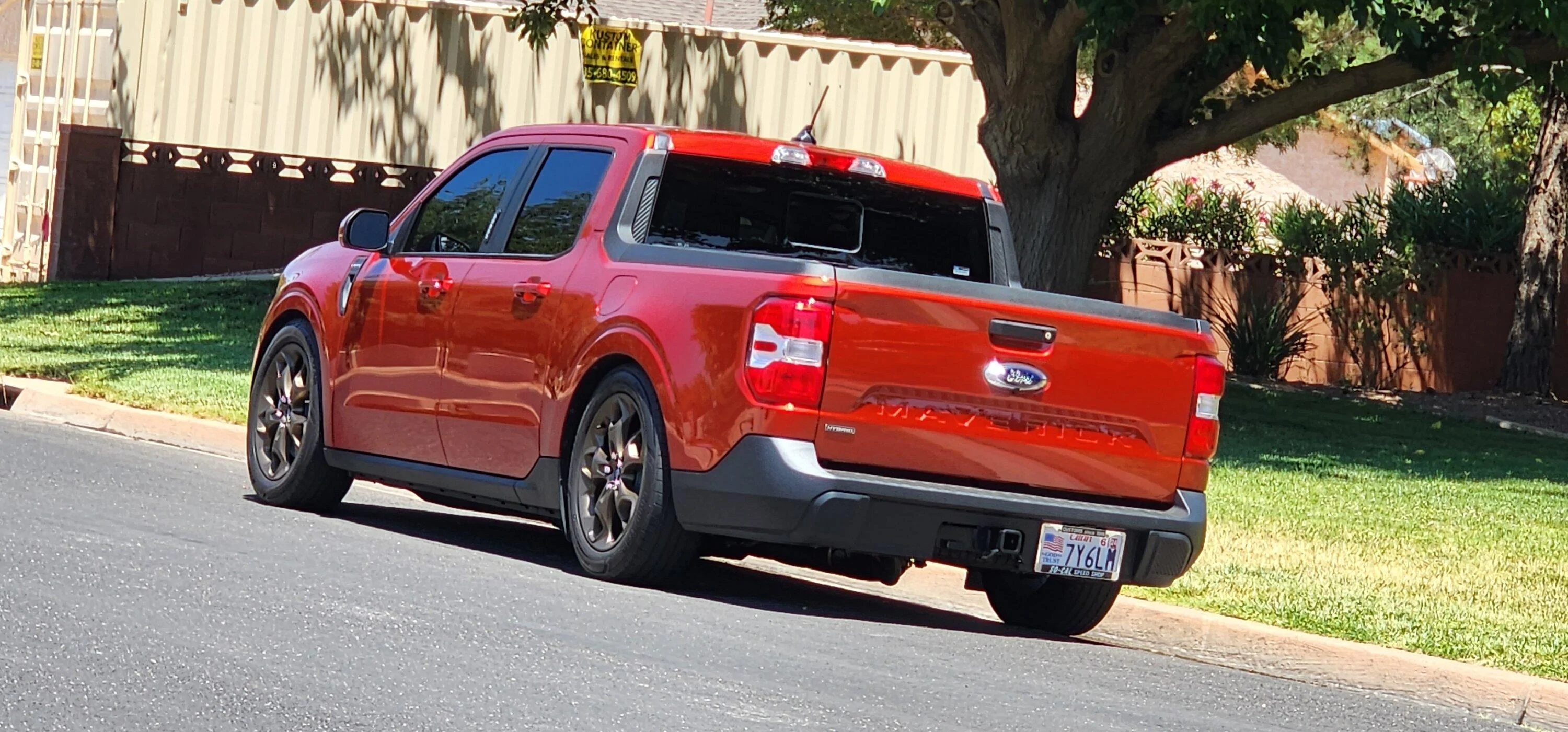

Y'all are going to ask the same question so let me answer it now - it rides nice. Firm, but nice. Not harsh, not hard, not bouncy, firm like a performance car which is exactly what a reputable coilover company SHOULD feel like. It actually rides similar to my HEMI Challenger with Super Track Pack.
It's a tradeoff that you may not be willing to make. My Eibachs on my Cactis Gray truck rode EXCELLENT, just like stock. They just weren't low enough for my liking and a compromise I was willing to make.
The ride quality is due largely to the work that Lawrence Giles put in with Silvers to nail down the correct spring rates! If you're considering Silvers ask for the "Lawrence Giles" @2016BoostedGreyGoose package. They'll know!

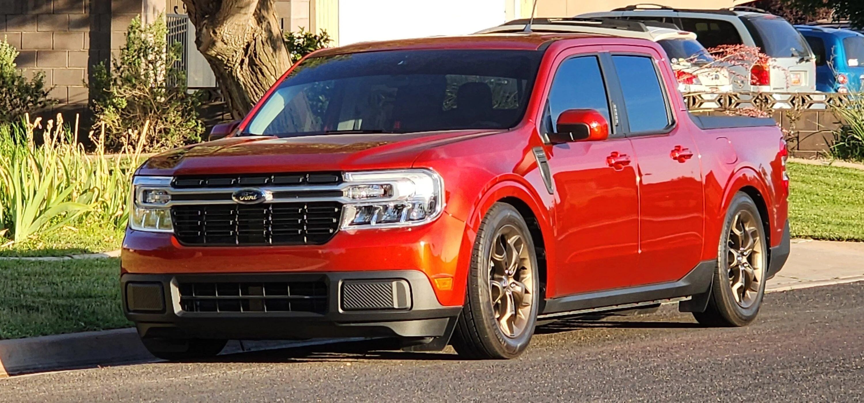

Also, this ISN'T the "low" package, it's the "standard" package. It's plenty low enough for me, although I need to start trimming my inner fender plastics because they rub.
I'm also going to go from my current 235/55R19's to 235/50R19's to minimize rubbing where I can. I may also go to 20's or 22's if I can find wheels I like more than the Escape wheels I had powder coated bronze. We'll see.
I still need to dial in the suspension a bit, maybe adjust ride height a touch, adjust dampening, etc. Once I'm happy with that I'll get the alignment done.

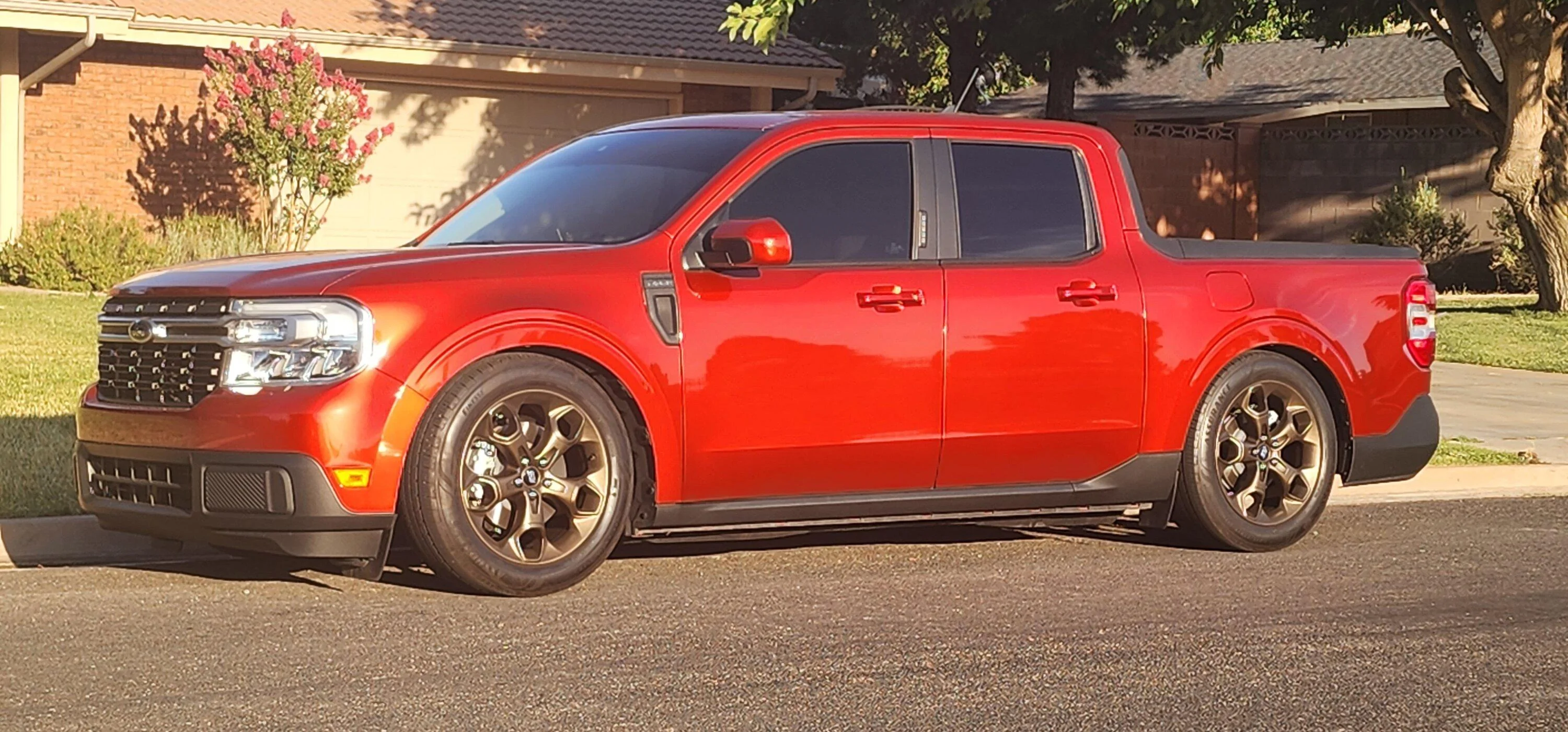

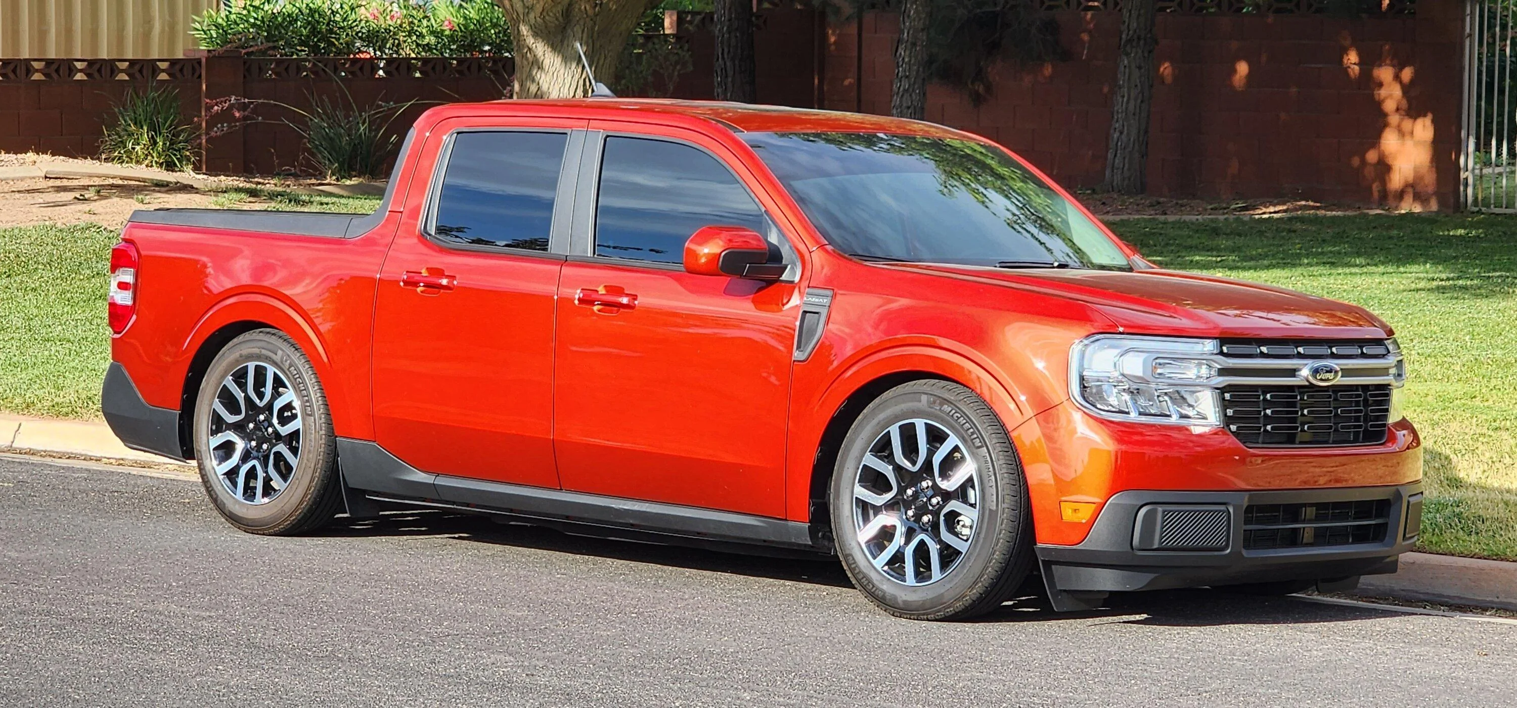

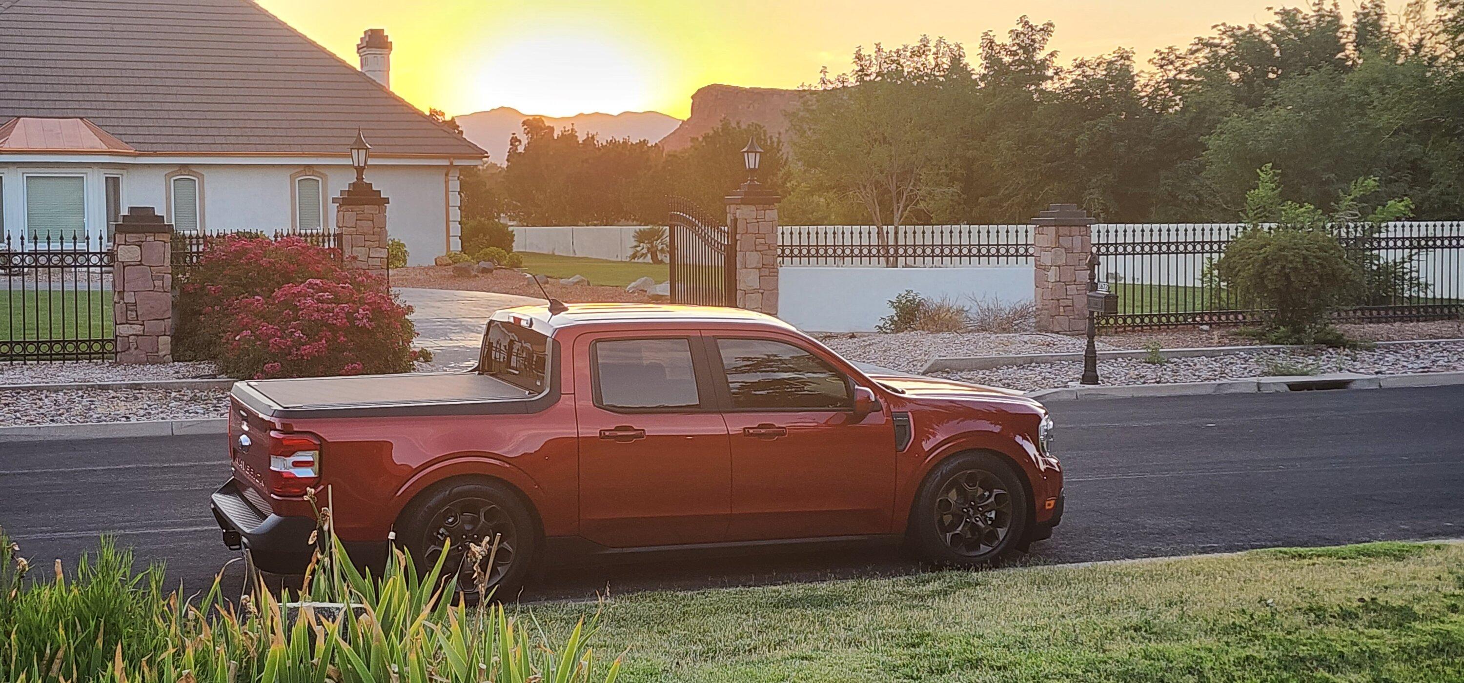

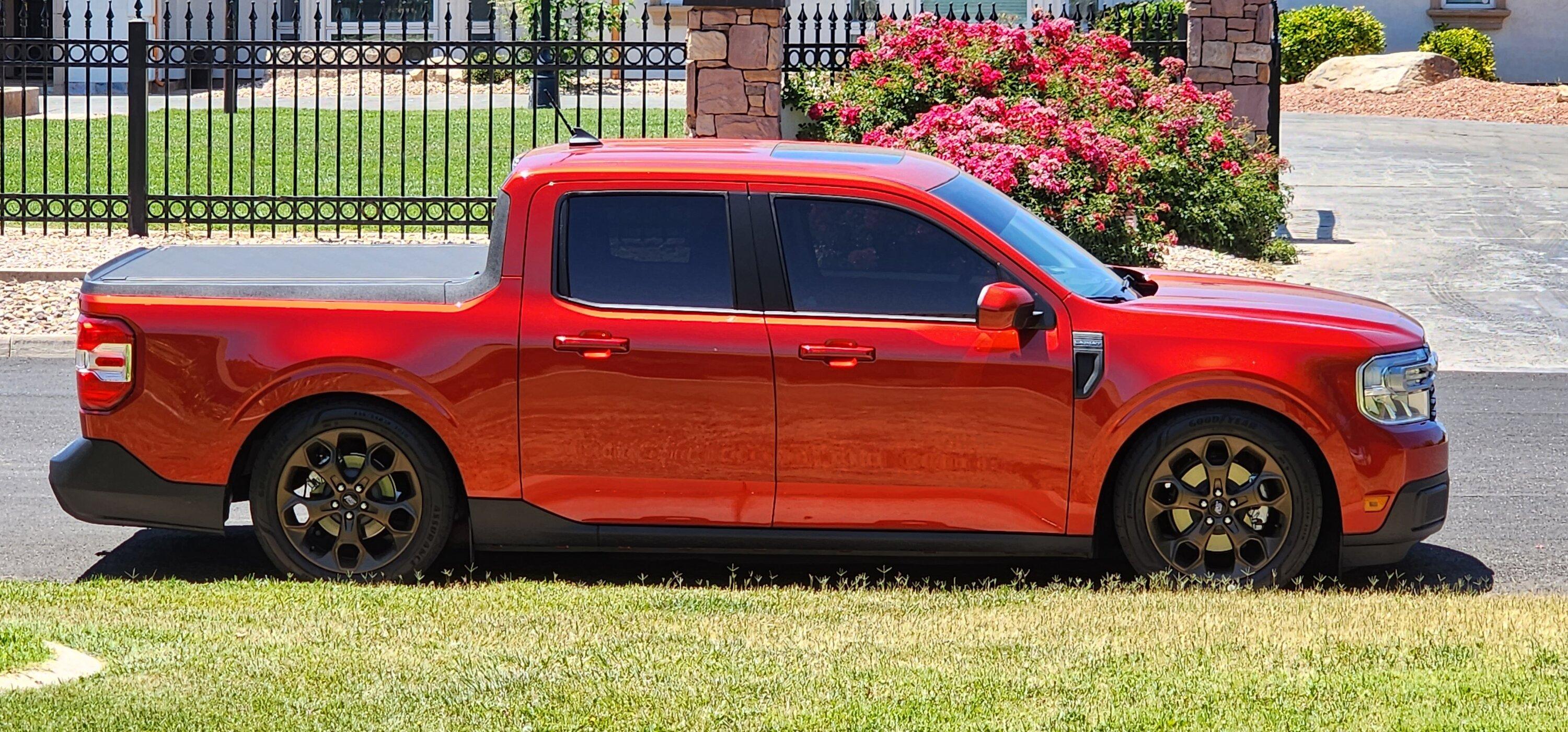

Here are a few photos of it lowered with the stock Lariat wheels.
Really glad I was able to save my Escape wheels from the Cactus Gray Maverick and that they weren't damaged. Really LOVING the bronze against the Hot Pepper Red.
