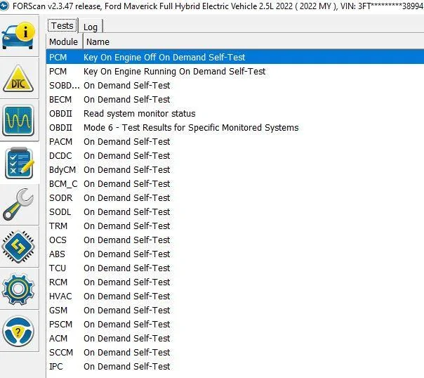

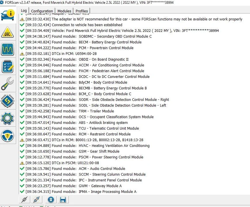

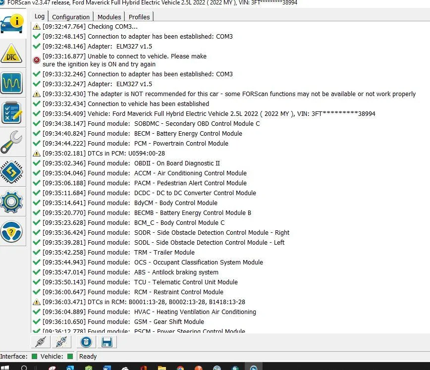

Hybrid xl with tow hitch and
Ford Maverick Forscan information gathering thread forscan modules
Ford Maverick Forscan information gathering thread forscanlog
Ford Maverick Forscan information gathering thread Forscanlog1

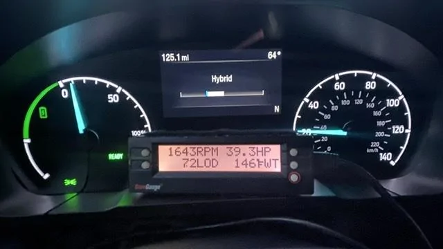

Where are we in this project?
I would just like to view some parameters in my XLT Hybrid, such as battery temperature, electric motor temperature, and eCVT temperature.
Do we know the hexadecimal addresses for these things? Also battery percent of change. Can I just view these? I have a simple tool, but need the hex codes.
Thanks.

That's a good point. Most everyone so far is looking at the AsBuilt values. The PIDs that give the current status of the vehicle are completely separate.

I'm hearing about Forscan for the first time. Also looking into TorquePro. But how do we get the PID's (parameter ID's) to show temperatures, pressures, and voltages?

Someone has to reverse engineer the commands on the vehicles CAN bus. Ford does not publish the PID values. I have a PID list for my 2010 Fusion Hybrid but the 2022/2023 Mav are probably much different.
