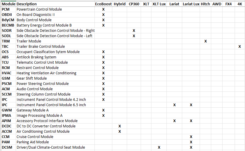

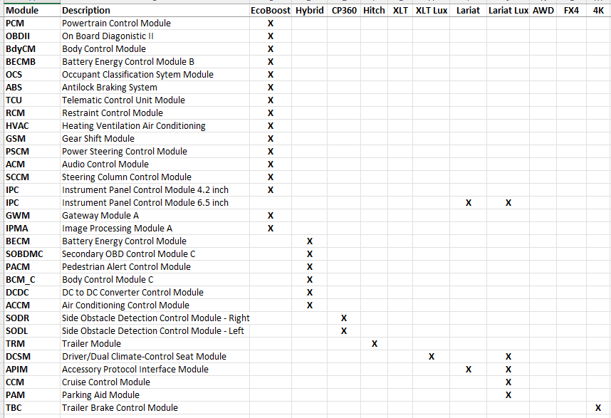

This is what I have so far. Some of this are guesses since only one FORScan log has been posted. It would be great if someone can post a Hybrid and a Lariat LuxThanks for posting this. I can see you have an EB. Your profile says XLT and it looks like from the TRM module, you have to 4K tow package. Is this right? Any other major options besides the FX4 (required for tow package)?
It would be good to develop a table of what modules come with which options. This will server a few purposes.
First it will help us understand the build constraints better to know which modules (and therefore chips) come with which options.
Second, for anyone that wants to try and user upgrade their Mav to a higher option level will know which modules they need to purchase.
If everyone can post a similar FORScan screenshot and their major options we can fill out the table.
Yes, I think you are right on the trailer module.Trailer module a guess for hitch and 4K? Doesn’t make sense it’d have a module for just the hitch. 4K has the integrated brake controller which id assume what the module is for.

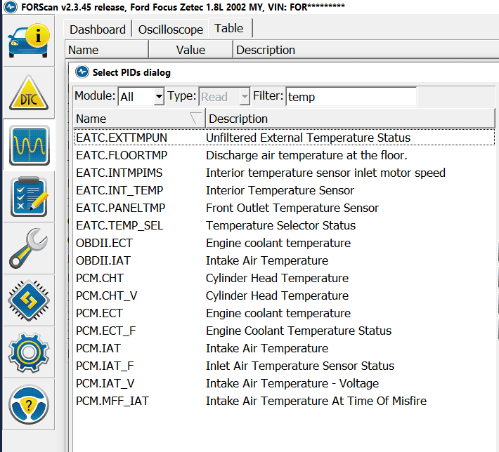

In my opinion, if you plan on using FORScan for troubleshooting your Mav, it is well worth it to upgrade to an adapter that can automatically switch between the MS-CAN and HS-CAN modules automatically rather than with the manual switch on the cheaper adapters.This Forscan Cable works great and it's cheap as F#@%

With the manual switch adapters you can't looks at values from modules on two different data busses at the same time such as looking at all the temperature sensors in your vehicle at the same time so check which ones seem to deviate from all the others.
