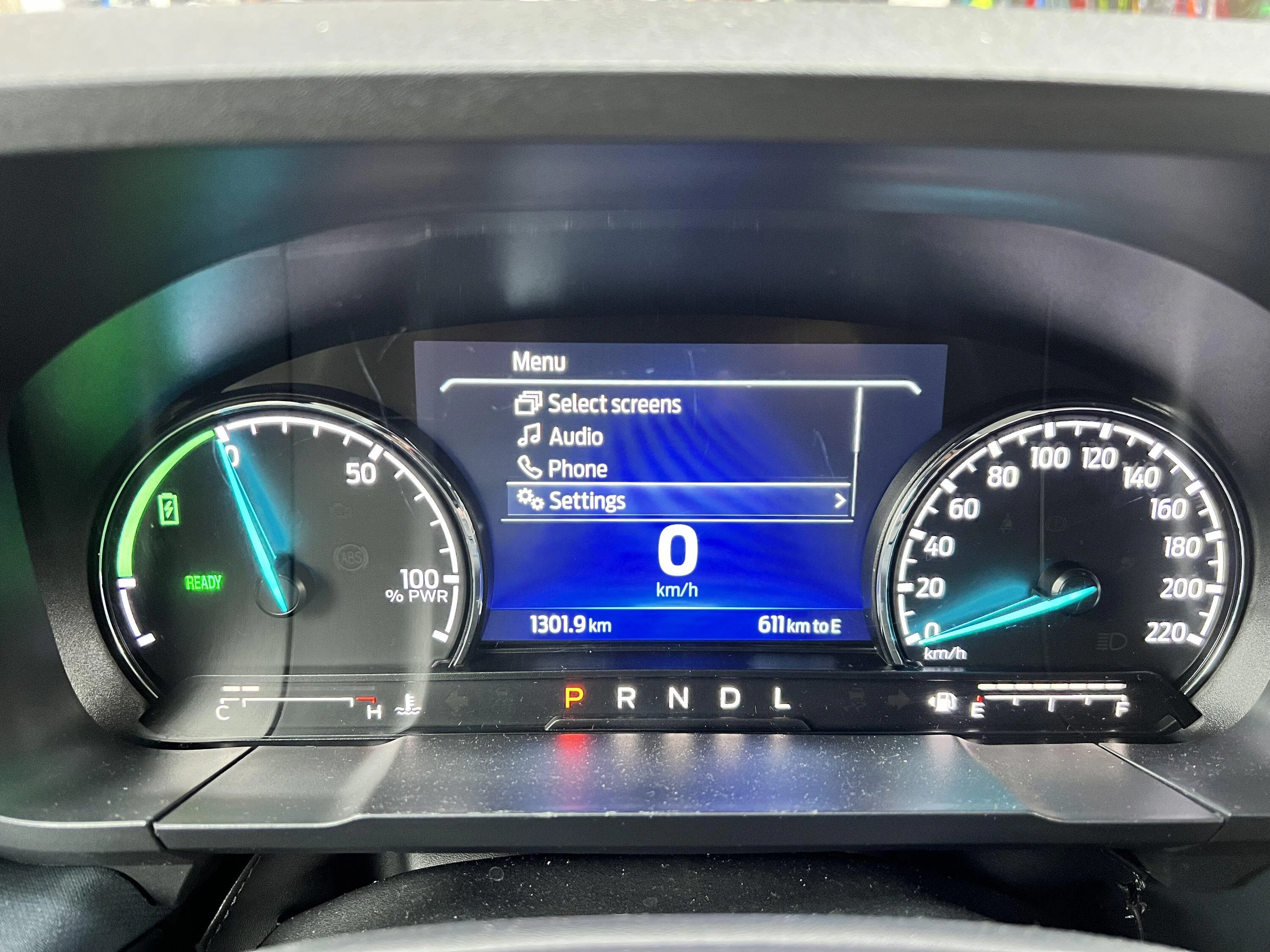

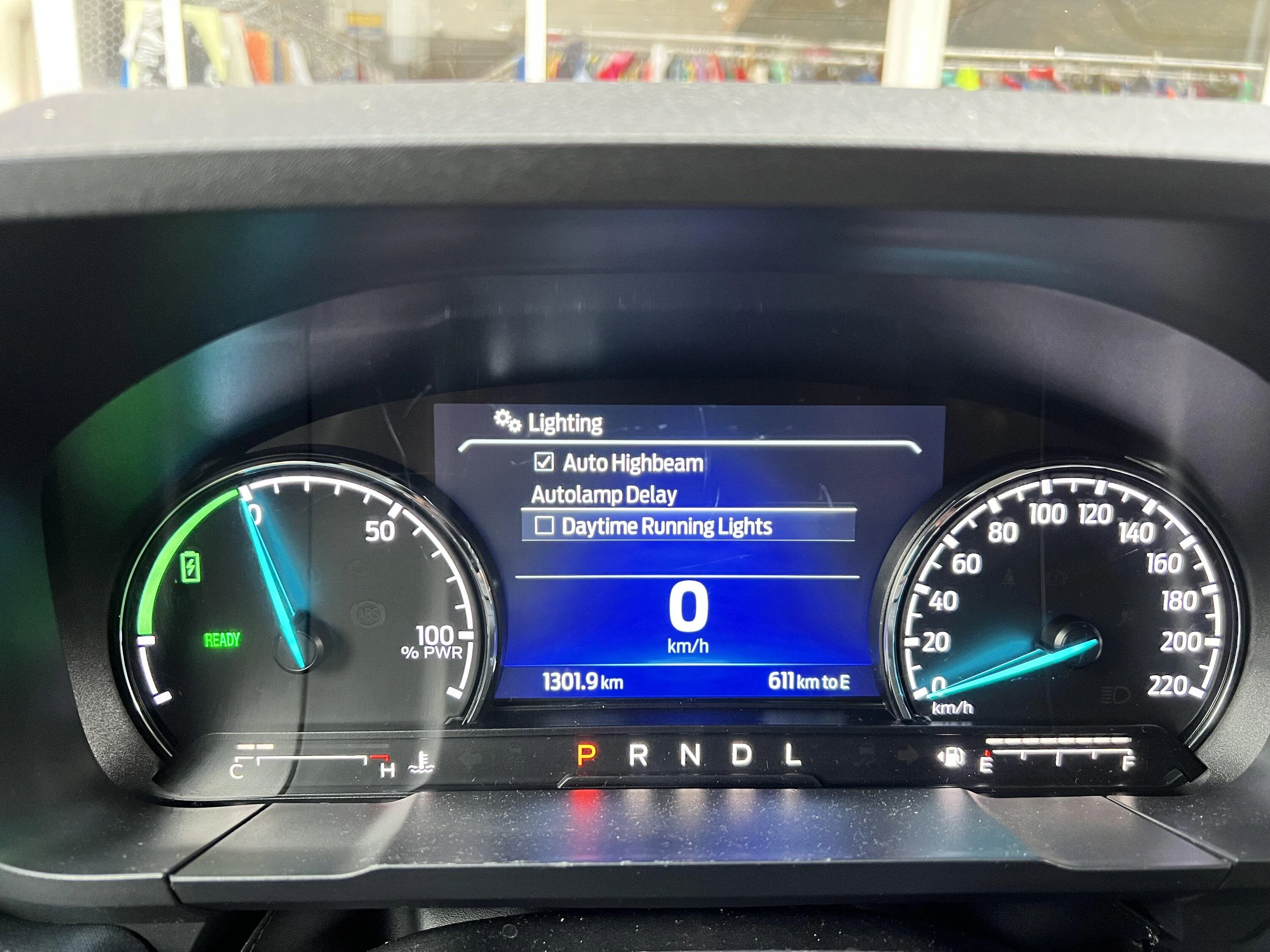

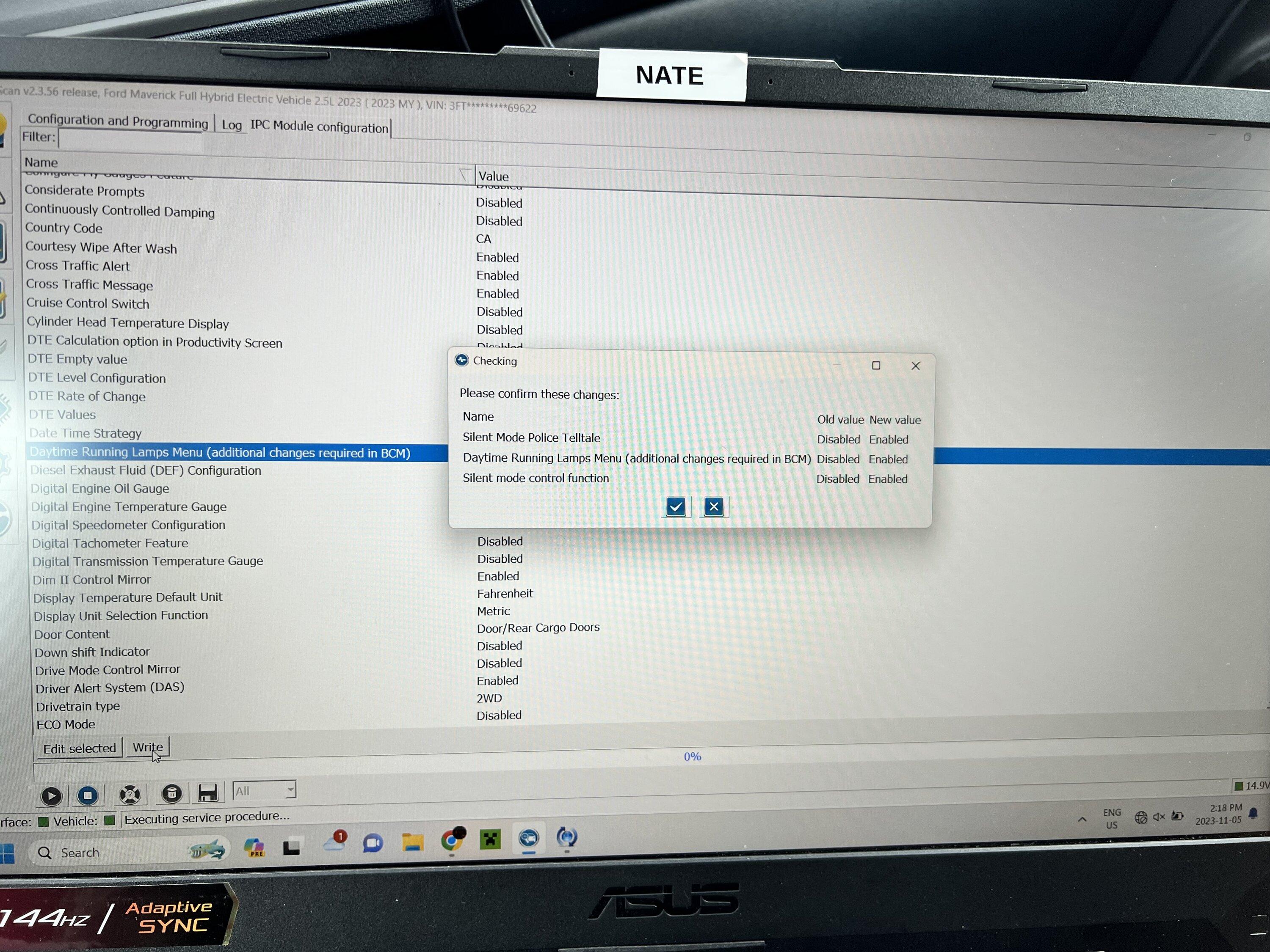

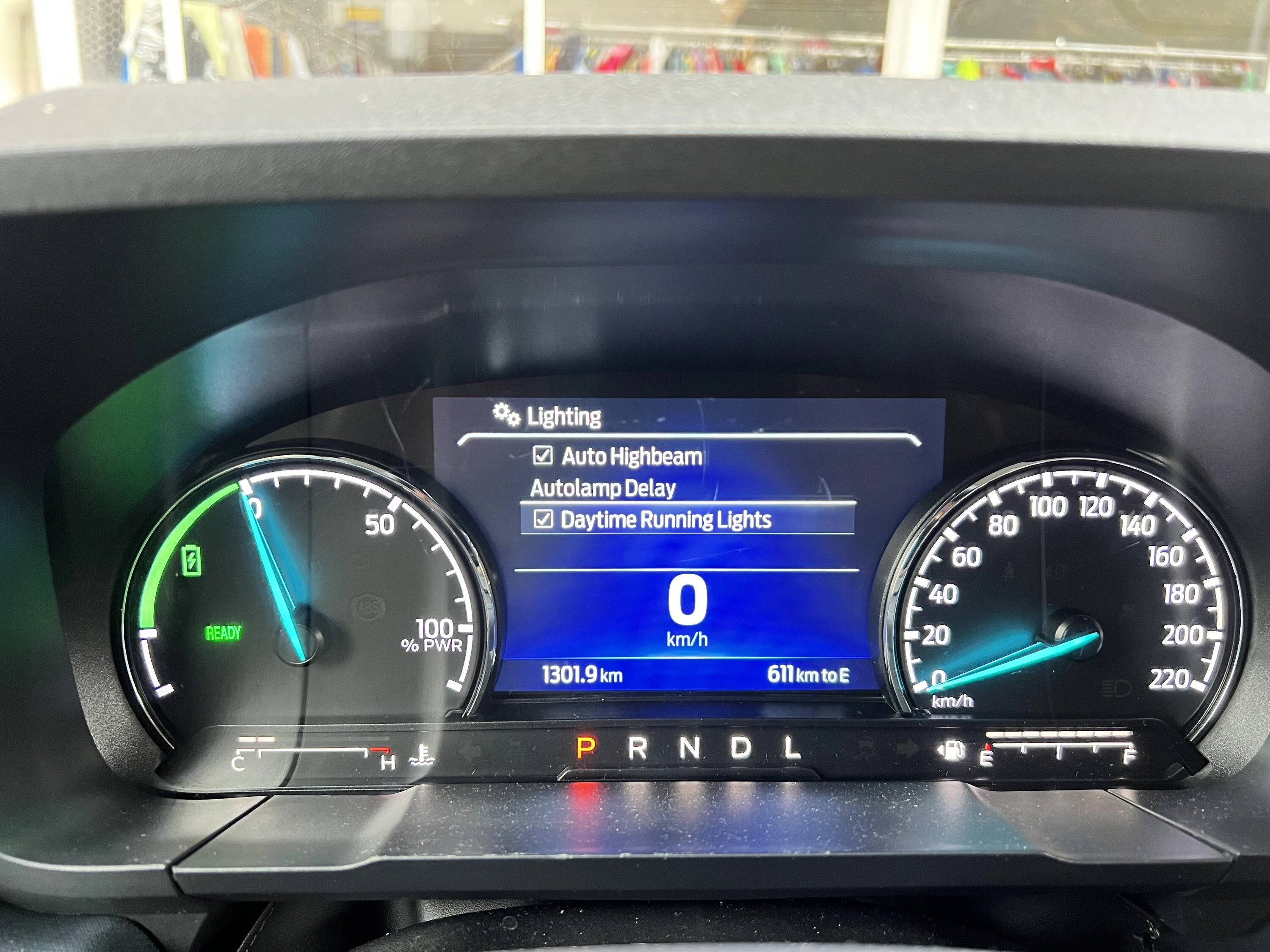

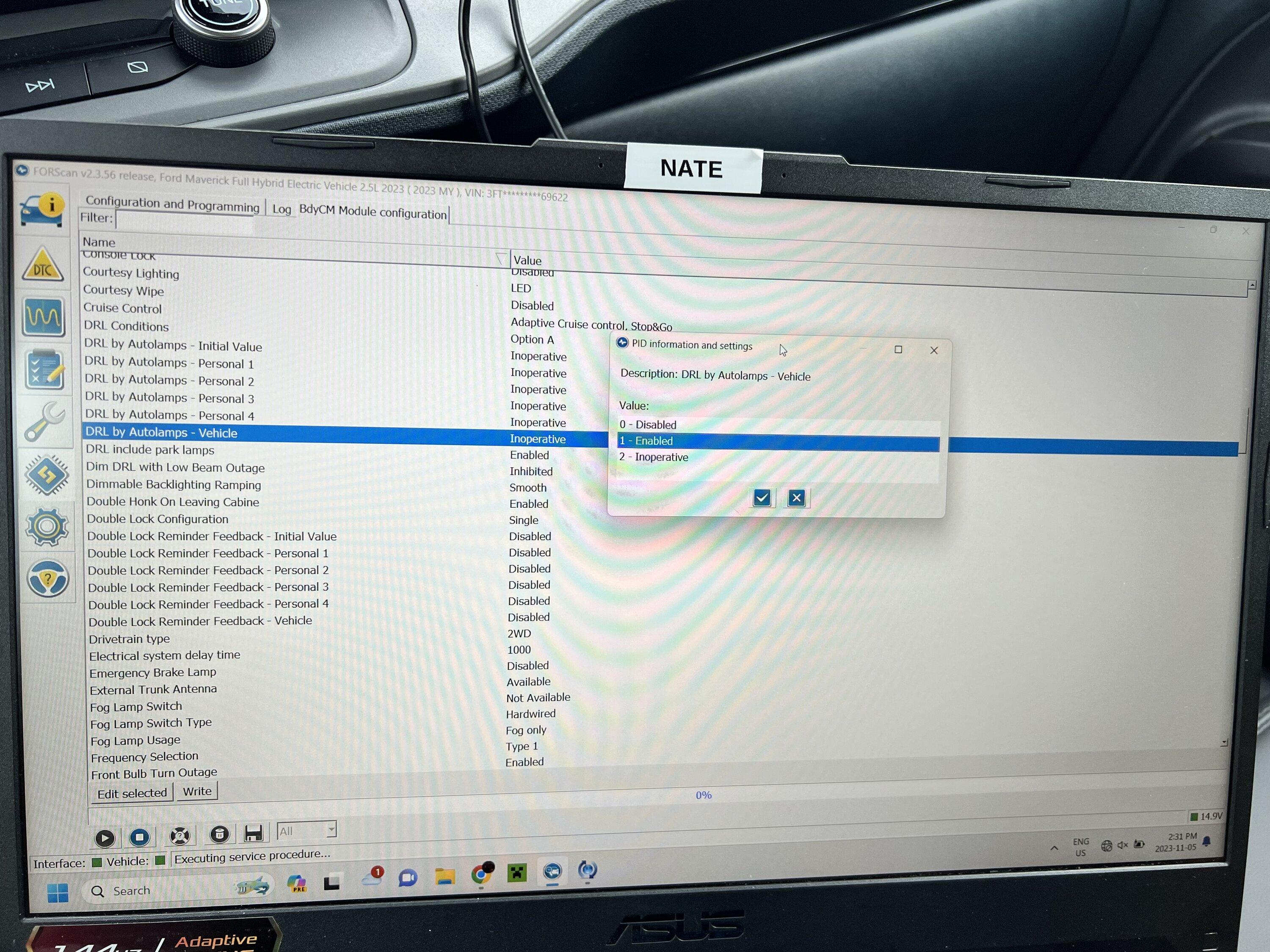

In IPC module enable daytime running lamps menu.

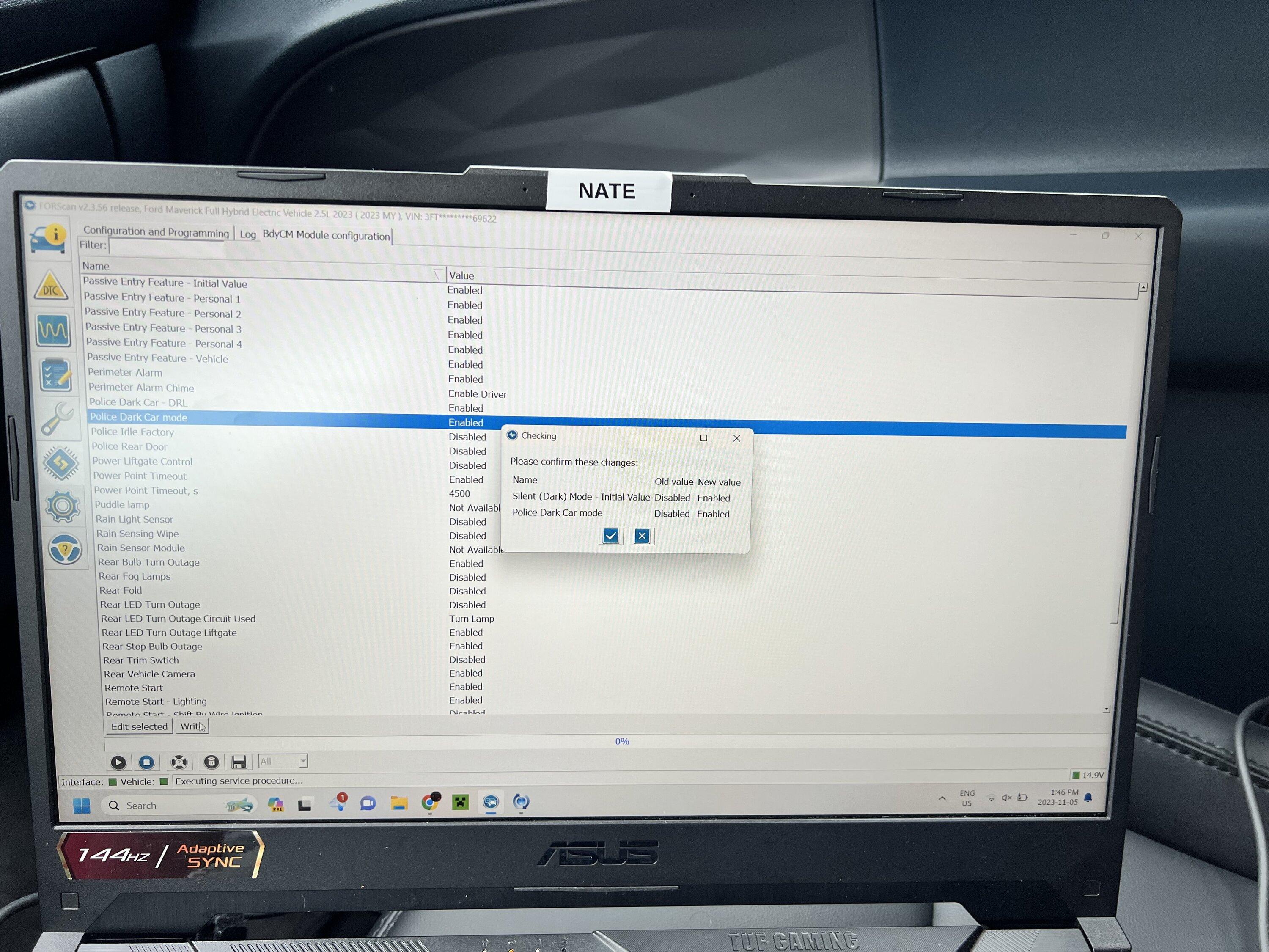

In BdyCM select DRL by Autolamps (vehicle) change from inoperative to enabled.
From the cluster menu select settings, vehicle, lighting, toggle Daytime running lights on or off.

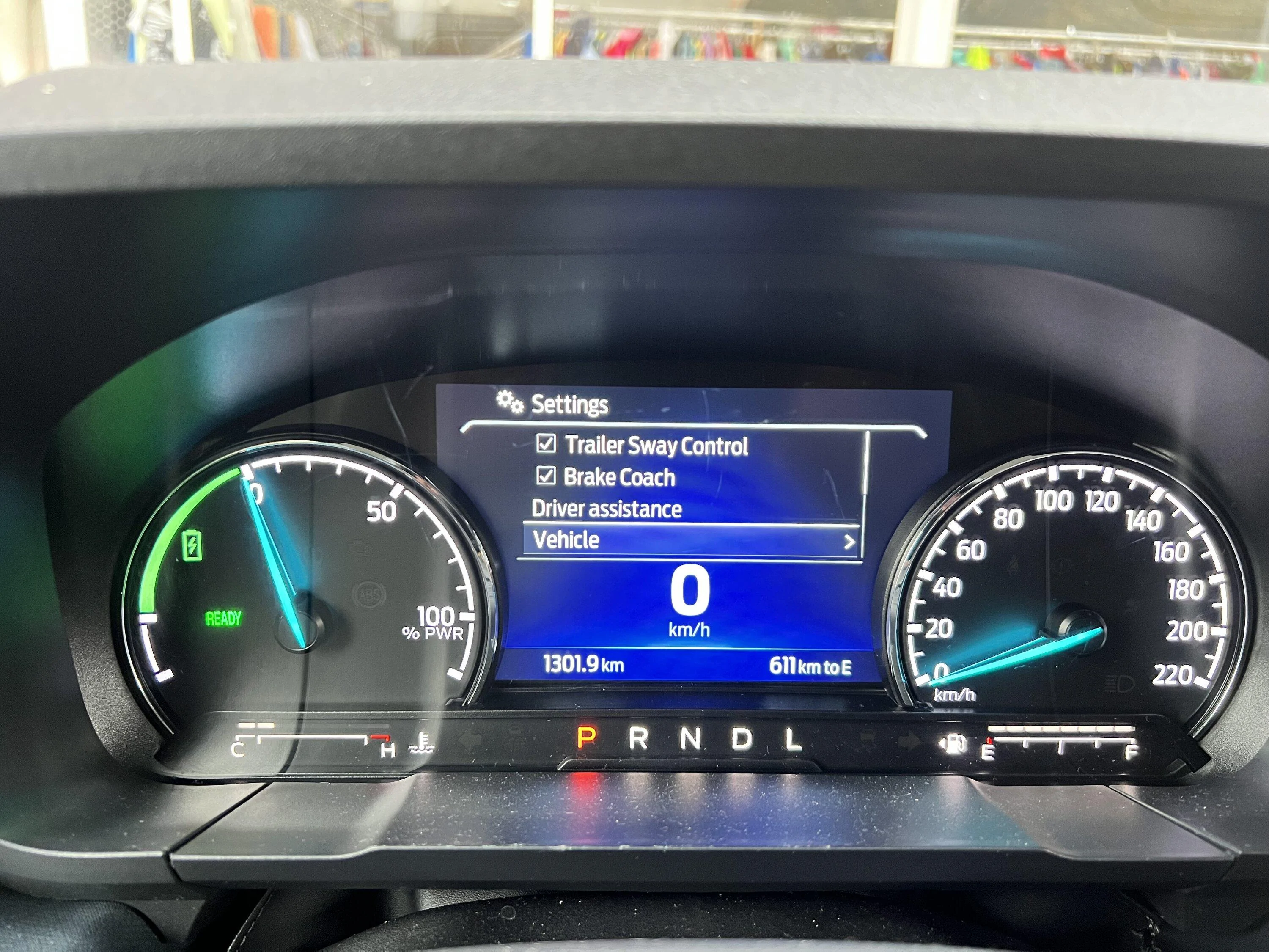

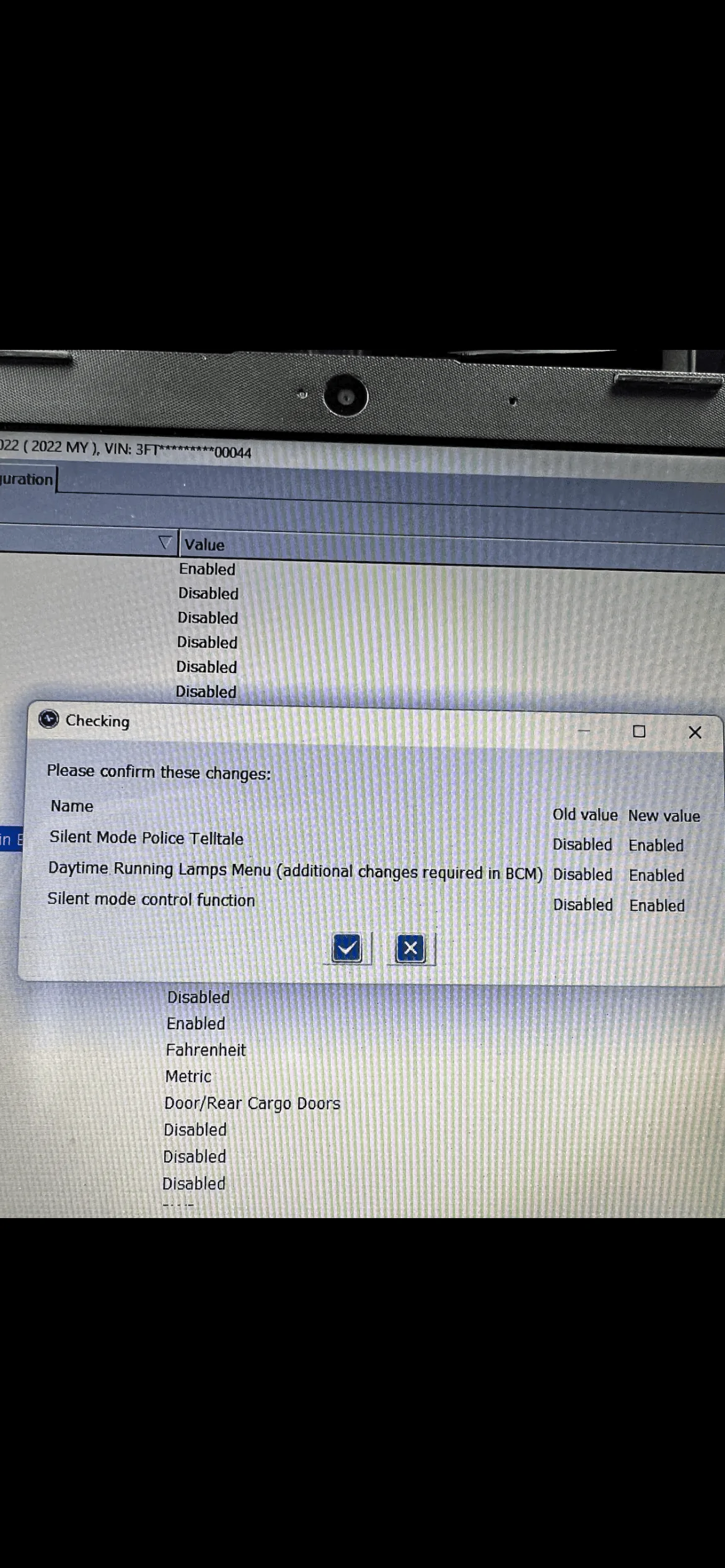

You can also enable silent mode, which disables the running lights, horn and turn signals when unlocking when parked. This also disables interior lights when doors are opened. Good for camping etc.
From IPC module enable Silent mode police telltale and silent mode control function.
From BdyCM enable Silent (Dark) mode
From the cluster menu select settings, vehicle. Toggle silent mode on or off.

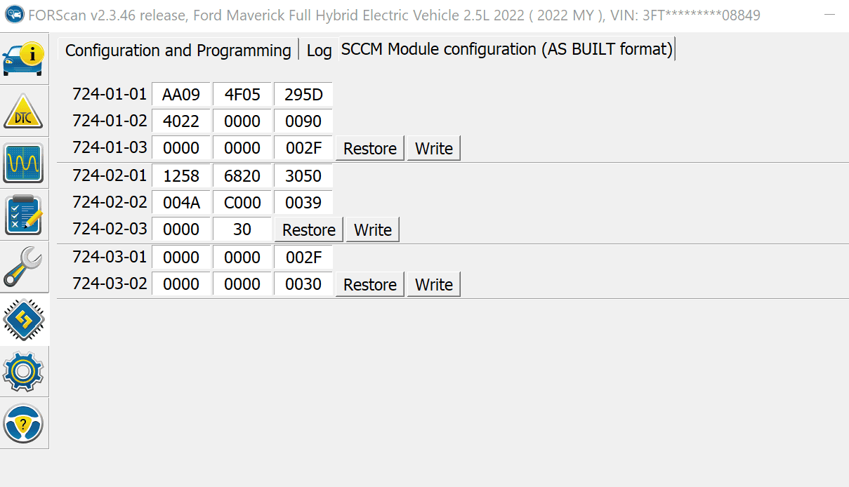

Has anyone been able to modify the number of turn signals that flash when you push the stalk halfway? It's a very popular mod to increase it from the default 3 flashes (which I feel is not enough to change lanes) to 5 or any other amount. It's well documented for F150s, Escapes, etc but the menu looks completely different on the Maverick.
Normal instructions: Forscan ford f150 turn signal mod to increase blink - YouTube
Maverick's SCCM screen:
As you can see the 724-01-01 block is completely different on the Maverick compared to other Ford products. The only other example of this I could find is from the 2020 Explorer, which someone said is apparently impossible to modify the turn signal duration on ( 2020 Explorer lane change turn signal flashes - FORScan forum ). I'm wondering if someone more knowledgeable than me is able to confirm?
Another great mod that should be able to be done since these features are driven by configed values.
Unfortunately looking at this, it in Hex and not knowing what each lines does I have no idea what to change.
