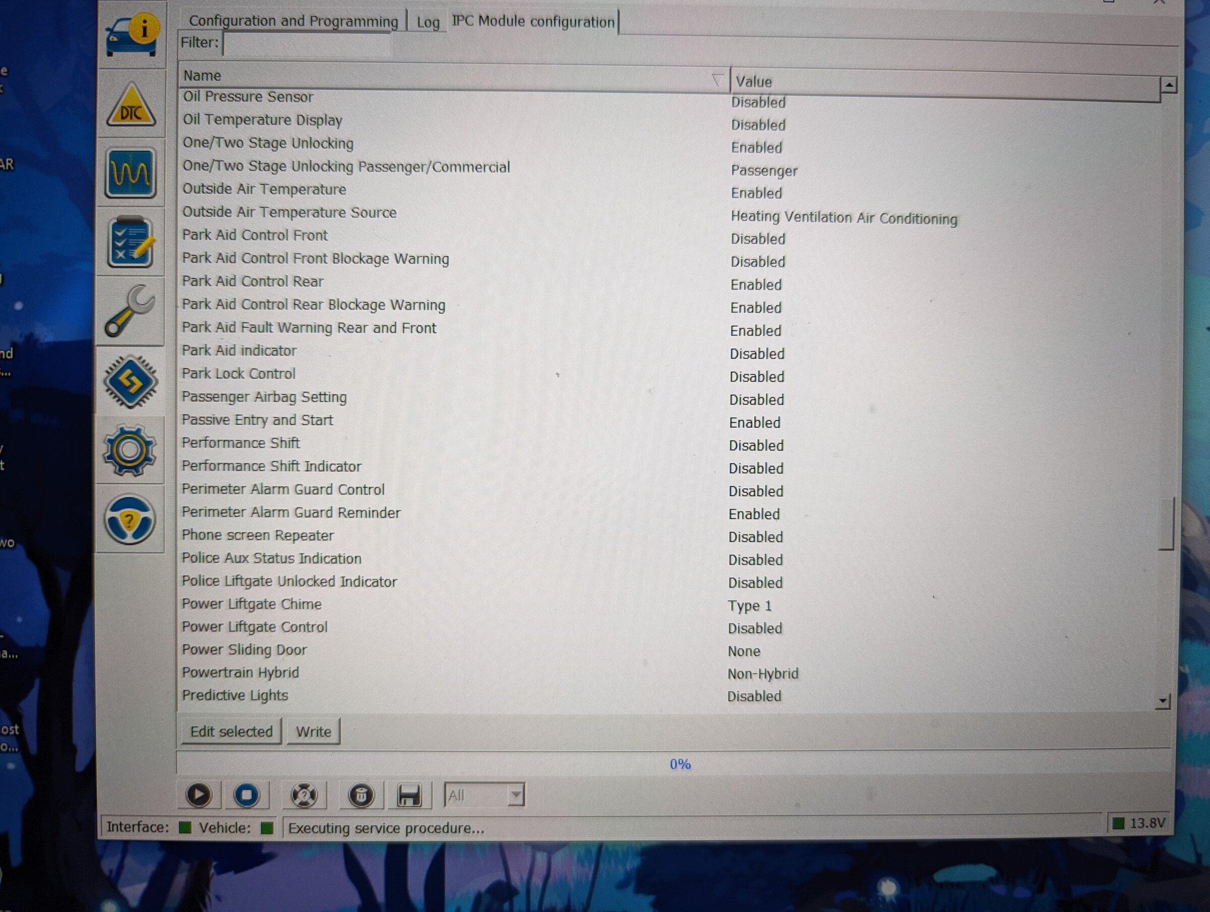

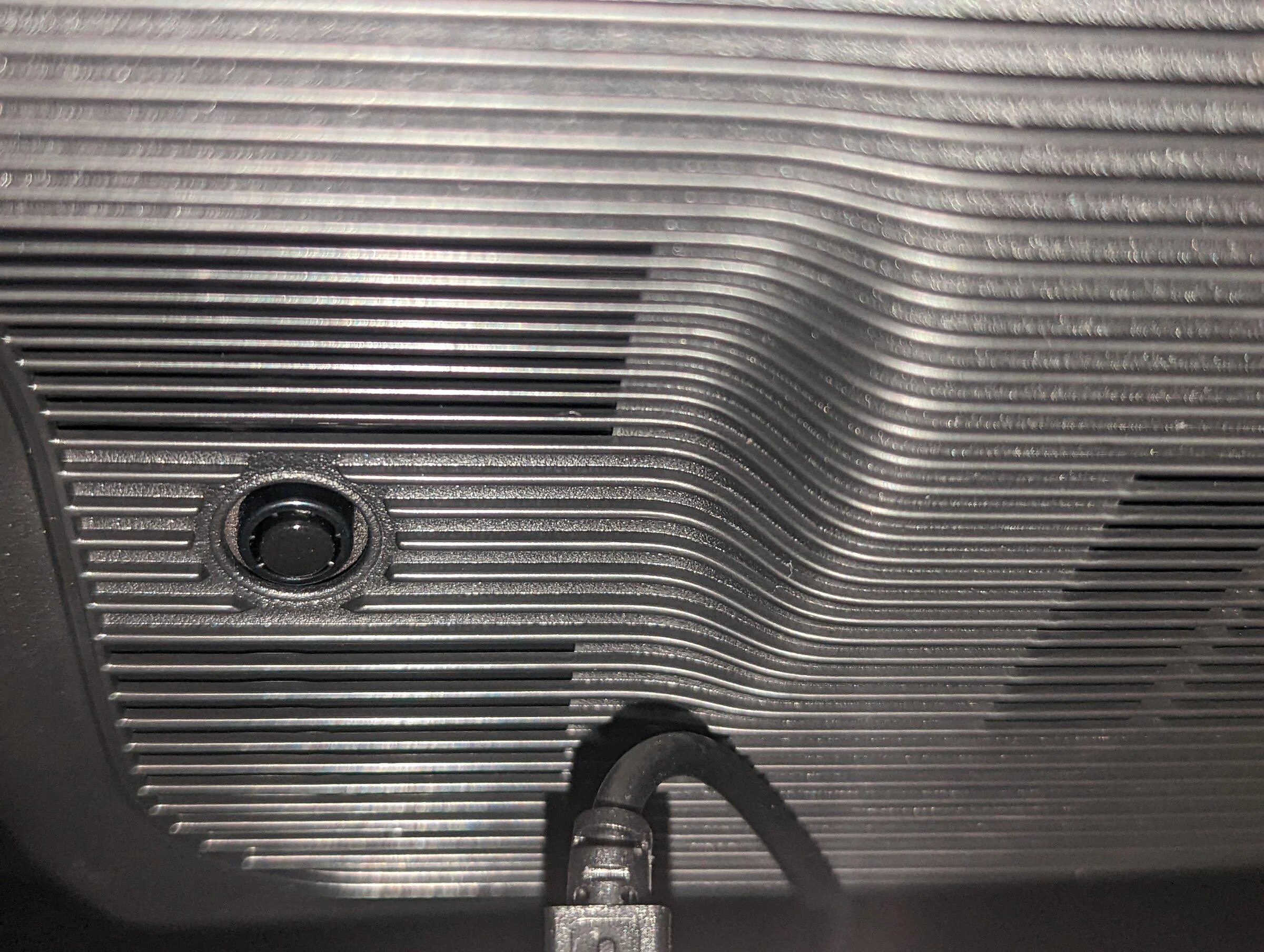

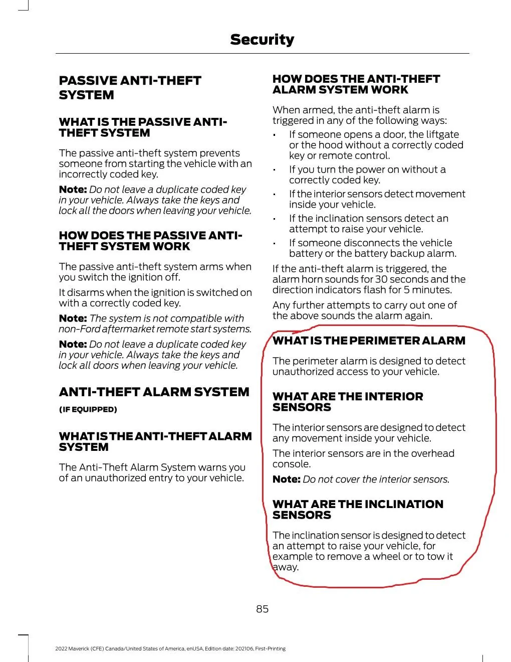

I enabled Perimeter Alarm Guard control in the IPC Module. The XLT and Lariat are supposed to have interior sensor motion alarm as part of the Perimeter alarm, per page 85 of the manual.
These do not work on my Lariat, nor have I seen mention of anyone whose truck has this working. Setting the alarm and waving inside the cab with windows down should set off the alarm.
I have started a thread on this, but no one else seems to care that this feature doesn't work. I asked my dealer and they weren't sure, but didn't think the Perimeter Plus addon alarm(shock sensor) was needed for this. They said I'd have to schedule an appointment and let them troubleshoot to see if/ how these sensors operated.

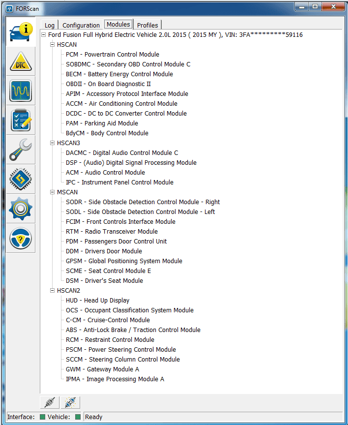

Can someone post a screenshot showing all the modules and which bus they are on, similar to the one below. Ideally it would be for a Hybrid Lariat Lux since it has the most modules.
