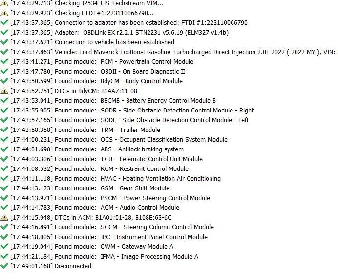

Count me in. XLT ECOBOOST FWD W/ COPILOT 360 and ForScan using OBDLink EX FORScan OBD Adapter.

Thanks for posting this. I can see you have an EB. Your profile says XLT and it looks like from the TRM module, you have to 4K tow package. Is this right? Any other major options besides the FX4 (required for tow package)?

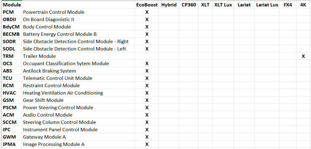

It would be good to develop a table of what modules come with which options. This will server a few purposes.
First it will help us understand the build constraints better to know which modules (and therefore chips) come with which options.
Second, for anyone that wants to try and user upgrade their Mav to a higher option level will know which modules they need to purchase.
I'm thinking the table will look something like this.
If everyone can post a similar ForScan screenshot and their major options we can fill out the table.

There is also an Accessory Protocol Interface Module (APIM) on the XLT and Lariat trims. The ones on the Lariat trim have the Sync 3 and the ones when equipped on the XLT don't have Sync 3.
