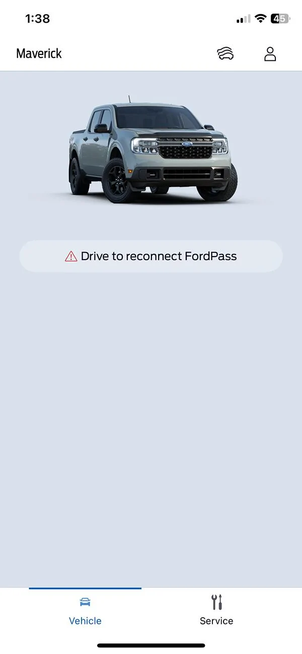

I have a 2024 Lariat Hybrid. I don't drive it much, 1600 miles in 6 months, so I occasionally charge the battery. Yesterday, even after fully charging the battery I drove it about 10 miles and as soon as I parked it my Ford Pass states "Vehicle In Battery Saver Mode" "Drive to reconnect Ford Pass." I have had the dealer check both the battery and charging system and they say everything is fine, just charge the battery as needed. My wife's Escape is driven even less than my Maverick and never has this issue. I never had it on my Fusion I owned previously which was driven the same. Anyone else have this issue?

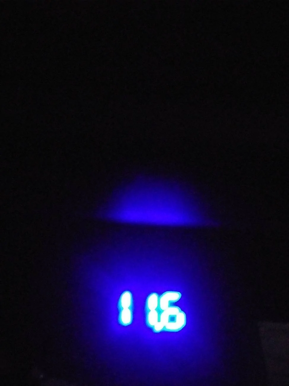

Use to get it . stopped using start/stop and improved . have 12 volt plug in monitor ( plugs into 12 volt socket and bought on Amazon about $10 ) and battery condition improved . Also recently had software battery charging recall done and it even improved even more . prior battery resting. Would go down to 11.6 volts now only goes down to 12.3 volts . charging rate is higher while driving/ idling now . owned truck since 10/21 and only just less than 9k miles . so far so good . Also have portable jump start in truck just in case .
