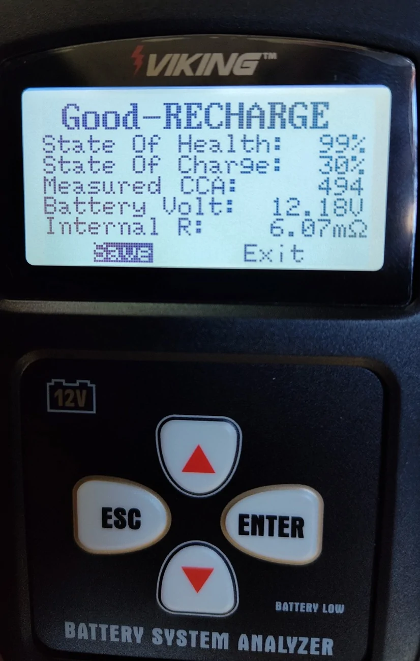

HeyBales
May 3, 2024
5,615
5,467
KC Metro area
Wow - living high on juice there at 12.25 V!
Even if that is inflated due to just driving or such - pretty good, in comparison.
I started a 4.5 hr drive with Ford's SOC scale 40% and 11.8 V.
Ended at 59% SOC, but couldn't stick around for a valid V reading.
BMS seemed to hold at 2A charging level for a lot longer than normal 10-15 min, maybe a whole 30 min, unheard of!
But then normal float charge less than 1A for probably 4 hrs.
Sadly my Forscan Lite took the 3 day break to decide to do a license check, and with nothing but wifi on this old phone, wasn't going to happen, no time to fool around with creating a hotspot and such with barely any cell signal - had to get moving as already hours late.
But after same 4.5 hr drive back, this morning after overnight sleep - Ford's SOC 66% & 12.2 V!
Wow. (only an avg 21 mA usage draw during sleep)
Did a battery test too with the below results, new battery in July, with 6 full recharges on trip to/from NY over 3 days (RAV4's 5yr old battery has better resistance still) :
