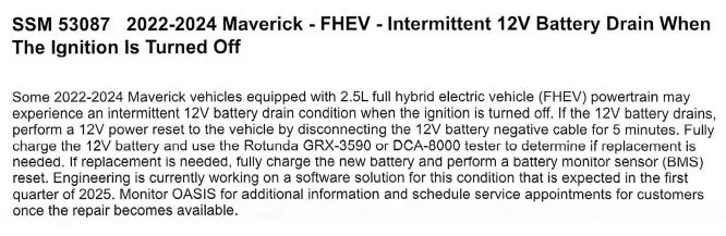

Went to the dealer with the Battery Saver problem today (since Christmas it's become more frequent). They did tests on the original battery...it failed the Rotunda test, and indicated replacement was needed.
New battery was installed, I believe it is the AGM type, 36 month replacement warranty (7 year pro-rated warranty).
They also provided me with a copy of SSM 53087, which Ford is claiming to have a fix sometime the first quarter of this year.
We'll see how things go from here.
I don't think they have an AGM battery replacement yet. I am sure it is the same stock number as the old one. Most likely will be OK for a while then do the same thing. Hopefully the software update will take care of this issue and let the alternator start more fully charging the battery.

That part number shows it is a regular FLA, not AGM, so hopefully it will hold up until the software fix comes in.

It won't work. It isn't "low power mode". It is reporting that your battery is unable to take a full charge anymore because of chronic undercharging due to the poorly designed charging circuit that ALL Mavericks have. There are people on here, myself included, that have driven 320 miles in one day only to have the vehicle notify that night that it is in deep sleep mode to prevent the battery from going any lower in voltage. This is not anything that additional driving will fix. Ford is claiming they will have a fix before the end of March. If this massive recall, that will happen, is anything like the very limited battery recall, they'll say the parts won't be available until the 3rd quarter of 2025. This problem has been around since the inception of the Maverick so it is inexcusable that this has taken so long. Sales must be taking priority over customer satisfaction and safety.
