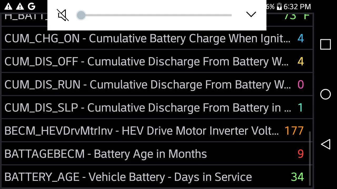

Resetting the BMS erases learned charge history/strategy, and makes it thoroughly sniff the battery behavior again. When used on a battery that's been in service for a while, it can help a bit. Similar to discharging a cell phone to zero and recharging to 100% on many phones recalibrates the "BMS".
I've done it once on the Mav, which seems to have improved the long term charge state by a few tenths, the BMS manages the battery.
"new" batteries are installed with a variety of charge states depending on their age, temp of transport and storage and of course the exact capacity, CCA, etc of the new battery (it may not be a factory equal replacement).
It also resets the PID field for age of battery in days.
(ETA: It does not change the value in Battery Age in Months in the BECM, it does reset it in the Vehicle Battery Days in Service in the BCM. But my Months figure 9, does not match the date on the battery 48th wk/23, nor the date mfg 3/24 - but at least that is close, so perhaps it's 9 months since that module was turned on even though truck wasn't finished, considering the battery can be user swapped and BMS reset doesn't change that date - I'm doubtful it's used for anything)
That could be used in SOC % calculations, some system do use it. Since it is a field, can only guess Ford is using it too.
The comparison to cell phone is good - full recharge as you said, but not reset at unknown level thereby saying this is the new fully charged level.
A relearn overnight, with a fully charged battery, no BMS reset, also causes the SOC% to be reset in the morning from 2 tests I've done. There's your sniff the battery behavior again.
Which is probably good as temp changes, as SOC% changes with that too.
The manual doesn't indicate that relearn process needs any setup to tell it to do it, merely locked doors and no accessories on.
Of course it did the same after BMS reset and then overnight also, but it's evident that was the overnight aspect, not the reset process.
