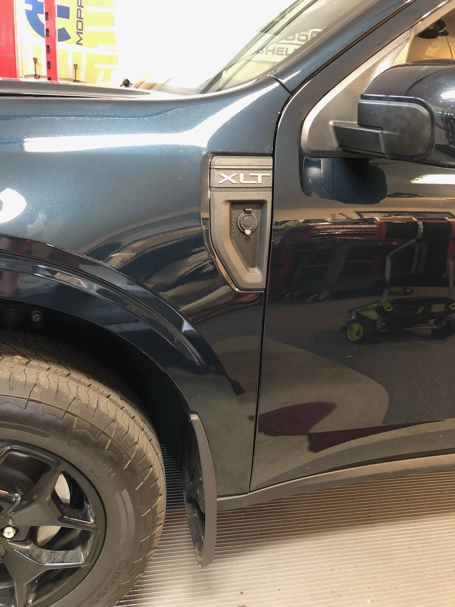

Battery Tender mounted on garage wall, Plugs in here. Marine-grade receptacle.

That's a great ideal putting that there.
The panel pops out easily, I recall there are (4) clips. I made a simple shielded, fused cable that runs to the threaded "+" post under the red cap and also to a chassis ground below it... No need to open the hood....
Do you have to push it from the inside? I didn't want to pry from the outside risk paint chipping.
I popped the panel out using a plastic trim removal tool over a small towel. No problems at all. If someone wants to "undo' the mod I recall the panel is about $45..
