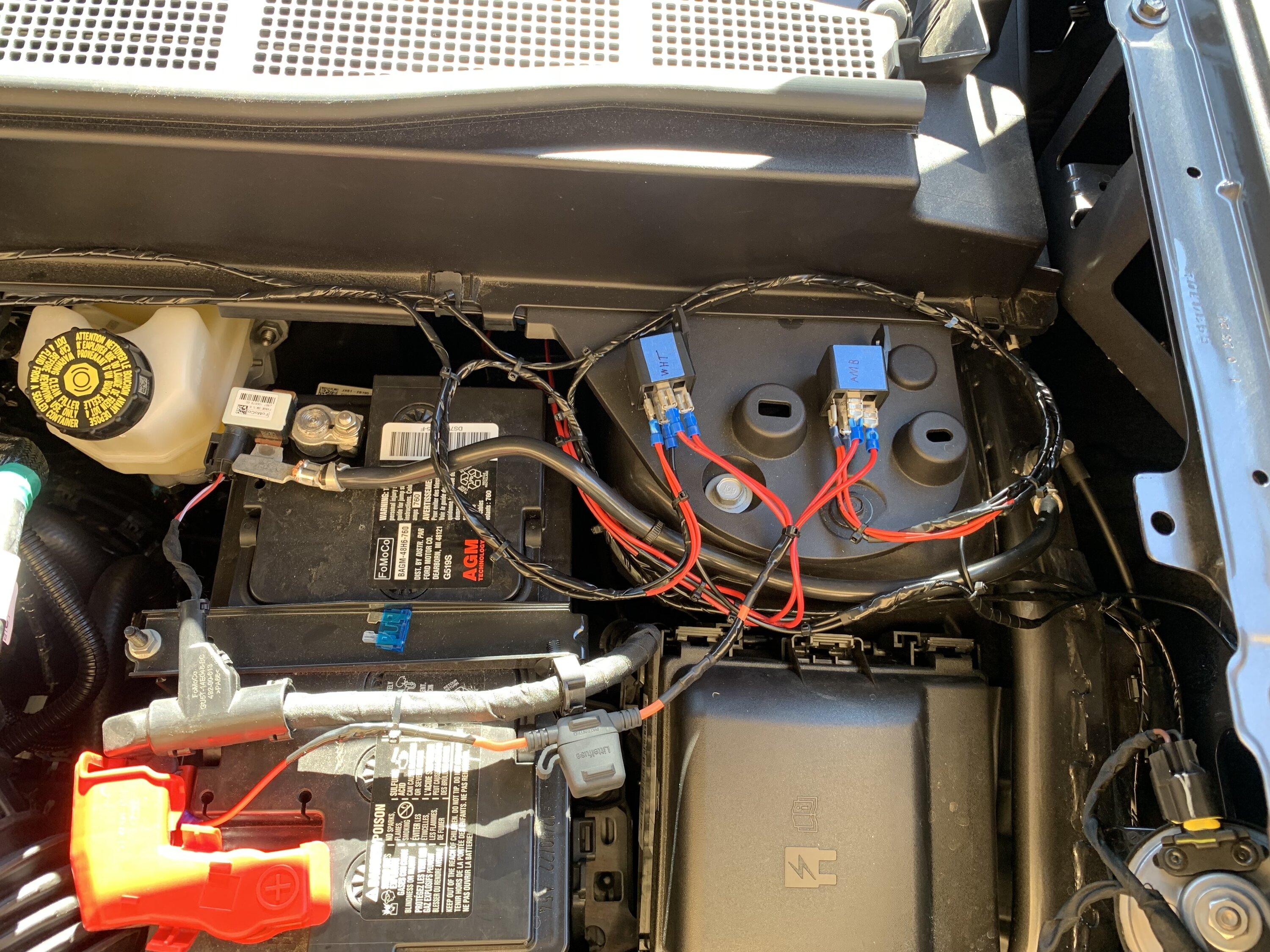

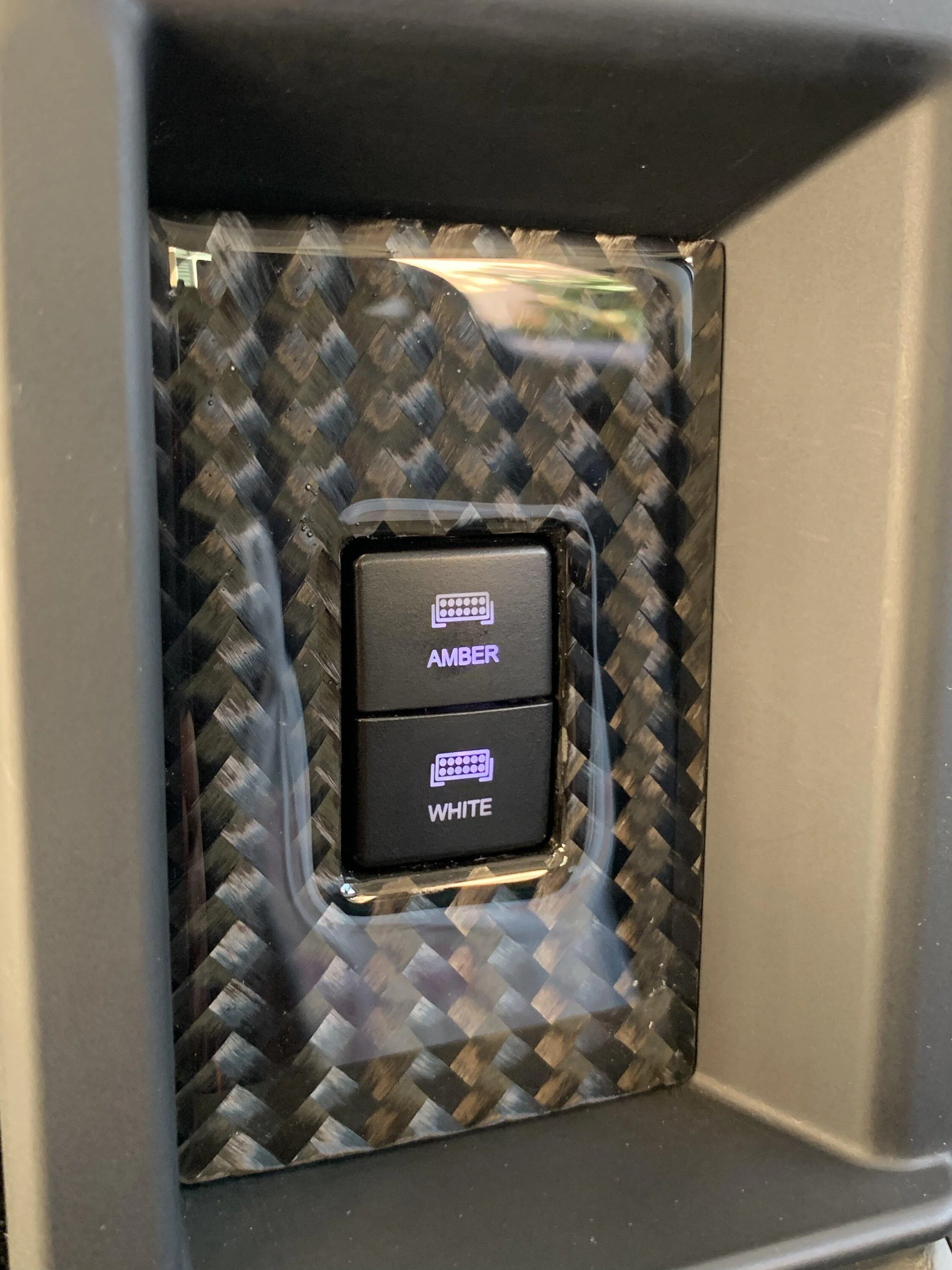

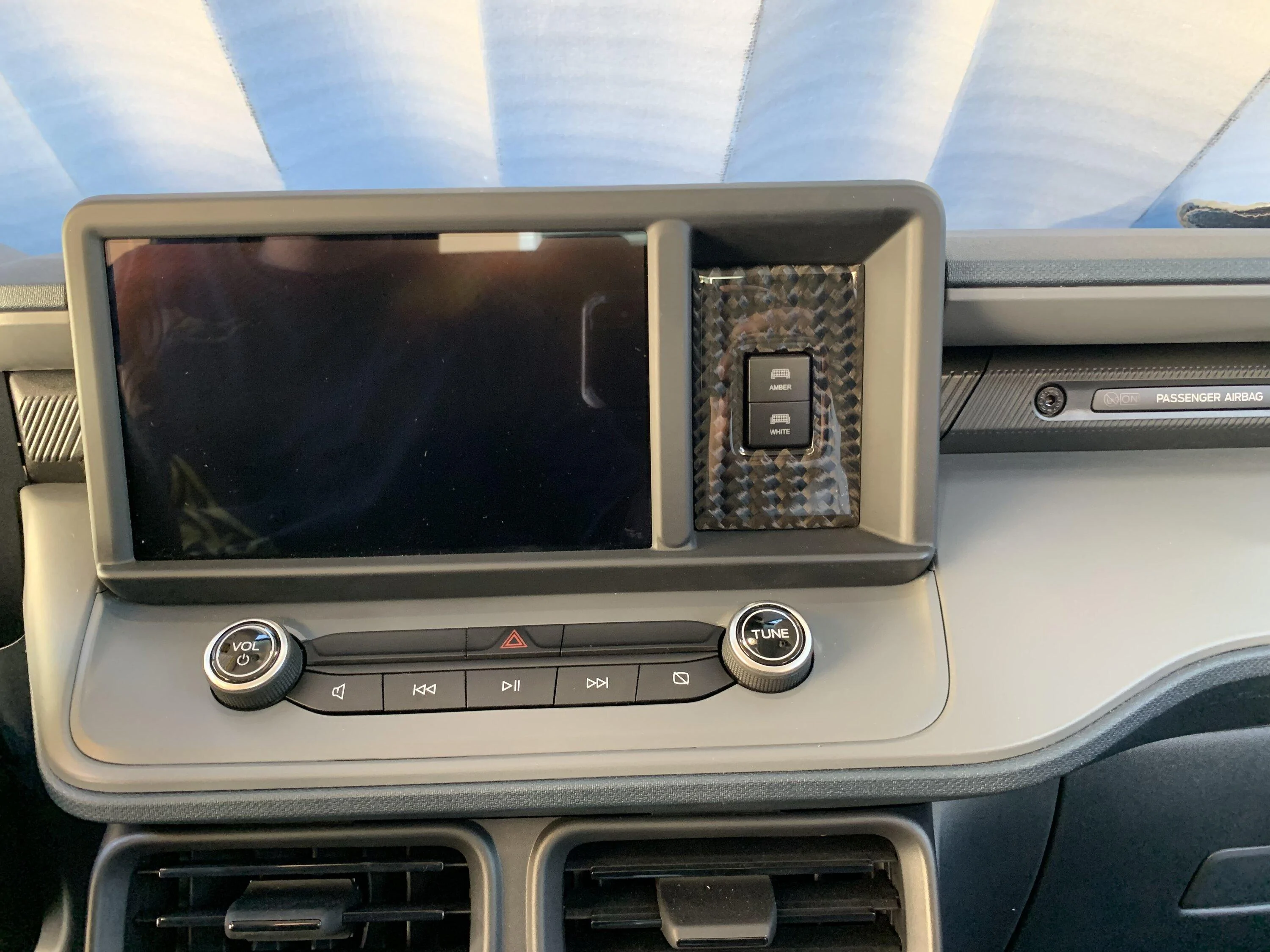

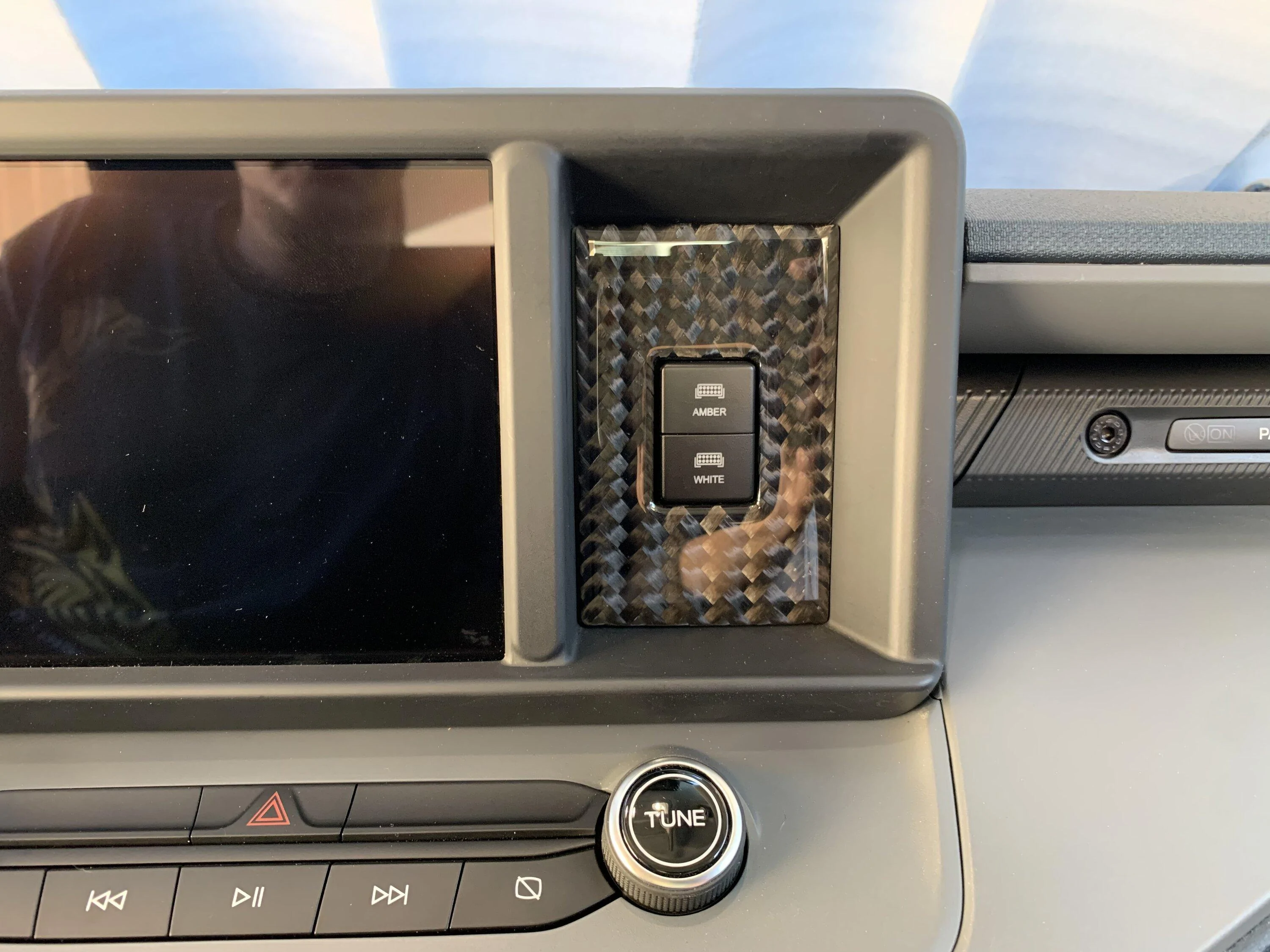

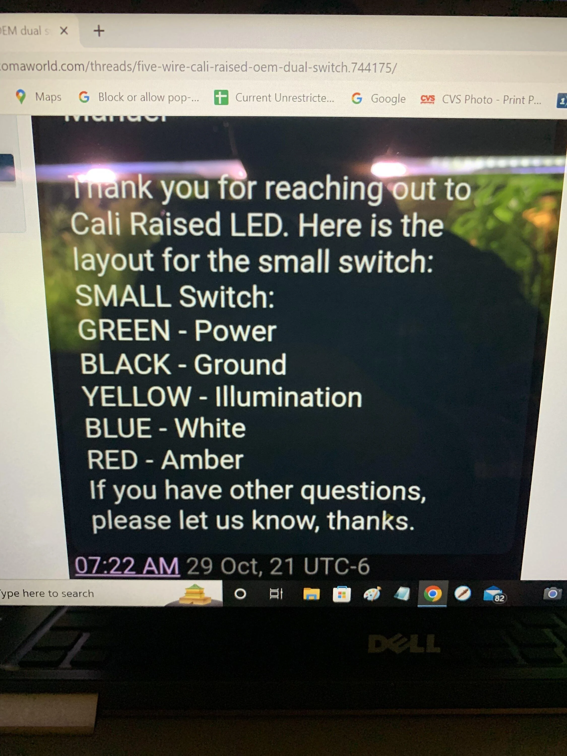

Finally got my switches done. I used a Cali raised dual light bar switch meant for Toyotas. The switch is only rated to 3 amps so I used relays. I had to remove the screen to get the wires into the cubby which was a bit unnerving but it’s not that hard. You have to pull on it pretty hard and I ended up breaking a few of the clips. Found a YouTube video by the channel Gear Experiments which shows how to do this. I ran the wires in through the grommet on the drivers side firewall, under the center console, up behind the glove box and to the cubby. Removing the glove box makes this easier. I made the carbon fiber face plate and used epoxy resin meant for table tops as the top coat.

Ford Maverick Fog lights installed! 19369B25-9AB6-4D00-A90A-D1D65DCBBBF6
Ford Maverick Fog lights installed! 910A4DE3-7D22-40DC-B2E4-21B9A02744BE
Ford Maverick Fog lights installed! 09B80CD1-FDF1-466F-B3F2-8907812B18E8
switch wiring
Ford Maverick Fog lights installed! CDBA83F9-C18A-47AD-99EF-5BC778DFE6C7
Relays
Ford Maverick Fog lights installed! 6268FBE7-9A48-4F80-BE11-57C7364206D0

Very slick! Super good look to your install. Thanks for not only pioneering this mod, but taking the time and effort to share your experience in such detail. Clearly, you're the Daniel Boone of Maverick modifications!
Thanks dad!
