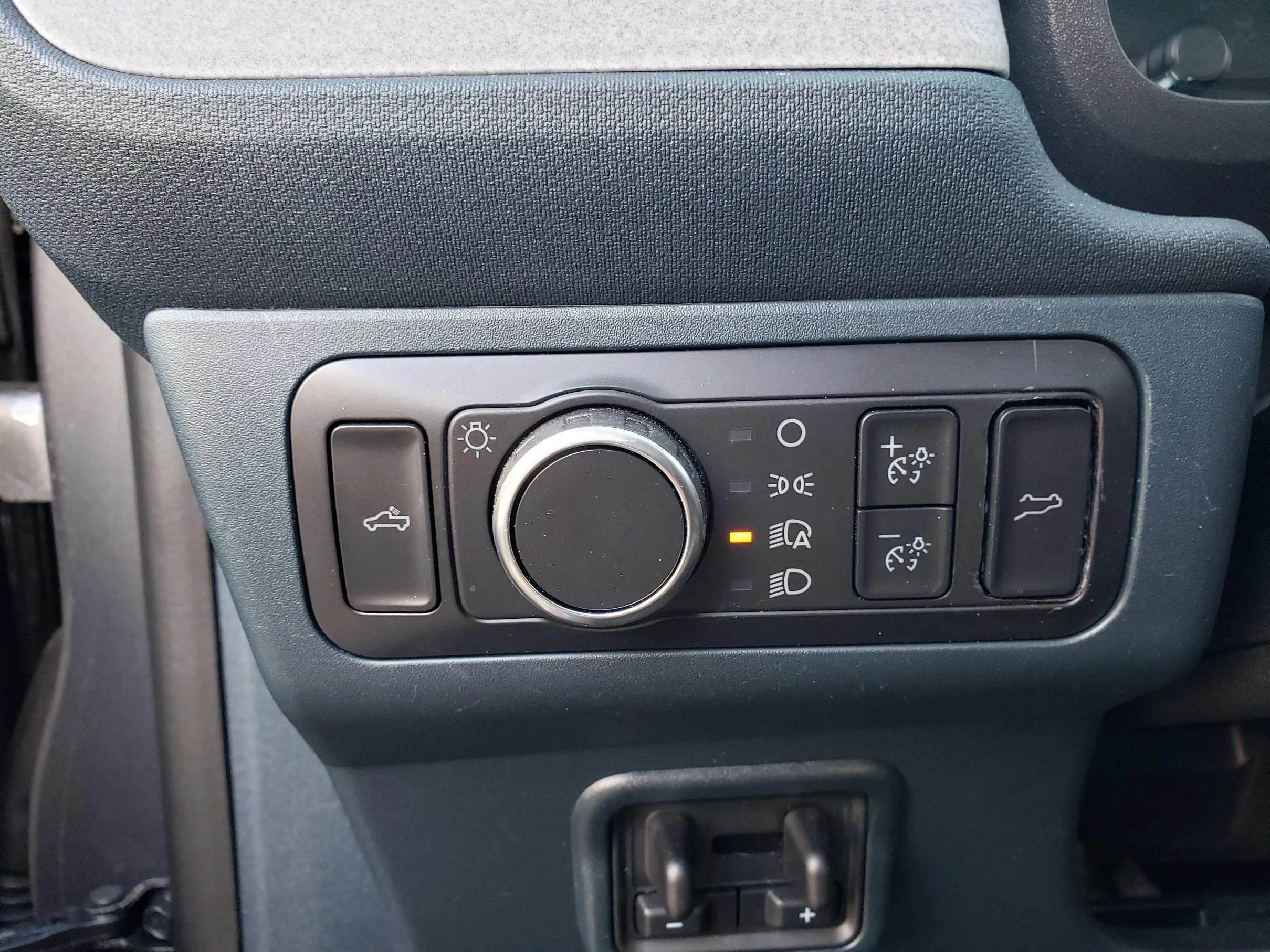

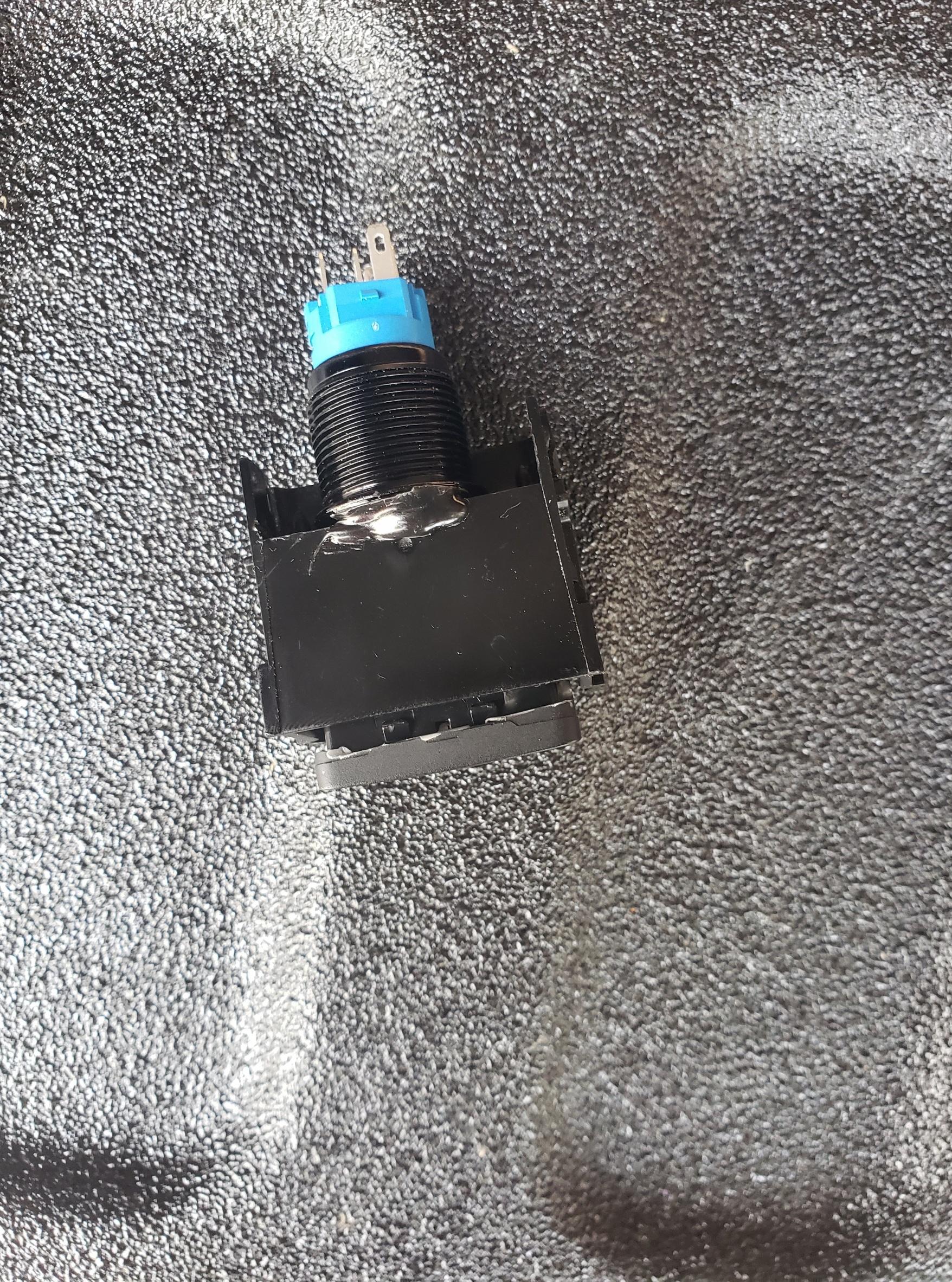

If you didn't see my other photo his is what I did to the instrument switch
Nice.
I was wonder if one could get a switch from an Escape (or Bronco Sport) that has fogs. The center of the dial presses. Just not sure if that is a separate connection, like what you did.
Mavguy
Feb 22, 2022
Northwest
My wire harness was just long enough. I bought the switch off the Ford escape with the fog in the center but found out it needs forscan to make it work. That is if its even in the software. I dont have access to it so right now it's an extra switch to the right.

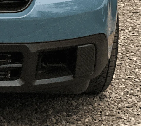

Would there be room for a set if you had tow hooks?
1 on each side you can. I forget what thread in here but someone posted a pic of a fx4 with fog lights next to the tow hooks

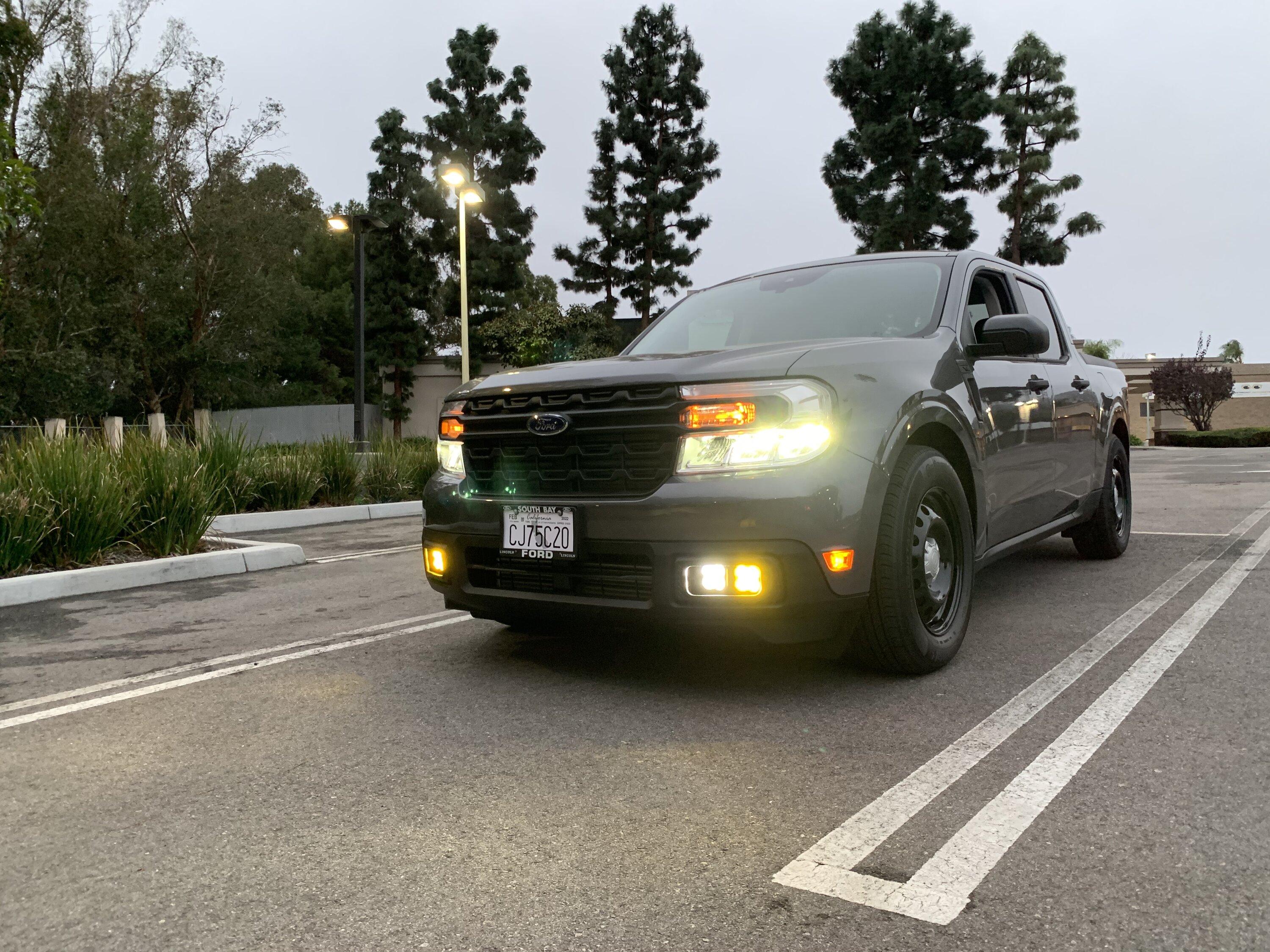

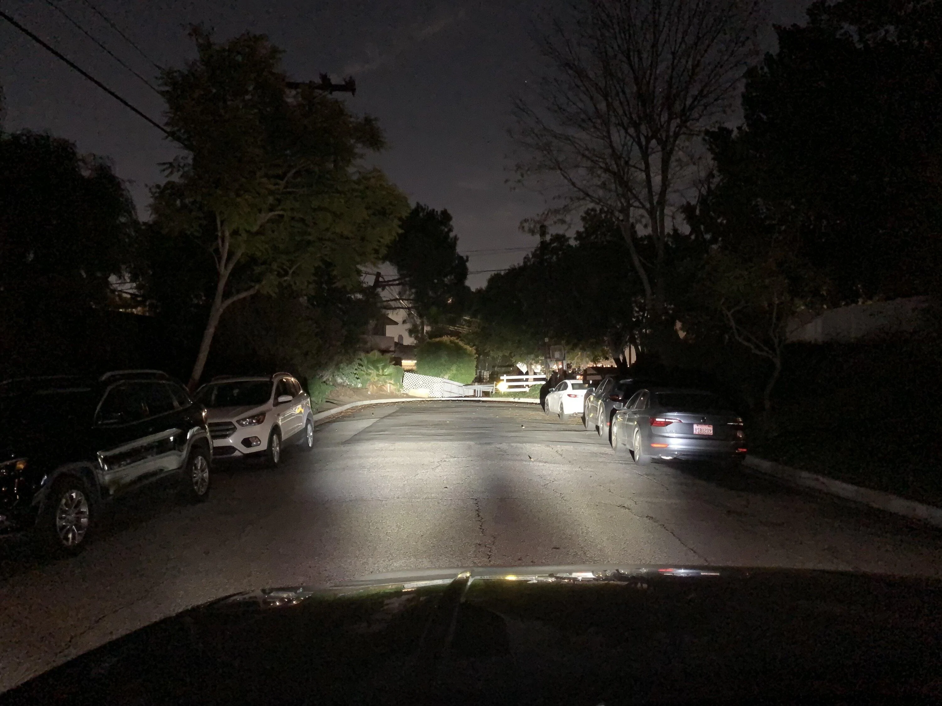

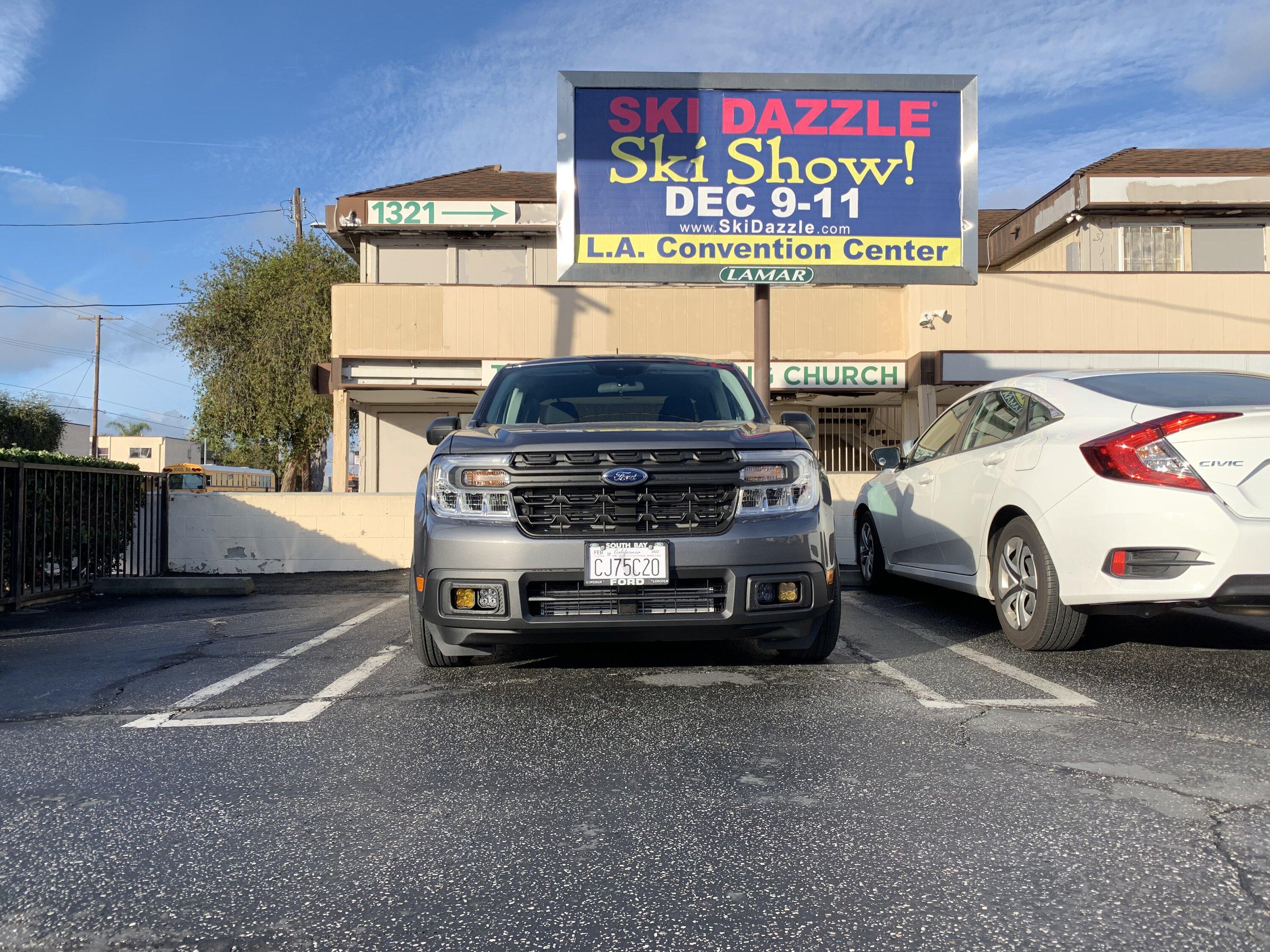

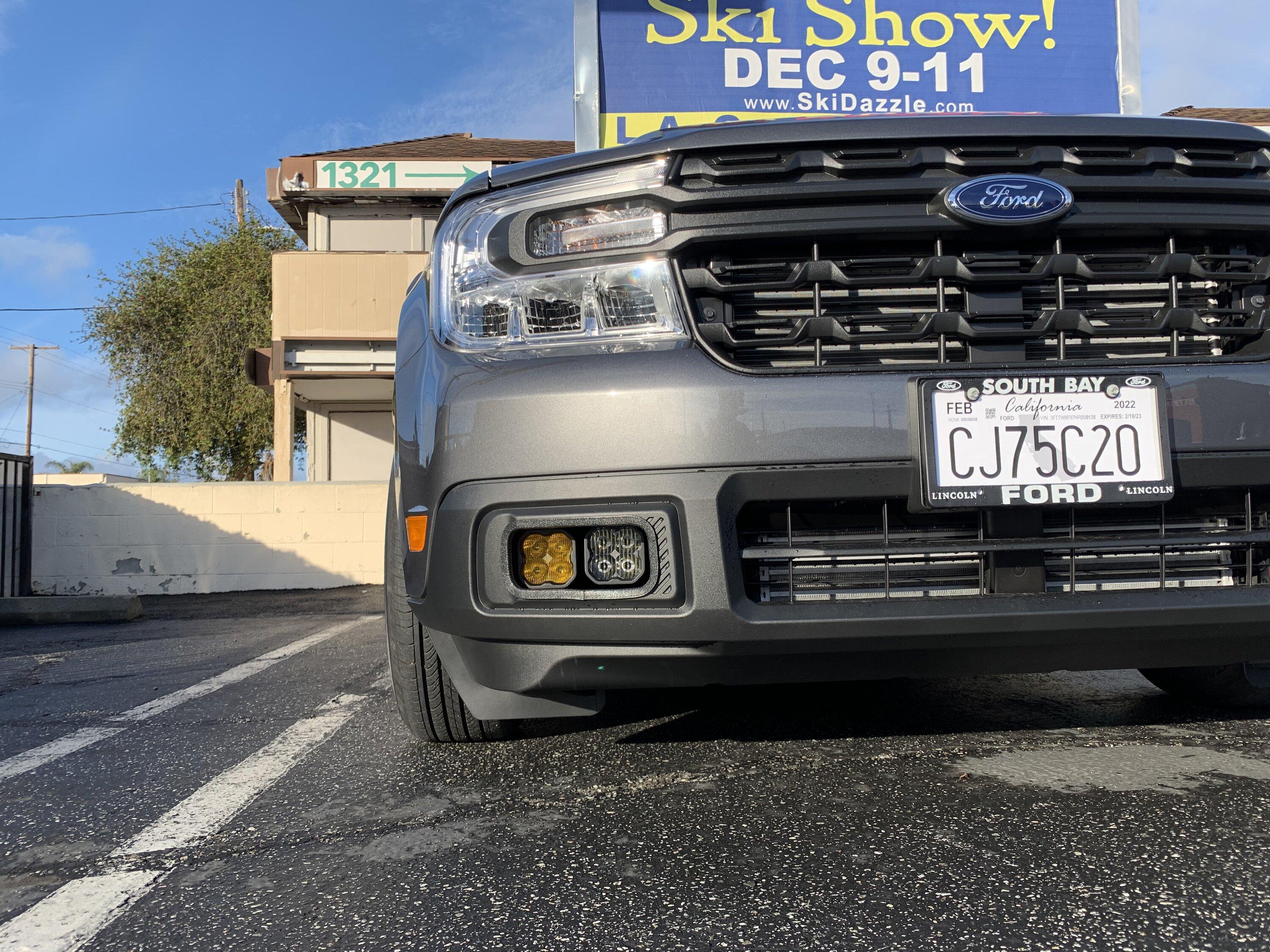

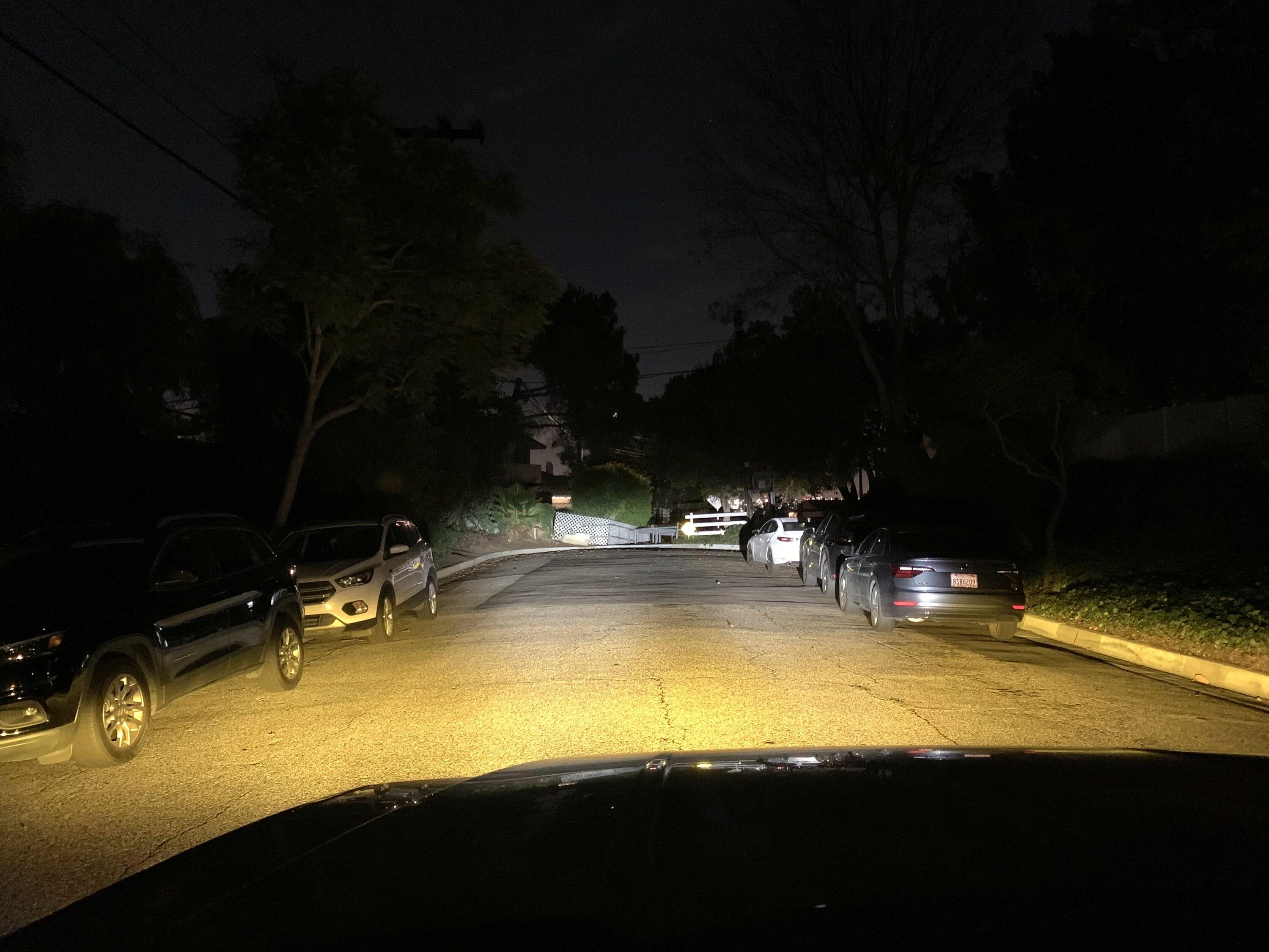

Saw a few threads on here inquiring about fog lights so I thought I’d share mine. I installed diode dynamics fog lights and driving lights this past weekend using jjc mounts. The lights are ss3 sport SAE approved fog lights and driving lights. I opted to not remove the entire cutout on the bumper, and only cut what was necessary to clear the lights. The yellow lights are a wide pattern with a sharp cutoff meant to light up the sides of the road close to the truck. White driving lights are meant to supplement your high beams.
Fog lights only
Fog lights and headlights
Fog lights and high beams
Fogs, high beams, and driving lights
Fogs and driving lights
Driving lights only
There is a blank on either sideof hooks, about 4" wide and 5 1/2" tall.
