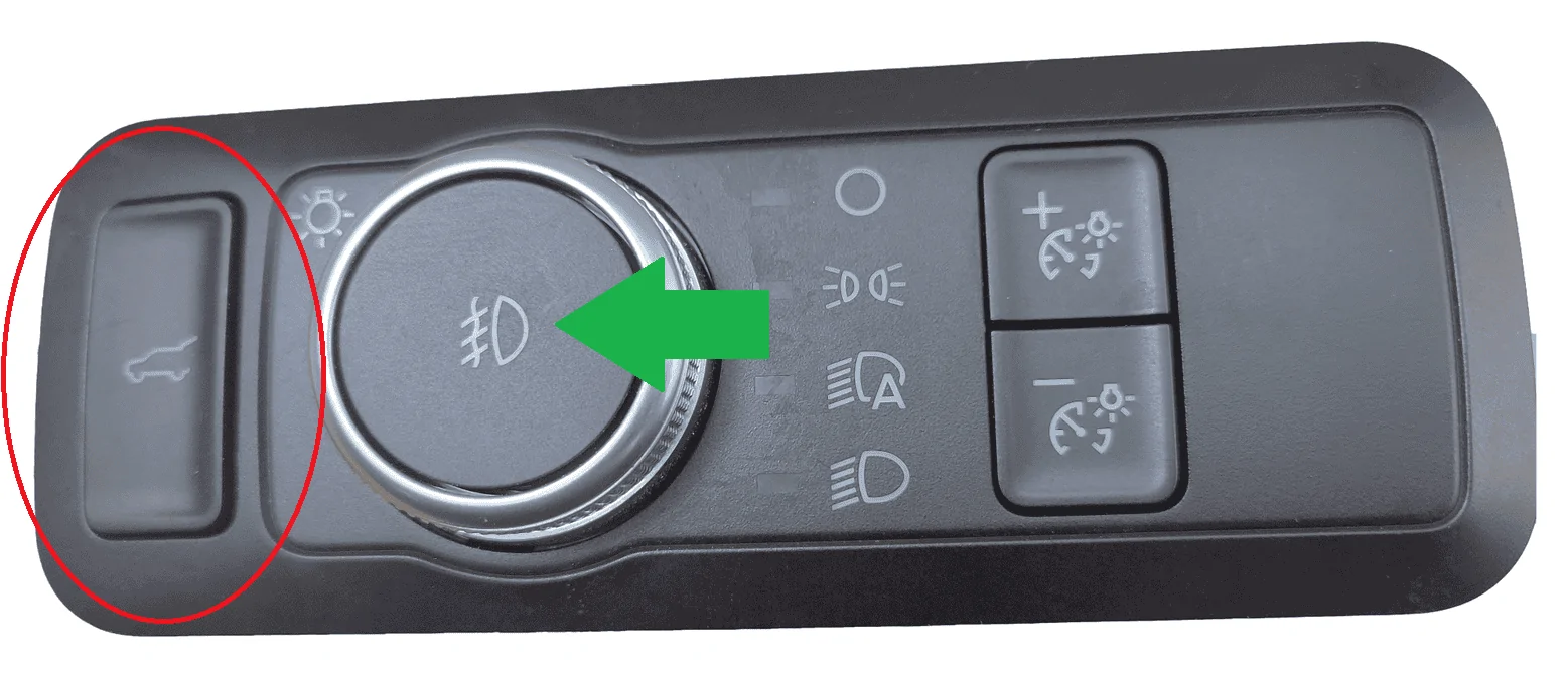

Edit: Nevermind, thought it was just a fog switch but it's a dual control switch. This might be a good option for those looking to add just fog lights with a factory look
Why not just use a switch from an escape or Bronco sport and swap out the left most switch cover to match the bed light switch on the maverick panel?
Escape light control panel
This is the best option for sure if you only needed 1 additional switch. I’ll see if mine fit on the far right but they probably won’t so I’ll try to make something for the cubby by the screen that looks good
