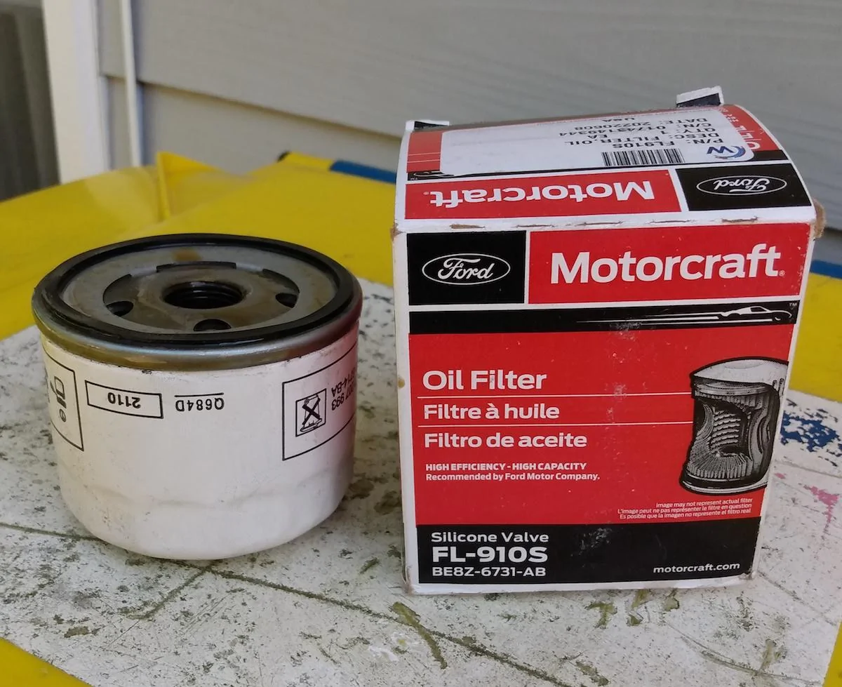

Don't know what's with the tiny original oil filter tho.

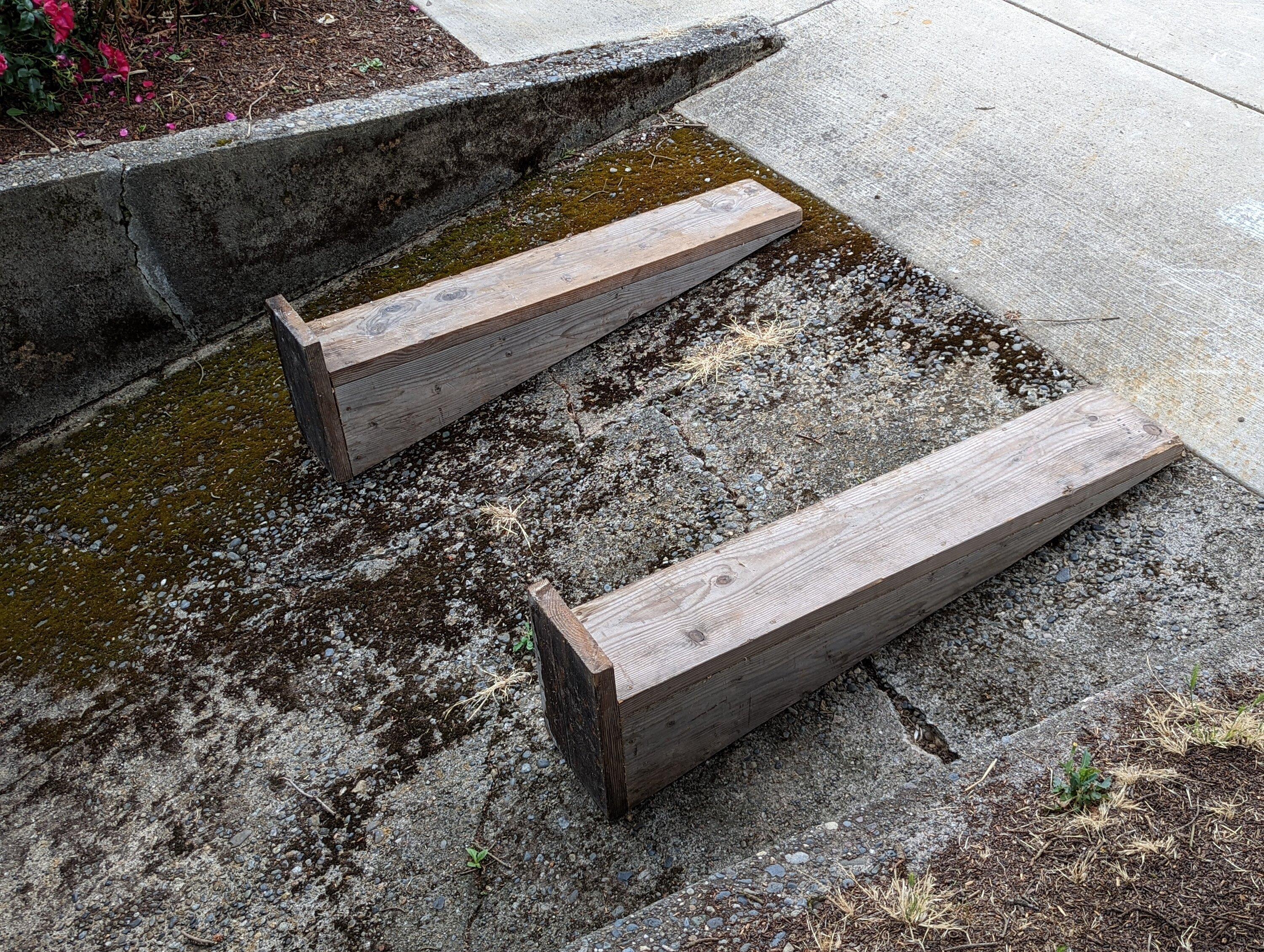

I'm a little late to the party but I thought I'd share a picture of my homebuilt ramps that match the slope of my basement garage driveway. I also have a little ramp thingie for the oil bucket to sit on.
As long as there is solid wood, not hollow, where the tire spot rests on the high part of the ramps, should be safe to crawl underneath. I like to back up whatever I'm using by a couple of jack stands or something solid under the jack points in case the ramps give way. Safety.

lol....I've never seen anyone draw a face on their oil filter before. :unsure:
I know I'm skipping 6 pages of discussion- marking your filter (or other items in the car) makes sure that when a shop does it next time, you know they actually replaced it by looking if your marking is gone....

Wood can hold a metric f-ton of weight.
Never fails to amaze me when there's a tree vs. car battle and the car is all smashed and the tree is standing there with no damage like, "WHUT NOW?"
