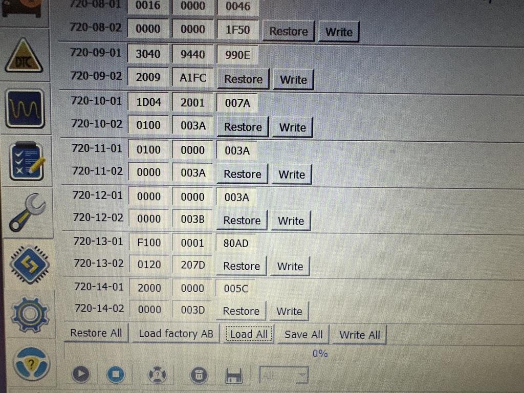

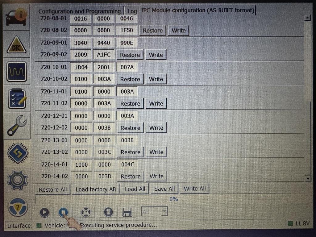

Thanks, I finally got rid of that annoying seatbelt screen. I have a '24 Lariat Tremor, I changed 720-13-01 and 720-13-02 to all zeros, when I saved it the last set of numbers changed from 80AD and 207D to 003B and 003C. It also changed 720-14-01 from 2000 0000 005C to 1000 0000 004C and 720-14-02 remained the same.
Factory:
No seatbelt screen:
XLT TREMOR here and yep my checksum numbers are the same as yours it all works fine.

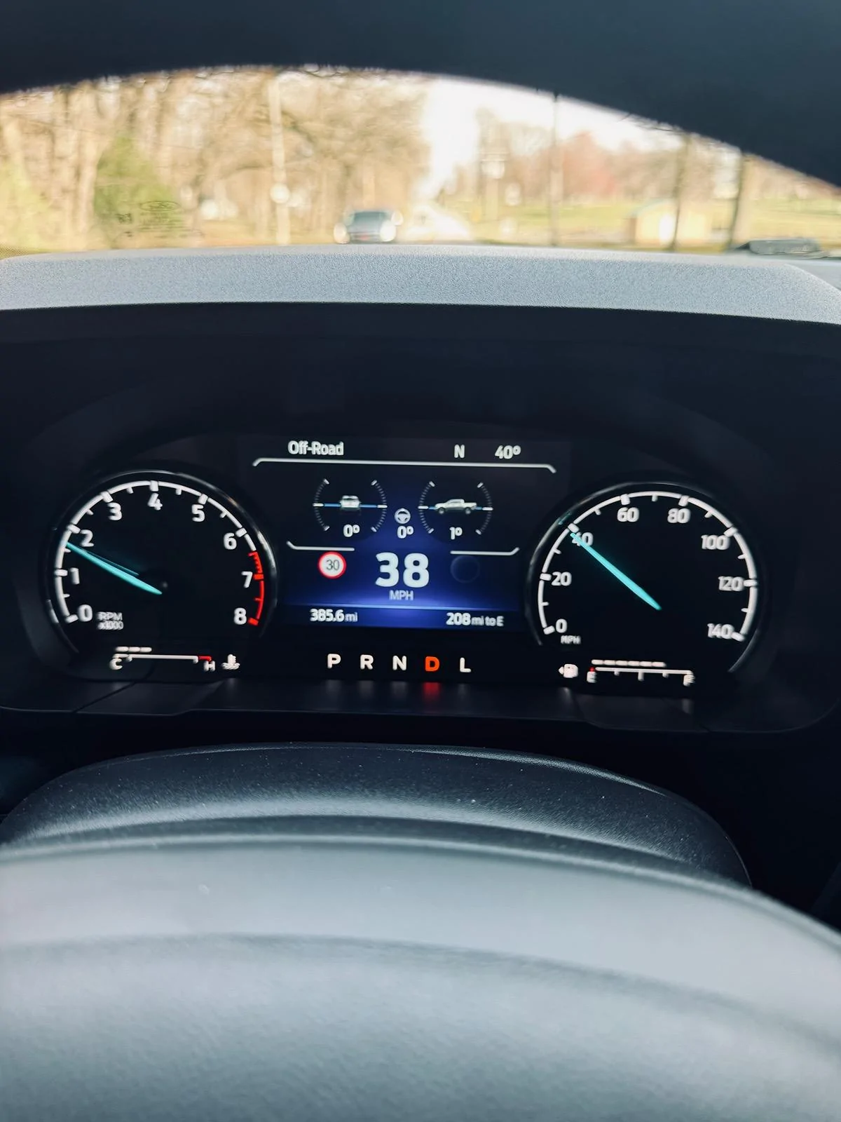

Oh any idea why the road sign recognition shows two? One works as it shows 30 and the other just stays blank any ideas why two are even needed? Here’s a quick photo notice on the right hand of the speedo it’s a blank circle.
@TheShark is 100% right. Check out @Toinky FORSCAN FOR DUMMIES thread. His Traffic Sign Recognition section helped me to get it working correctly!
