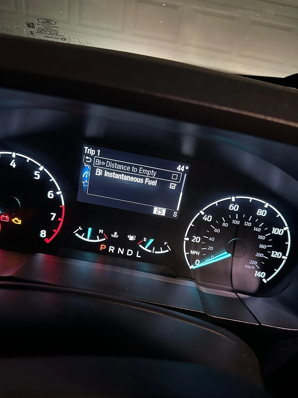

Well, it worked but I seem to have lost a feature. Instant MPG is now not available. I've tried everything possible to get it back but it appears to be permanently disabled. I'll have to revert back to defaults I guess.
Hey so I tested it and all of those trip menu settings work even instantaneous fuel. THE SEATBELT CODING HAS NO EFFECT ON THIS. The thing is that you can’t have more than 4 of these trip displays turned on at once!!

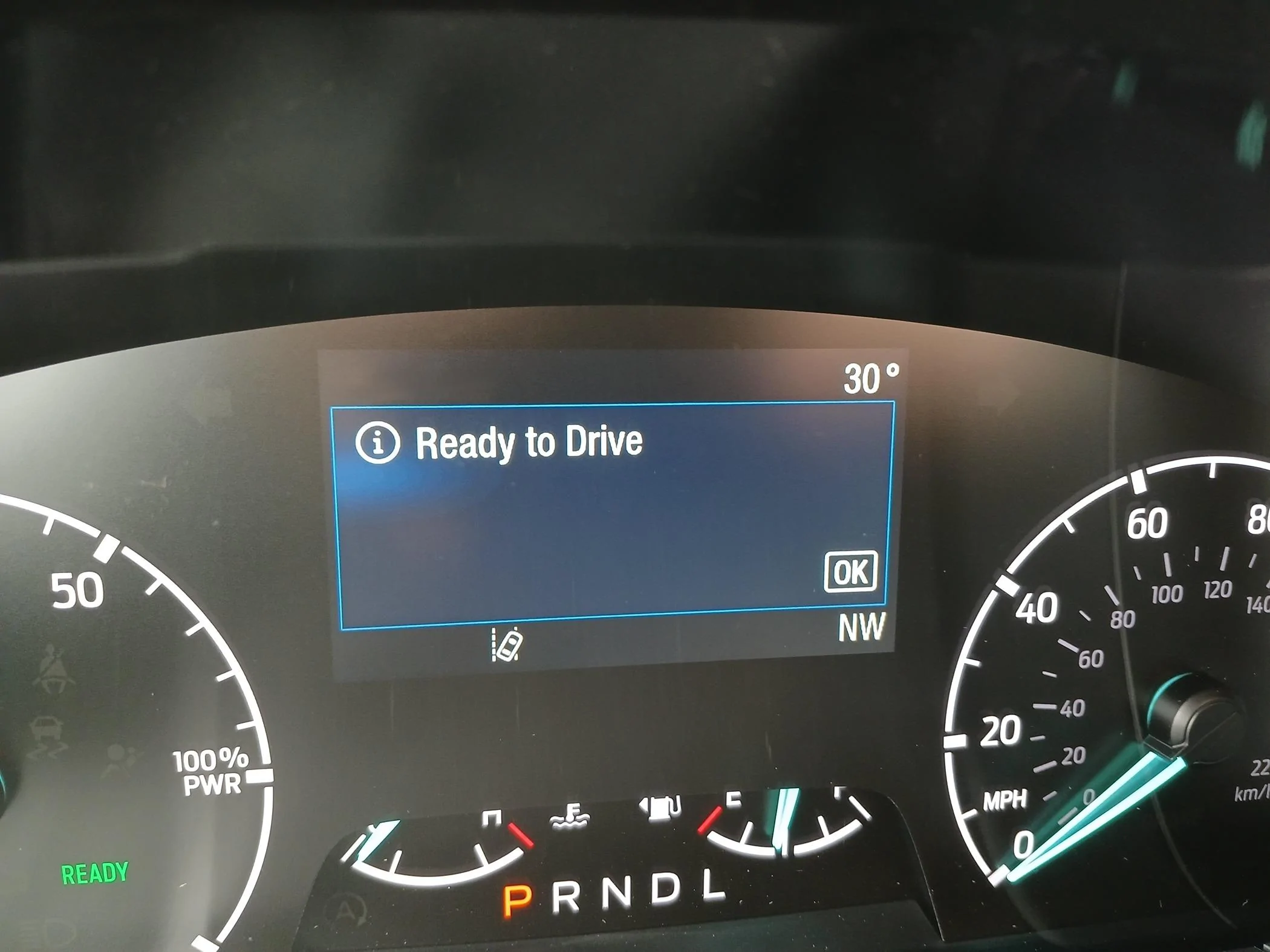

Yes! The "Ready to Drive" can get axed also if you'd like to keep up your momentum in figuring these things out.
I'm in the driver's seat. I'm the one that put in the key in the ignition and turned it. I know it's ready to drive, dammit! That green text that says READY on the left is more than sufficient.
I will look into removing the blue ready to drive info screen and keeping the green “ready” dash light. Looking into this for the HYBRID OWNERS OUT THERE!

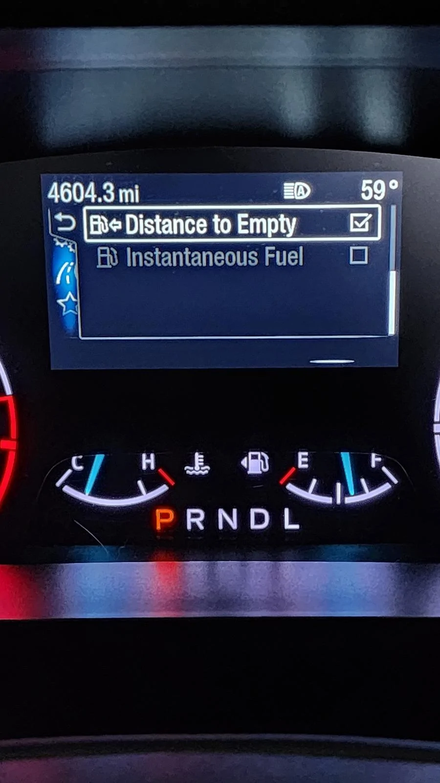

@EONR24 Hey looks like I was wrong, or at least jumped the gun. I think all the changes reset my IPC. Eco Coach feature was also gone but I found and reactivated it. The instant MPG came back after I disabled the trip timer. I didn't expect it to do that.
Thank you! My Ready to Drive screen looks the same, just larger due to the 6" screen. I imagine the configuration field would be the same. I see you have an EB so if you need someone to try the values or you want my asbuilt, let me know.

Worked great here also on a '23 Hybrid XL w/ CP360. Thanks @EONR24 !
Send me a picture of all of your IPC AS BUILT Codings when you get a chance. I will compare them to mine and the maverick spreadsheet to try to narrow down this ready to drive screen!
