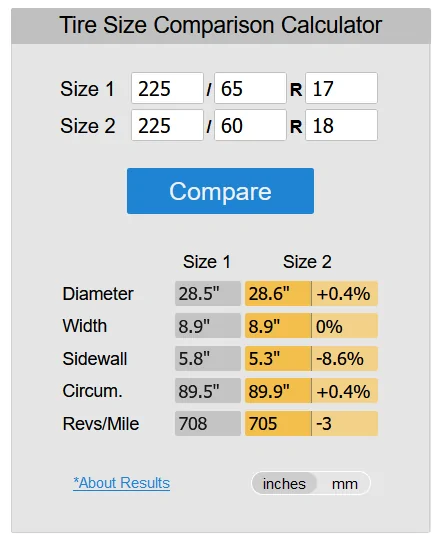

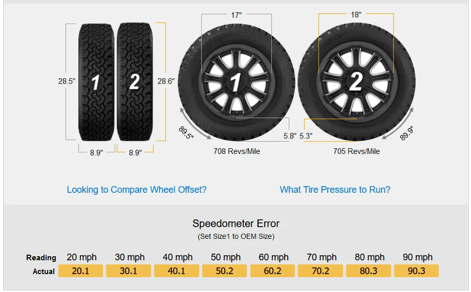

Comparison:
225/65R17 A/S [XL & XLT] vs. 225/60R18 A/S [Lariat or optional on FX4 Off Road Package] - posted below by @MAVRICK
Ford Maverick Factory Tires Sizes & Wheels Specs For 2022 Maverick: Width, Offset, Bolt Pattern, Center Bore, Thread Size, Weight 0xsb1emofvn71-png
Ford Maverick Factory Tires Sizes & Wheels Specs For 2022 Maverick: Width, Offset, Bolt Pattern, Center Bore, Thread Size, Weight 0eb6kxhxfvn71-png
