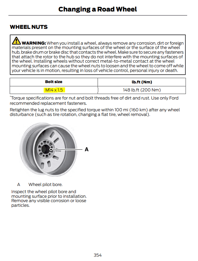

I'm pretty sure the bolt size is 14x1.5. Anyone out there to verify this! Tks Jim
