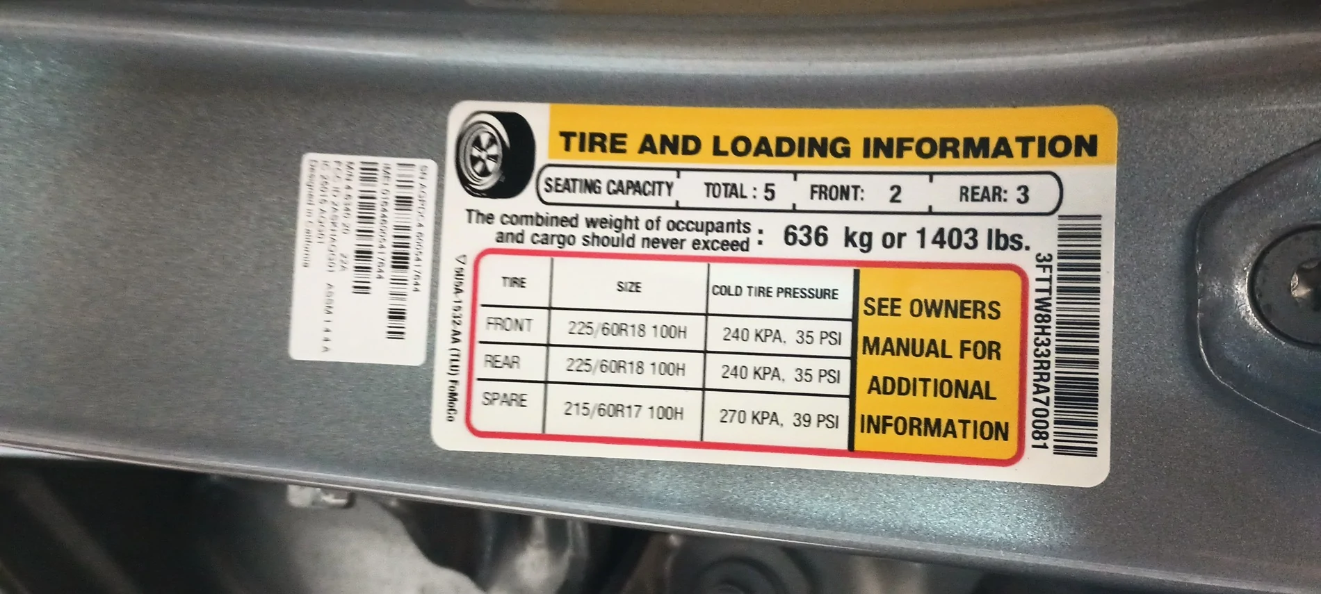

My 23-xlt-awd came with 245/60R/18. Every post I've noticed here are 17 inch are mine a freak of nature?
Gotcha'
The black appearance package on a 2024 XLT comes with 18" rims and 225/60 R18 I'm not sure about the 2023, but 245/60R18 is not a common factory tire size!

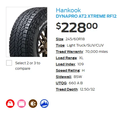

I just put 245/60R18 Hankook Dynapro AT2 on Tricky Ricky last Saturday. I think 245/60R18 fills out the wheel wells the best.
I found this size by accident. I pulled a set of snow tires from the work scrap tire pile during summer that still had 3/4 of the tread life left. I put them on last winter (2024) and instantly fell in love with the look. Decided to stick with that size when the winter tires went "bald" a few weeks ago.
